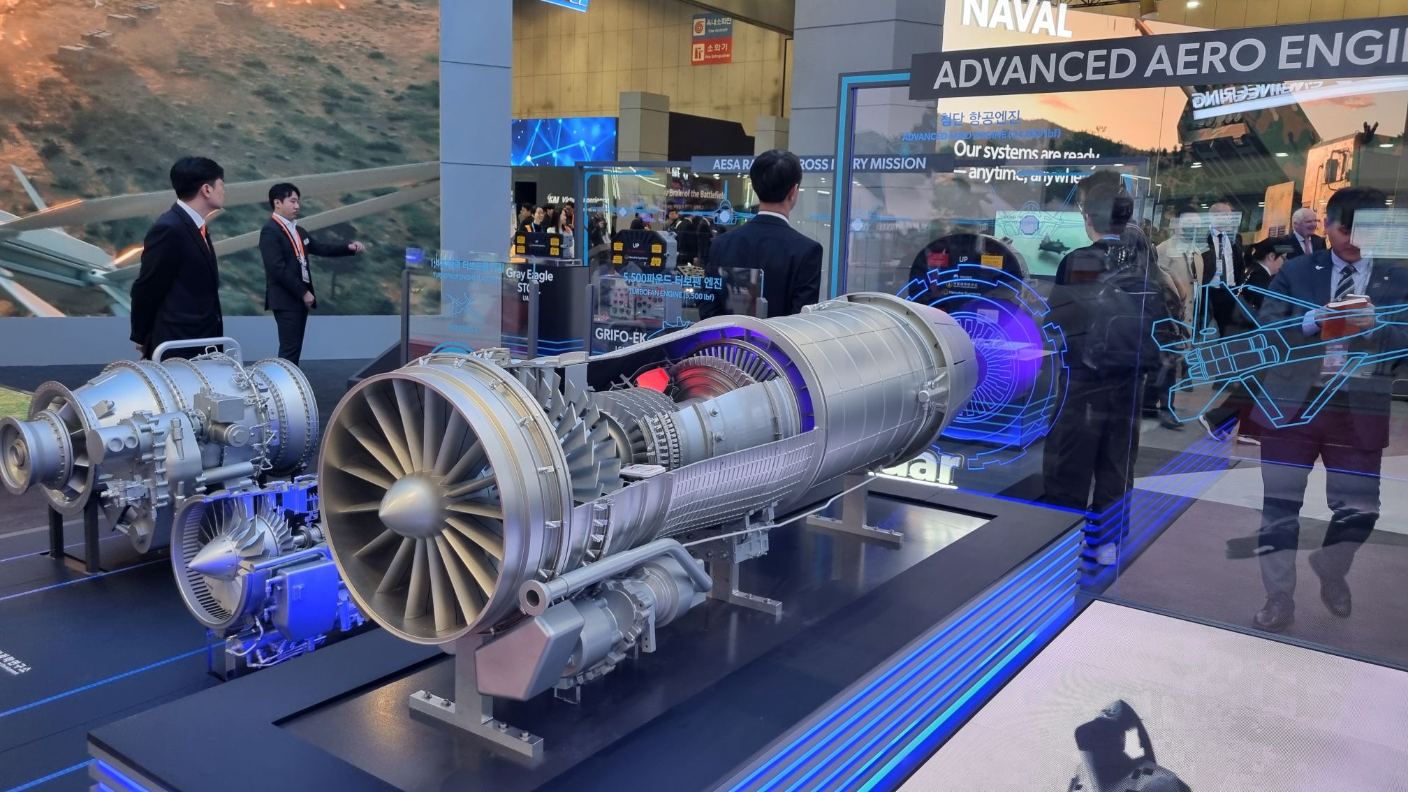

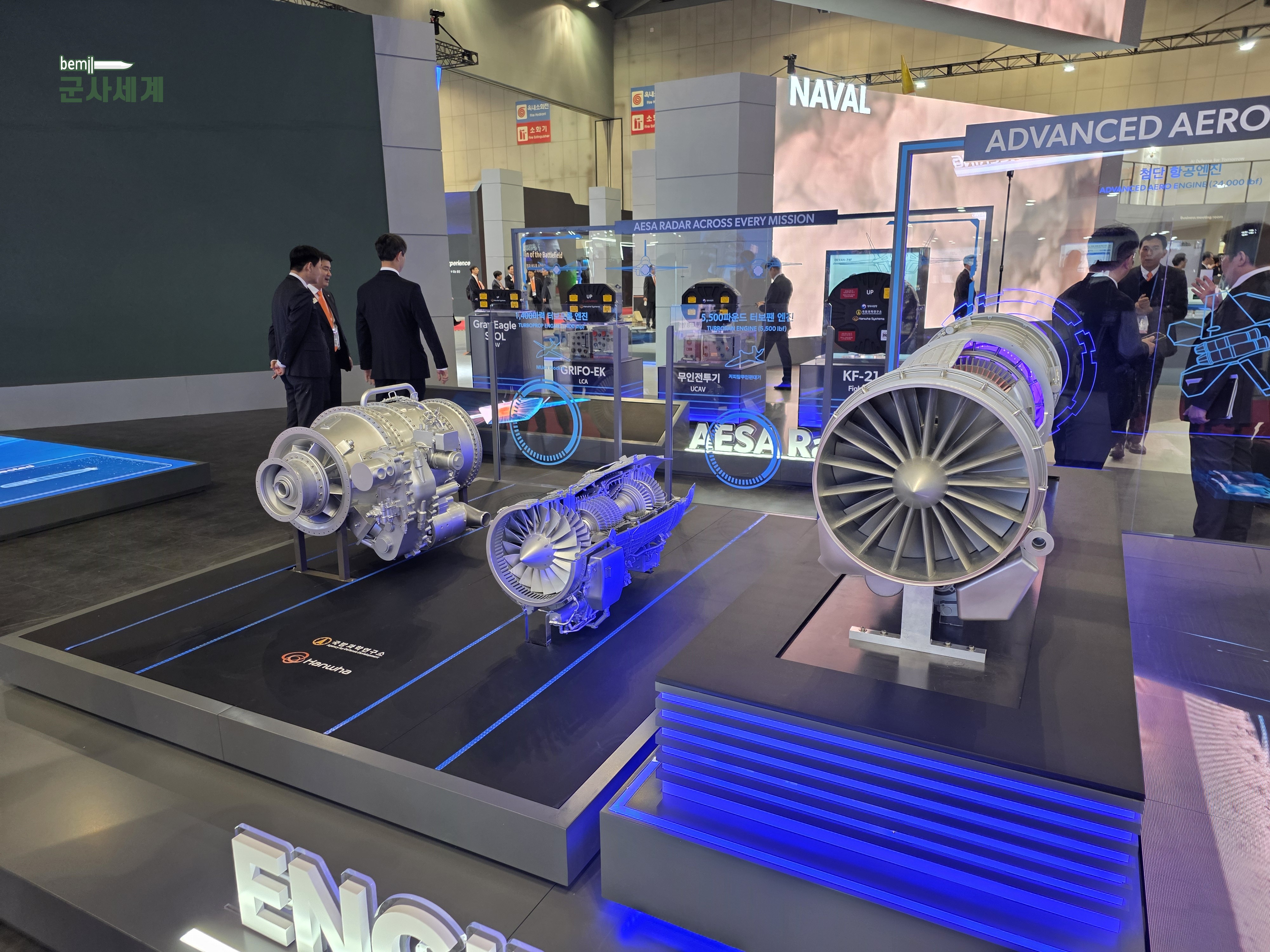

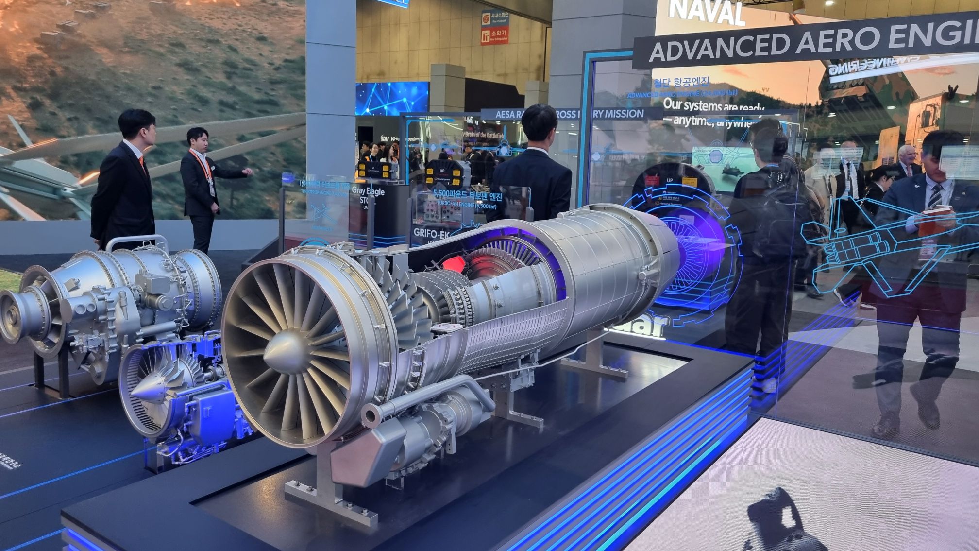

Doosan Enerbility capabilities and straegies for aero engine development
Doosan has already made significant achievements in the field of gas turbines for power generation and that it has faithfully equipped related testing facilities. Of course, Doosan fully recognized the difference between aviation gas turbines and power generation gas turbines and said it would use its experience for development.
Currently, the license-produced F-414 for KF-21 is said to have a localization rate of 39%. (based on mass production unit 1)
DAPA is thinking of a plan in which Hanwha and Doosan, and furthermore, Korean companies and university research institutes all participate, rather than a single company monopolizing it. This is because aviation engines require a one-team team for Korea to advance into this difficult and new field. In addition, there is a plan to include foreign companies, which will announce a detailed roadmap at the end of November.

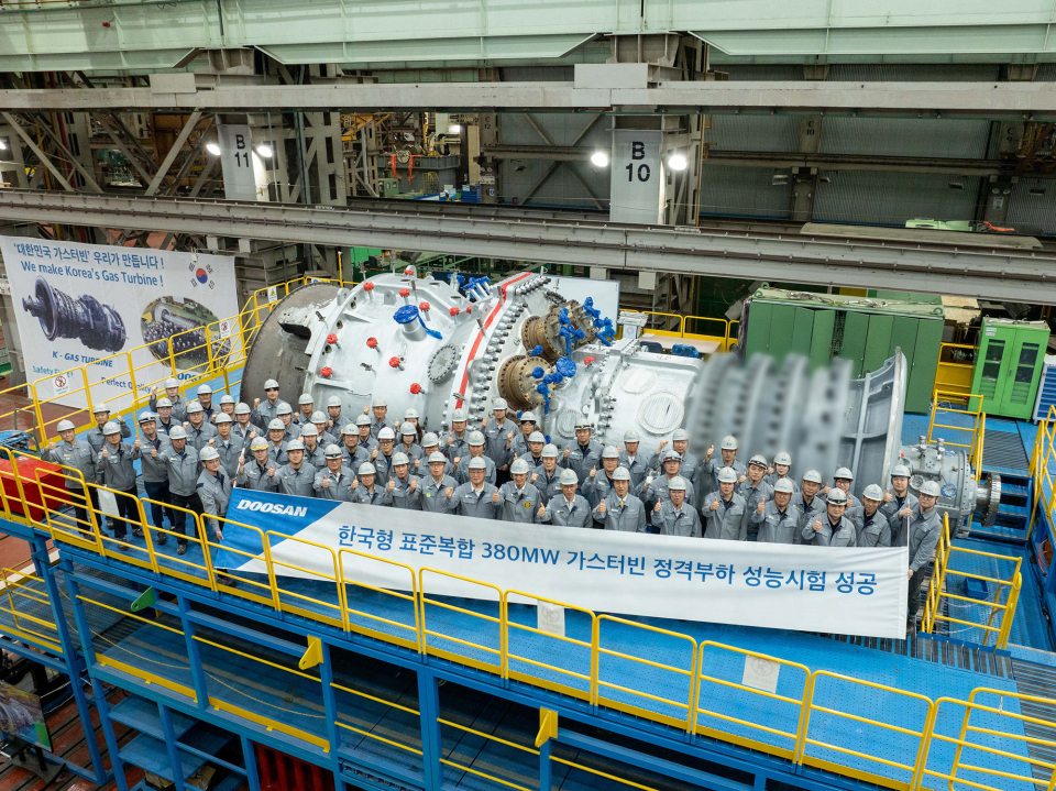

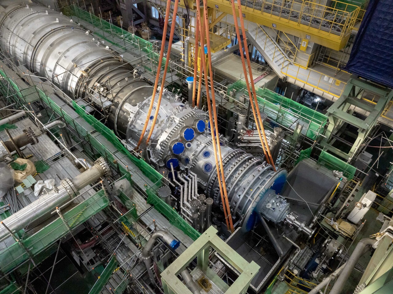

Doosan Enerbility Succeeds in Performance Test of 380MW Gas Turbine​
Doosan Enerbility has successfully completed performance testing of its independently developed 380MW gas turbine. The company plans to intensify its efforts to penetrate overseas export markets with this gas turbine, which also meets global environmental regulation standards.
Doosan Enerbility announced on June 5 that its 380MW gas turbine model has successfully passed the rated load performance test.
The rated load performance test is a final inspection process where the fully assembled gas turbine is operated at maximum speed and output under conditions identical to those in an actual power plant to verify its performance and stability.
This performance test was conducted over three months from February at the dedicated gas turbine test facility established at the company’s headquarters in Changwon, South Gyeongsang Province. Through the performance test, various operational indicators including output, efficiency, vibration, temperature, and exhaust gas were comprehensively examined. In particular, the test also included operational flexibility checks for power supply to data centers and rapid start-up tests to complement the intermittency of renewable energy generation.
The gas turbine that successfully passed this performance test is a 380MW model. This model boasts output and efficiency levels comparable to those of global leading companies. When operated in combined cycle, it can achieve an output of 570MW and an efficiency of 63%. As it also meets global environmental regulation standards, it is evaluated as a product capable of full-scale entry into overseas markets. Combined cycle power generation is a method that produces electricity twice by using high-temperature exhaust gas from the gas turbine to boil water, create steam, and then operate a steam turbine with this steam.
Jeong Yeon-in, vice chairman of Doosan Enerbility, stated, “The successful rated load performance test of this 380MW model has laid the foundation for full-scale competition in the global market. As a favorable atmosphere is rapidly forming in the gas turbine business recently, we will actively strive to strengthen Doosan’s gas turbine position in the global market.”

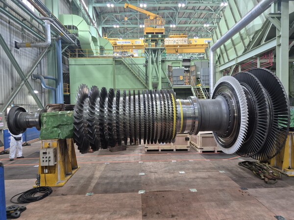

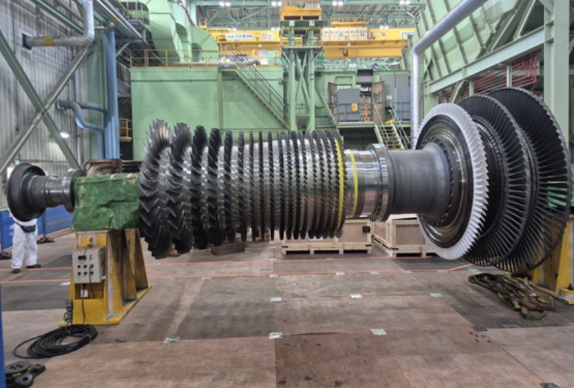

Korea Southern Power Co. started commercializing its core parts of the 7F gas turbine installed at the Busan Complex Power Plant on the 1st.
According to Southern Power on the 3rd, the core parts of the gas turbine installed this time are the first gas turbine rotors (rotation shafts) that Doosan Energy has refurbished using domestic technology for the first time in Korea and high-temperature domestic gas turbine parts researched and developed as a national project.
Since it is the first time for Southern Power to install and operate domestic core parts at the same time, the commissioning was carried out in accordance with the procedures carried out when constructing new complex power plants to ensure soundness. It also plans to continue commercial operation throughout the life cycle of parts and check long-term stability.

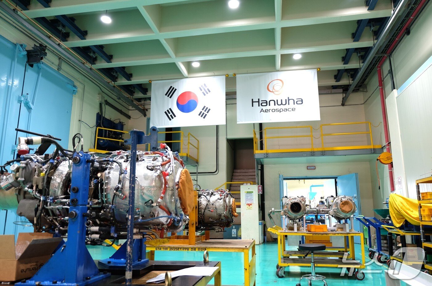

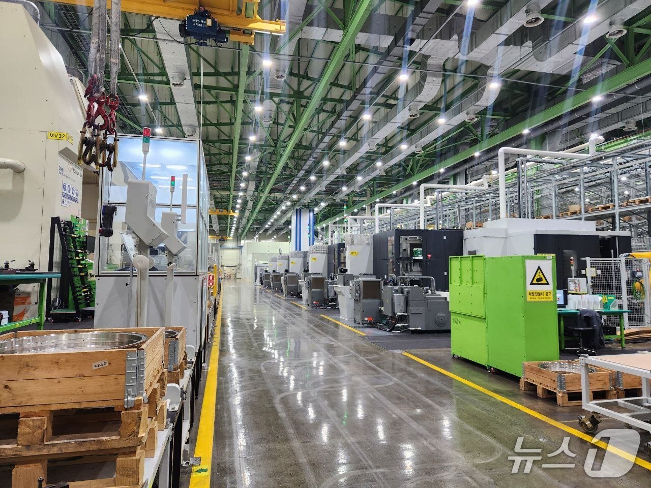

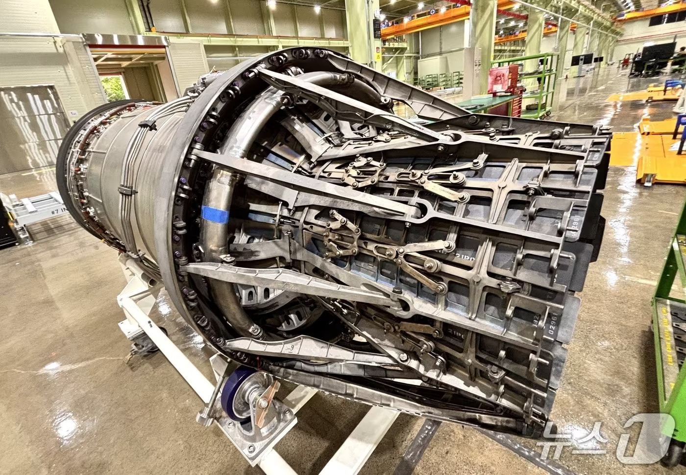

F-414, 404, T700-701K, etc., licensed for production at Hanwha Aerospace's Changwon Business Establishment 1.

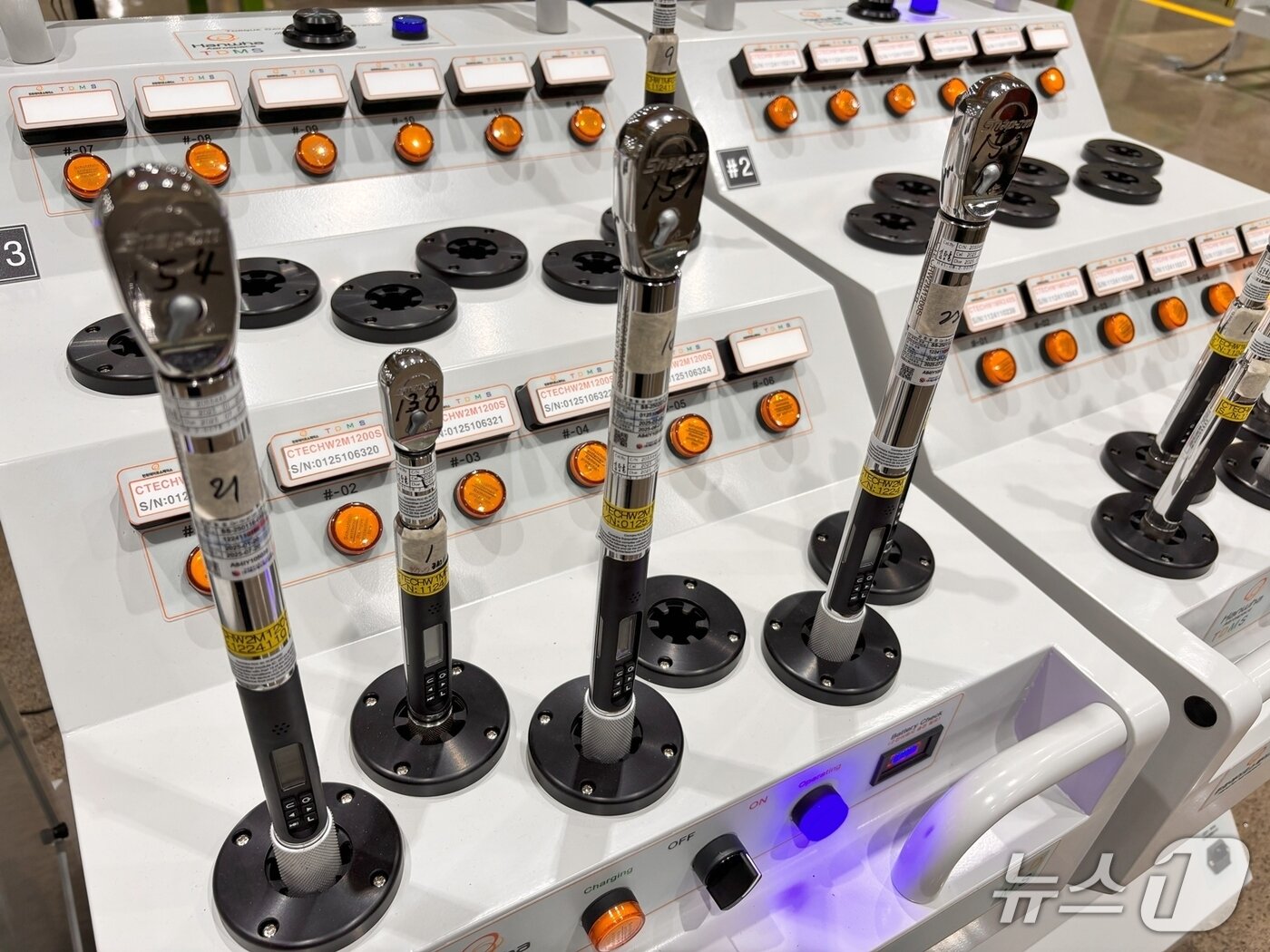

The Changwon Smart Factory, completed this April, spans 16,529 square meters and required an investment of 40 billion won. It has introduced IT-based quality control and logistics systems to prepare for future aircraft demand and the development of advanced aircraft engines.
The Torque Data Management System, designed by engineers themselves to numerically verify tightening strength when bolting, enables more precise work by quantifying measurements—moving beyond reliance on technicians' mere ‘skill level’.
Automated guided vehicles (AGVs) transported necessary materials and items from the warehouse to the equipment, where robotic arms loaded the parts into the machinery to manufacture them. Human workers only performed visual inspections when required.
Employees can monitor the process in real time. The factory operates 24 hours a day. Jo Woon-rae, Manager of the Engine Production Team at Hanwha Aerospace, expressed pride in the components produced by Hanwha Aerospace, stating, “There is a saying that ‘there is no commercial aircraft currently in operation that does not have a Hanwha Aerospace component.’”

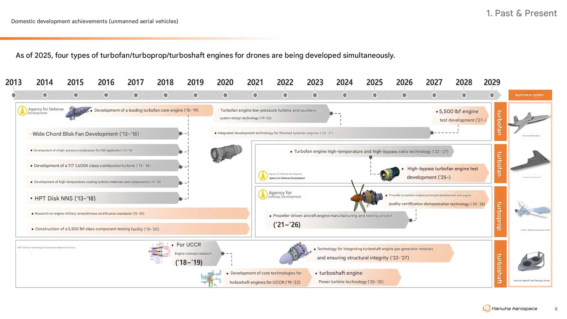

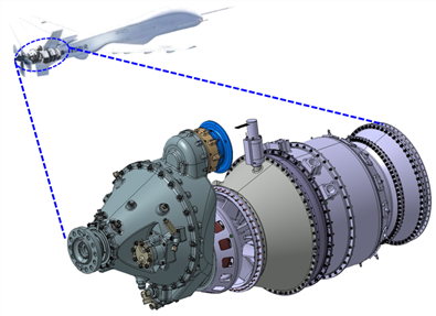

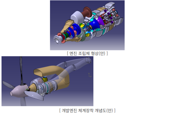

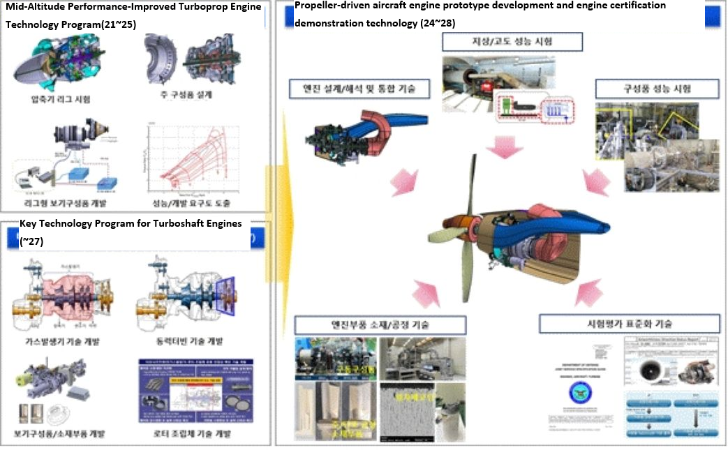

South Korea's Turboprop Engine Development Plan. Through the two preceding programs, the final turboprop engine prototype for the MUAV was developed.
Engine configuration
The program to develop the prototype turboprop engine was completed by the end of this year, so the actual engine should be ready. At this year's ADEX, only a mockup was displayed.

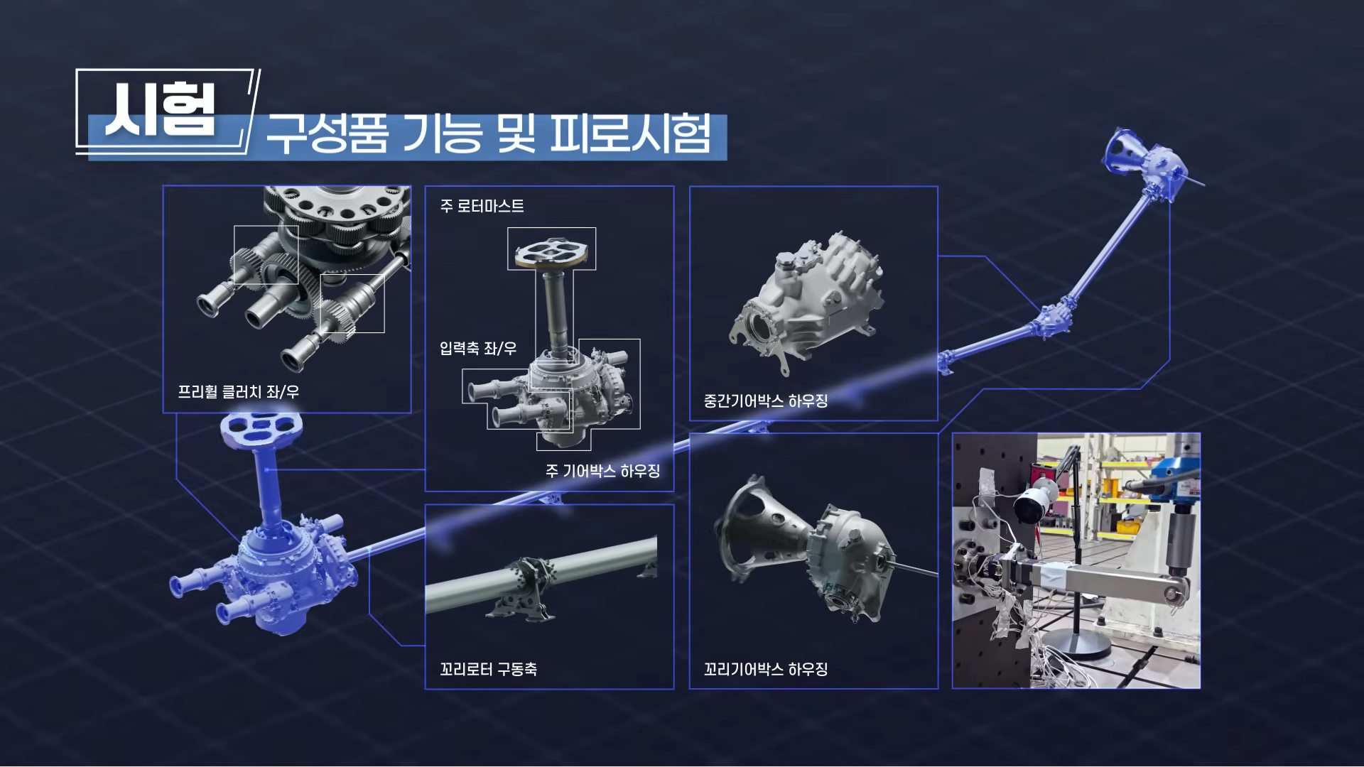

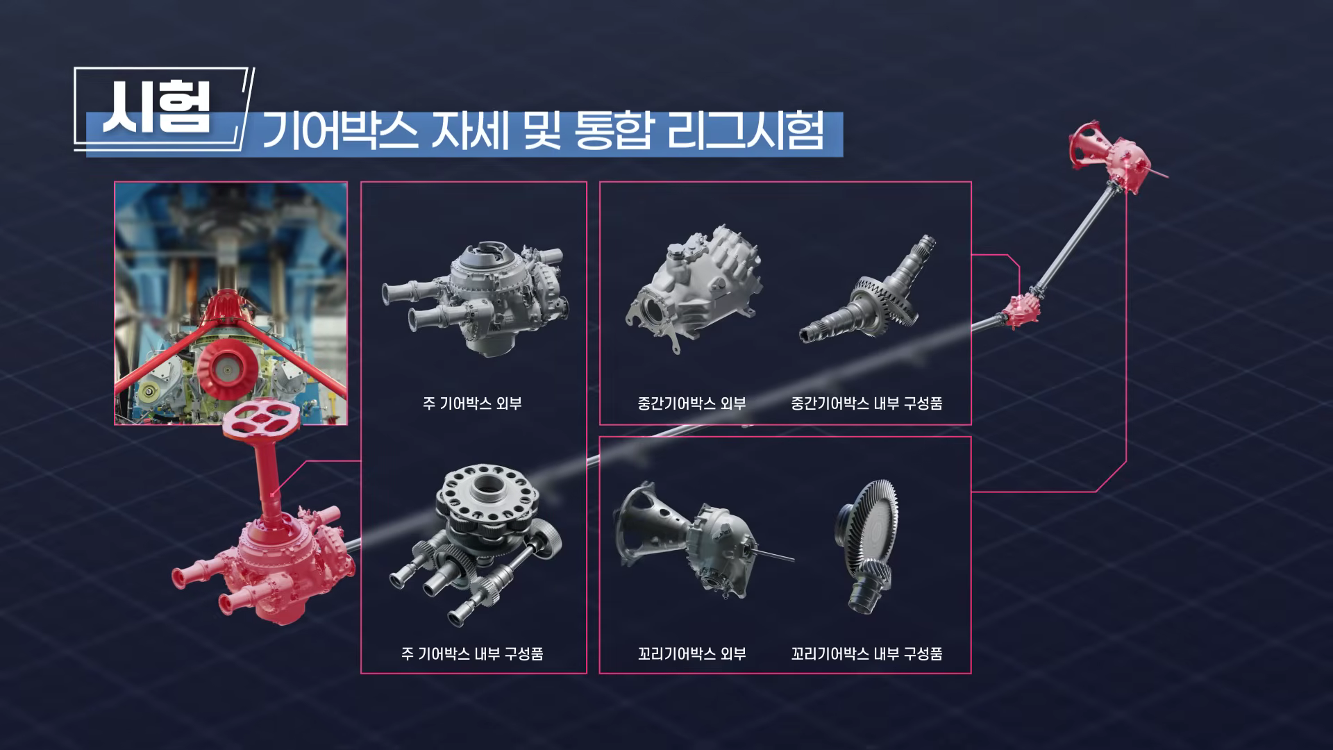

The KUH-1 Surion series helicopters currently primarily used in South Korea are developed based on the Eurocopter AS532 Cougar as their original design. However, while the original model was equipped with the Makila engine, the Surion had its engine changed to the T-700 series engine used in the Black Hawk.
However, because the engine was not properly compatible with Airbus's existing power transmission system, resulting in reduced output, the military signed a contract with KAI in 2021 for a project to upgrade and localize the power transmission system.
Previously, SNT Heavy Industries attempted to develop the main gearbox but failed, leading to full reliance on foreign imports. KAI has selected Italy's Avio Aero as a partner for joint development. The intellectual property rights for the main gearbox following this joint development will belong to South Korea.
Through this upgrade, the input-to-output speed reduction ratio of the KUH-1 Surion main gearbox will increase from the existing 4:1 to 5:1, leading to an overall 25% increase in speed. The existing French-imported gearbox limits the power output to 19,200 pounds.
However, the domestic production of the gearbox will enable the T700-701K engine output to be increased to 22,000 pounds.
This power enhancement will improve the troop and cargo transport capacity :
Existing Capacity: 6,000 pounds (2,721 kg)
Upgraded Capacity: 7,000 pounds (3,175 kg)
Consequently, the seating capacity will also increase:
Existing Capacity: 4 crew members plus 9 fully-equipped troops.
Upgraded Capacity: 4 crew members plus 11 fully-equipped troops.
The project is being conducted in a total of three phases, which are as follows:
Phase 1: Design of the power transmission system and preparation for domestic production, development of key main gearbox components.
Phase 2: Assembly and test evaluation of the power transmission system.
Phase 3: Helicopter system test evaluation and certification.
Current Status & Timeline
Phase 1 was completed in June of this year.
Phase 2 is scheduled to be completed by 2028.
Subsequently, Phase 3 (test evaluation and airworthiness certification) will proceed until 2031.

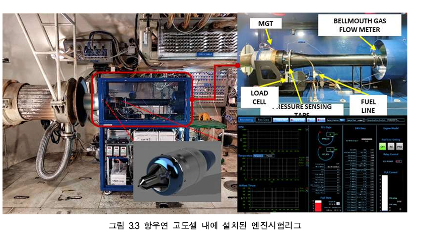

Altitude Test and Related Technology Support for Micro Gas Turbine in Localization Development
Demands for aviation micro gas turbine engines to be utilized as propulsion systems for civil or military unmanned aerial vehicles, personal air vehicles, urban air mobilities, electric-hybrid aircraft or new concept aircraft is steadily increasing. At present, micro gas turbines that produce less than 100 kgf thrust are not classified as military strategic materials, so export licenses are not required. As the propulsion system of some military target drones or UAVs has recently been found to be a micro gas turbine, there is a possibility that it will be classified as a military strategic material depending on the military use situation of the micro gas turbine in the future. To actively react to future market forecasts and changes in import and export policies related to micro gas turbines. SNH Co., Ltd. started localization of a 300N-class thrust micro gas turbine. Aero-propulsion research department of KARI intends to support the rapid development of a micro gas turbine engine commercial model through this R&D program by utilizing know-hows related to micro gas turbine engines accumulated through a series of precedent related projects. In addition, technical training for research personnel of SNH Co., Ltd. and promotion of the current R&D program by presenting research results at the related technical conference were carried out.
The Korea Aerospace Research Institute (KARI) carried out the project, "Development of Core Technologies for Small Engines Based on 3D Printing for Unmanned Aerial Vehicles," for three years starting in 2016, as part of the "Future Leading Core Technology Development Project for Unmanned Aerial Vehicles."

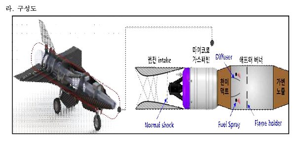

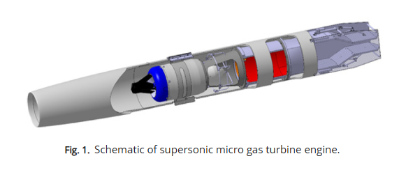

Micro Gas Turbine-Based High-Speed Propulsion System Technology for Supersonic Small Unmanned Aerial Vehicles (Applied Research)
Technology Development for a High-Speed Propulsion System Based on a Micro Gas Turbine Engine with Less than 1,000 N Thrust, to be Mounted on Air-Launched Multi-Purpose Small Unmanned Aerial Vehicles, etc.
(Project duration: 48 months from 2022 to 2026; Investment: 2.376 billion KRW)
Design of Pitot Intake for Supersonic Micro Gas Turbine Engine​
The achievements made to date were exhibited at this year's ADEX.
