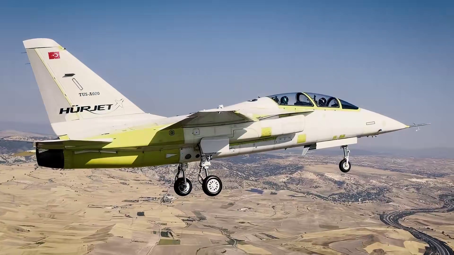

THE FIRST HÜRJET TO BE DELIVERED HAS BEEN PRESENTED TO GÖK VATAN
🔸The first HÜRJET – Turkey’s first jet trainer, developed by Turkish Aerospace Industries (TUSAŞ) using domestic capabilities under the coordination of the Presidency of Defence Industries – which is to be delivered to the Air Force Command, successfully completed its maiden flight on the 104th anniversary of the Great Victory.
Avionot
Member
5
2 59
The first HÜRJET to be delivered to the Turkish Air Force has completed its maiden flight.
After final assembly activities were completed, ground testing commenced. Following the successful completion of taxi tests, the aircraft successfully completed its maiden flight, remaining airborne for 18 minutes. HÜRJET P1 also accompanied the aircraft during the flight.
The HÜRJET program has now reached a critical stage in the production and assembly of the aircraft to be delivered under the contract.
