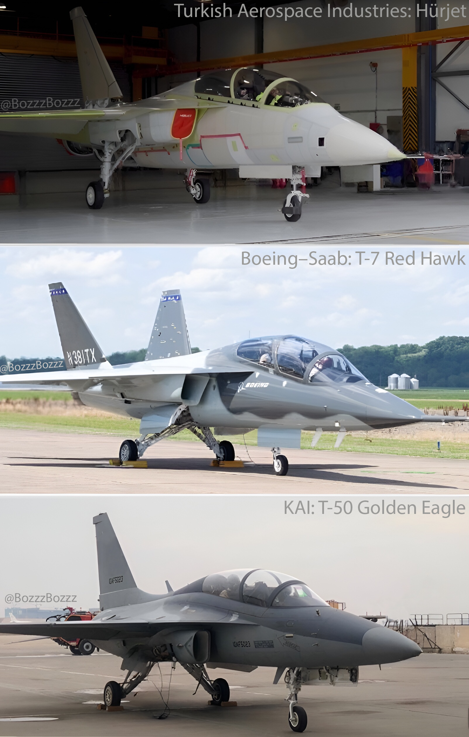

Does anyone have any thoughts on the difference in landing gear and their position? Pros or cons?
Was gonna ask the same question myself (y)
While T50 and T7 designed on center lined main landing gears similar to F16 and old F104, on Hurjet they preferred the main landing gears beneath the wing roots.
The only main gain I can think of is Hurjet’s prospective ability to carry centerline pods and even ammunition.
On structural strength and weaknesses, experts here can do a better assessment.
Saying that, however, can’t help but notice the resemblance between Hurjet’s and F14’s main landing gear design. *wink wink.

Thinking about the jets Hürjet hopefully will train its pilots for, tricycle design is similar to that of F-16. But, same job is currently done by the T-38 with its more traditional landing gear, which is similar to that of Hürjet. One would think that the traditional design is more stable during landings, remembering the BF-109 from WW2?

More balanced and more safe for trainer pilots. also if im not wrong tricycle design was related to speed for thinner wings
