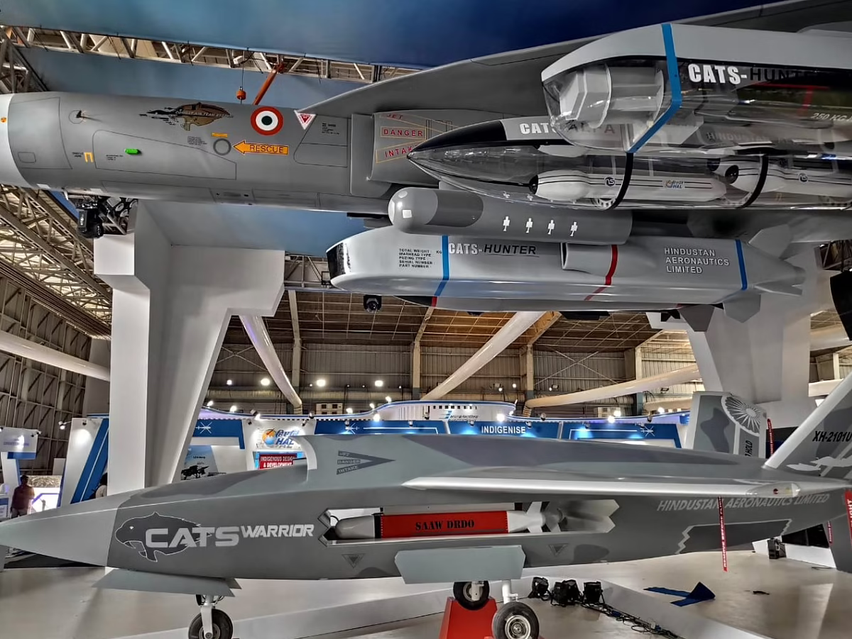

@Rajaraja Chola I would prefer to develop pods capable of controlling CATS Warrior UAVs or the likes effectively and act as the mothership with secondary controls handled by local AWACS & ground stations.
Secondly, you don't see USAF using any Growler variants since that role is primarily taken over by AWACS. If ADA/IAF wants a Growler version, it's best reserved for AMCA or TEDBF for IN
That is cos USAF has enough Awacs in the first place. Our Awacs fleet was found wanting in 2019 with the aircraft directing the pilots sitting on ground. Netra took off only later.
We have just 5 AWACS and assuming 2 are in maintenance, we have only 3. So it's not a bad ideq though SU would be good platform to develop on it.

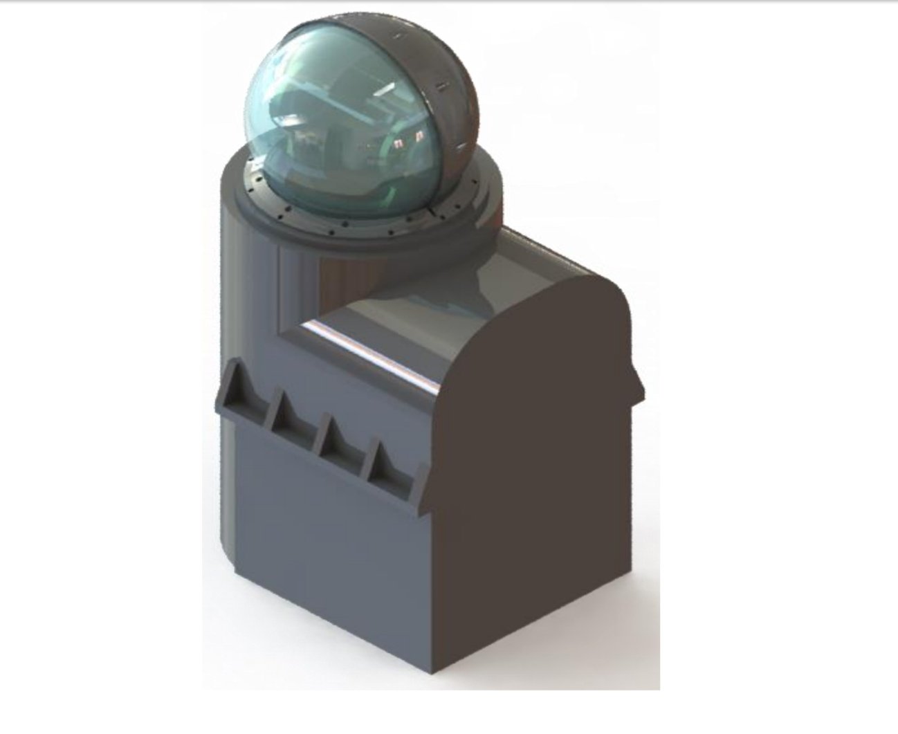

IRST meant for Tejas Mk-2
11,084
153 22,645
Not sure if this is accurate as LRDE is the developer. Does this.mean Astra has won the contract to manufacture radars?
Looks like that tweet got removed/deleted.
Here is another one
I would say its likely that company would indeed be playing a huge role for Uttam going forward....not sure how contract dynamics works out with LRDE. I guess lets wait and see how the actual order contracts shape up later.
