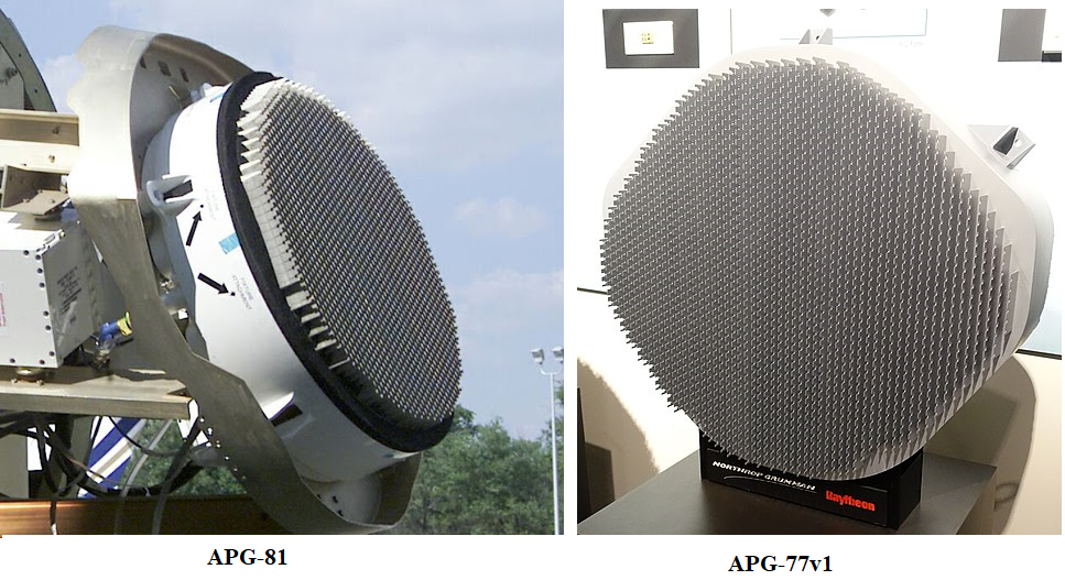

Lol the antenna technology on American radar is probably a generation ahead than its European counterpart.
Just to remember here, the APG-77 and 81 comes 20 years ago and the European's has yet to field their own counterpart to those two.
The APG-77v1 and APG-81’s large bandwidth also allows the F-22 and F-35 to use their radar for powerful broadband jamming. Their radar is the primary transmitter for the EW suite, providing 10 times effective radiated jamming power of dedicated EW platforms.
[3]
This is what allows F-22 and F-35 to provide escort-jamming support to legacy aircraft, whereas Su-57’s EW suite is purely for Self-Protection. The N036 radar is expected to have limited Electronic Attack capability but it’s highly unlikely that the current radar has any such capability. The Su-57 very likely needs a new antenna design to accommodate EA capability – similar to how EF Typhoon requires a brand new AESA radar (ECRS Mk 2) for EA operations. This is mainly because a jammer requires wider bandwidth in order to be viable, preferably requiring a notch antenna. Of course, a post-production upgraded radar can’t match the level of integration to one designed from the onset to be deeply integrated with the EW suite. Just like Typhoon’s ECRS Mk 2 and F-18E/F’s APG-79, future Su-57 radar’s EA capability will not be anywhere close to that of F-35 or F-22.
