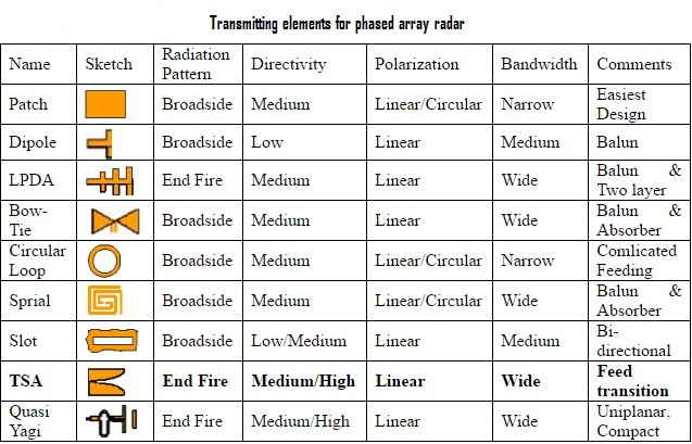

Older ESA radars uses the Patch antenna, because its easy and cheap to manufacture, the downside is low bandwidth = decrease in resolution.
Older ESA radar like the IRBIS-E PESA uses Patch antenna

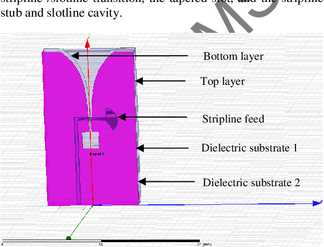

The more advanced one currently in use in Western air forces are the Vivaldi Notch antenna which has wide bandwidth, higher gain and high directivity = Ultra High Resolution,. In addition to better LPI, ECCM
APG-81, 77, 77V(1) and HANWHA AESA all uses this model antenna
