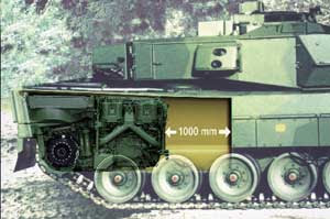

all of which need additional power to cope with the increase in weight and power generating.
for engine ? as long as its reliable it didn't need any upgrade,
MTU 883/890 1700hp with less space= less weight
that is more room for fuel, ammo etc. in short growth potential.
