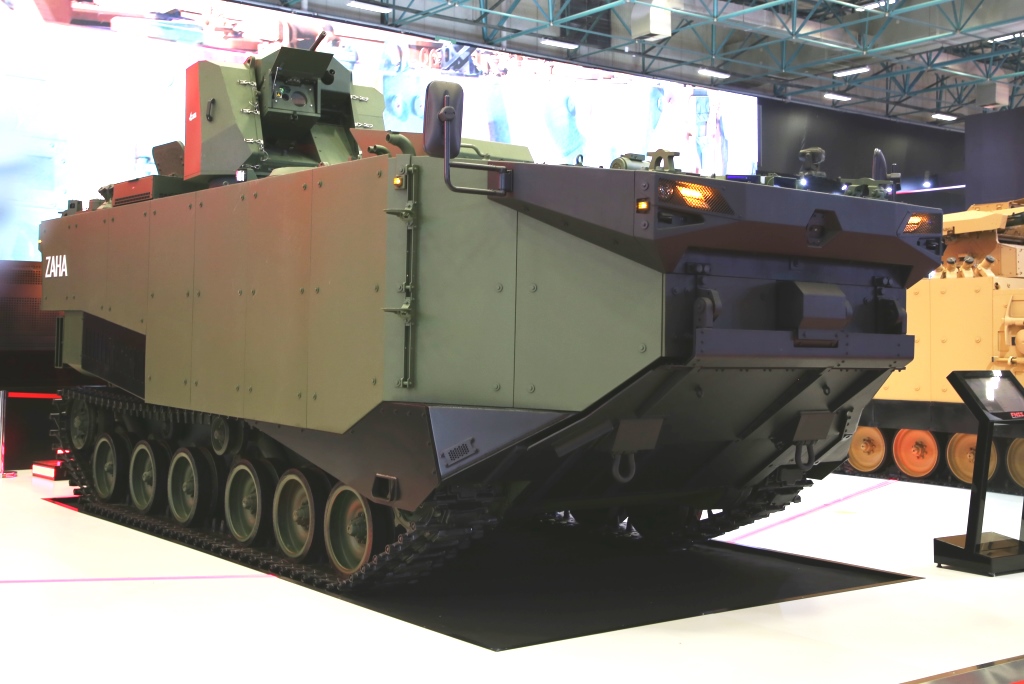

Zaha = LVTP7's latest iteration's base design + optimization for tight requirements of Turkish navy + Turkish subsystems + a finer design on top of the chasis to suit certain needs for survivallbility.
Some thinks ZAHA is directly manufactured under the license by BAE (AAV), then if this is the case why design process has started from years ago, and certification as well took another years, including towing tank tests that took a half year to complete. Why has everything been made almost from scratch? No wonder FNSS benefited from LVTP7 design, used it as a base and built their own solution on top of it.
Who offers broader modification? Depends on the count of the order, FNSS may do that for small batches, BAE wouldn't move their finger for some small batches.
Most of these modifications done by FNSS, despite of having a share in that company BAE can not take and apply these on their own design without paying loyalties and getting permission from Turkey for the delivery.
Sorry for not being familiar with Turkish language, but is there any special meaning behind the name?
Zirhli Amfibi Hucum Araclari (ZAHA) (Armored Amphibious Attack Vehicle).
Btw between ZAHA and LVTP 7, there is also consideration of logistic support, and other after sales stuff. It means FNSS should seriously to set up their office in Indonesia including maintenance house for their products in the region (which already included Malaysia, Indonesia and Philippines)
