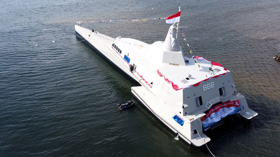

Yes i think, golok will be the NSM testbed
IIRC, there were some old concept pictures of Klewang years ago where the missile launcher tubes are installed perpendicular to the boat's mainline. Now I'm guessing that they'll mount the launchers facing forward on both sides given that there's an RHB ramp on the boat's stern.

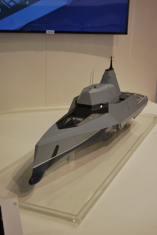

evolved into something like this.
for "menggetarkan kawasan" reason.
Right. Well, I caught some "Space Battleship Yamato" + "Patlabor/Gundam/Macross" vibes in that design. Or, in other words, cool AF.
I don't mind if Klewang-class FAC will eventually evolve into something like that though.
Will they add new holes in the superstructure for the NSM?

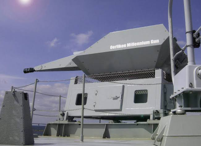

I hope they installed CIWS on current klewang 2, coz its suck to see a battle ship without maingun. Lets say perhaps we can borrow AK 630 from other ship, hehe.
The original plan was to embed the launchers inisde the superstructure so it was actually meant to be cut anyway.

On the other hand, Golok does need to prove its worth first so this fit and firing test of the NSM will be crucial for its future. I'm really looking forward to see it in full gear with radar and other electronics as well as some proper CIWS to replace that old 20 mm manually-operated cannon.

Actually that NSM spot was visible on Klewang, where the launcher lid and exhaust doors could be seen.
I don't remember if they did plan lateral launchers in the earlier concepts but since i know this trimaran concept after its CDR phase, the launchers were forward facing.
Yet still, a forward launched missile's trail and rocket fuel remnants will directly feed into the engines via those air intakes places on sides. They will need to do something for that. I am not sure what kind of rocket propellant NSM uses for the initial launch.

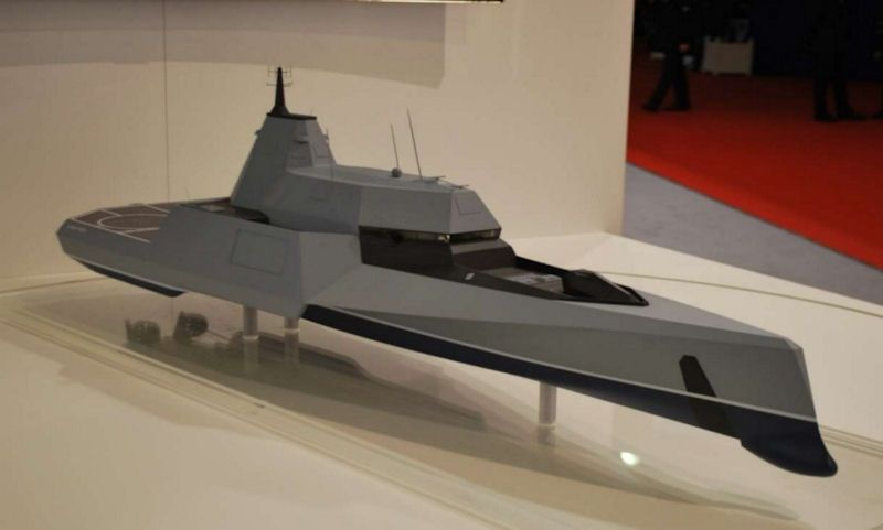

Yeah, it's kinda obvious. Like in this concept art of Lundin's NSM equipped combat boat:
Although I have no idea what will they use the empty space inside the KRI Golok's boxy structure for after mounting the launchers inside. Some kind of missile launchers' exhaust ports perhaps?
