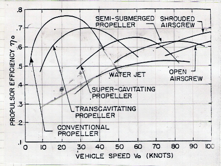

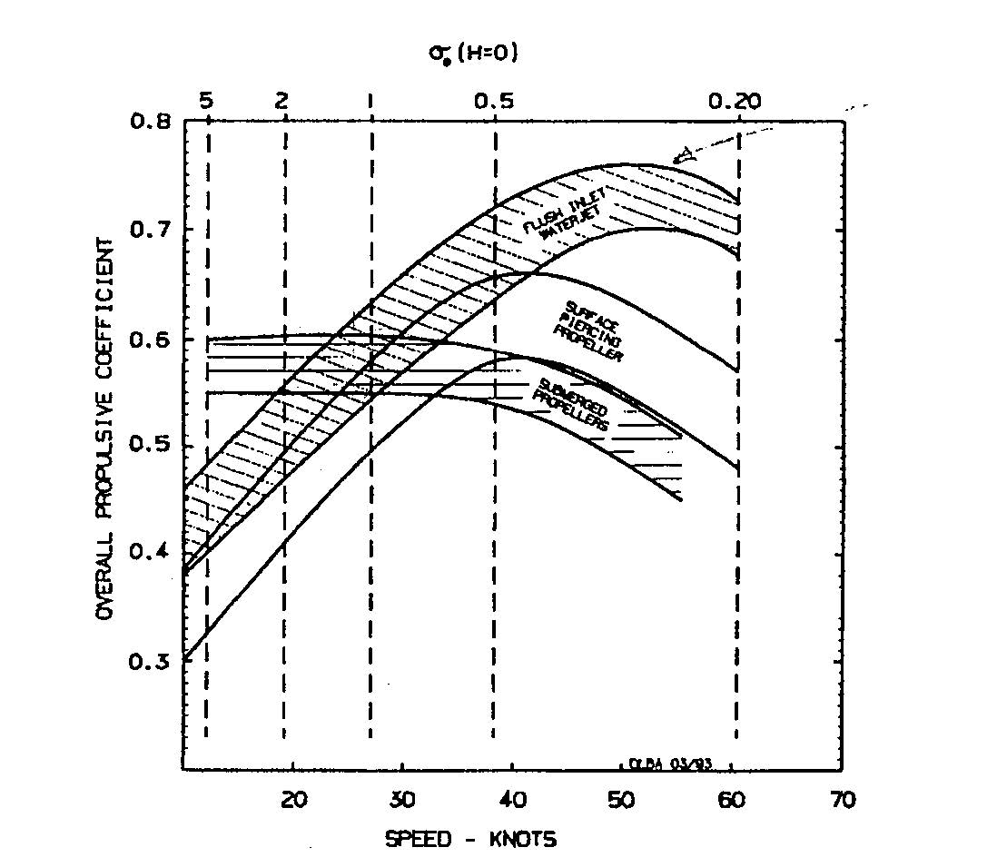

Water-jets in fact is fuel-efficient if driven in lower speeds. They are fuel-hungry at high speeds that propellers can not be used (and if able to be used, would drain the fuel tanks).
There are two kind of efficiencies for hydrodynamics of propulsors.
1st, propulsor efficiency, efficiency of the lone propulsor unit, excluding integration with the vessel and mechanical transmissions, as well as shafting, it is the lone propulsor, if propeller merely propeller rotating in an open water; if water-jet assembly of stator-rotors and shrouding - inlet - outlet in open water.
Then there comes overall efficiency, assuming integration with the hull (thus the velocity profile subjected on propulsor, usually increases the efficiency) accounting for mechanical losses due to the shafting etc.
wow thats actually new insight for me, but that's also sparks another question, if naval ships, (like patrol boat, corvette and maybe frigate) rarely operate in high speed, then why don't they massively used waterjet props, which you said more efficient in slower speed than propeller?
i mean, i recall something but not recalling the source, about Indonesian Ship, idk if its the navy or the coast guard. Even if they are in dire situation, they don't go full throttle, for like 25++ knots but maintain cruising speed, for which typically 15-18 knots, (right(?)).
That means full throttle is not everyday use. I began to think that full throttle or full ships ahead is just the maximum capability of its propulion system, not necesessary used, but it's there if you need it.
wow thats actually new insight for me, but that's also sparks another question, if ships rarely operate in high speed, then why don't they massively used waterjet props, which you said more efficient in slower speed than propeller?
Conventional propellers are still more efficient up to 20 knots by a great margin (10% to 40% and here commercial shippers could mind even 1% efficiency), at 20 to 30 knots these systems are head to head. +20 knots are usually not preferred by commercial vessels/ferries, there are only few with topping 30 knots and at that point they value simplicity over complexity of a waterjet.
Also a waterjet are limited to a size, while propellers are not (technically, might differ practically).
In fact waterjets are common with ferries that do not exceed 30 knots too, entertainment boats (jetskis for also safety reason) etc.
It is a balance between;
  1. Initial costs
  2. Maintenance costs
  3. Operation costs (fuel - lubrication - manning)
  4. Mission profile (speed profiles of a vessel, as in how often high speed regimes will be visited)
  5. Necessity of high-speed regimes (Depends on operator if high speed regimes are required despite of 1-2-3).
  6. Design volume restrictions (waterjets occupy less volume, smaller transition, less weight, easy to include in design as rotator-stator comes with fixed geometries)
Based on these you may also see propeller using boats topping 40 knots, or waterjet using ferries not exceeding 25 knots.

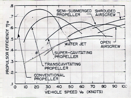

  1. Initial costs
