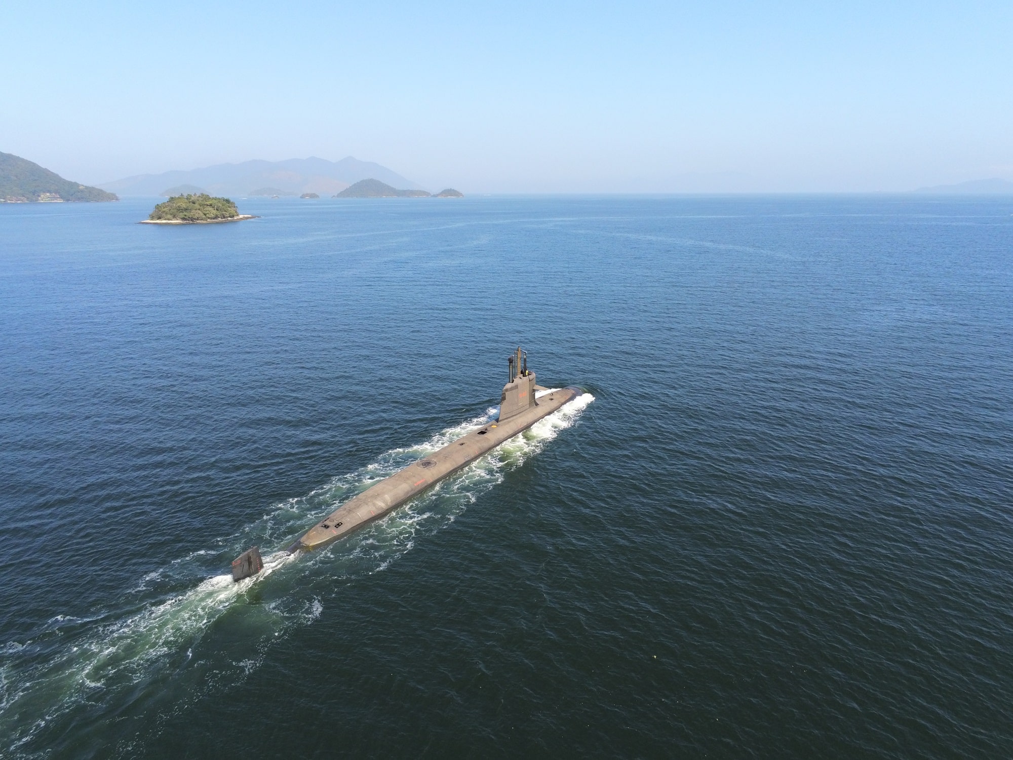

It has to be something they already mastered than. So type 209 ?
If its type 209, maybe Tupi class from Brazil could be the solution. What about the Turkiye type 209?

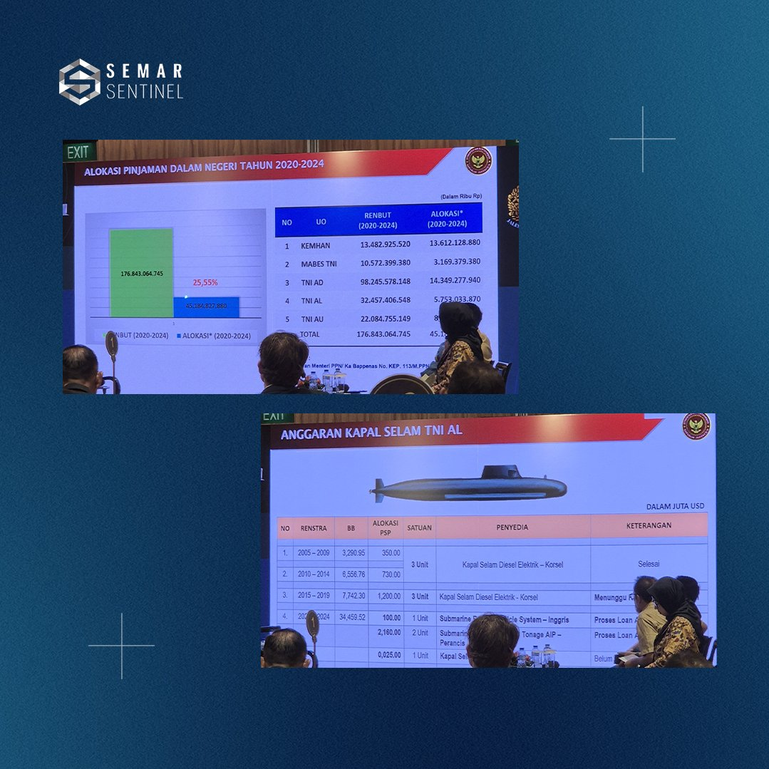

based on the table, the 2.16 bil scorpene evo still on process for the loan agreement

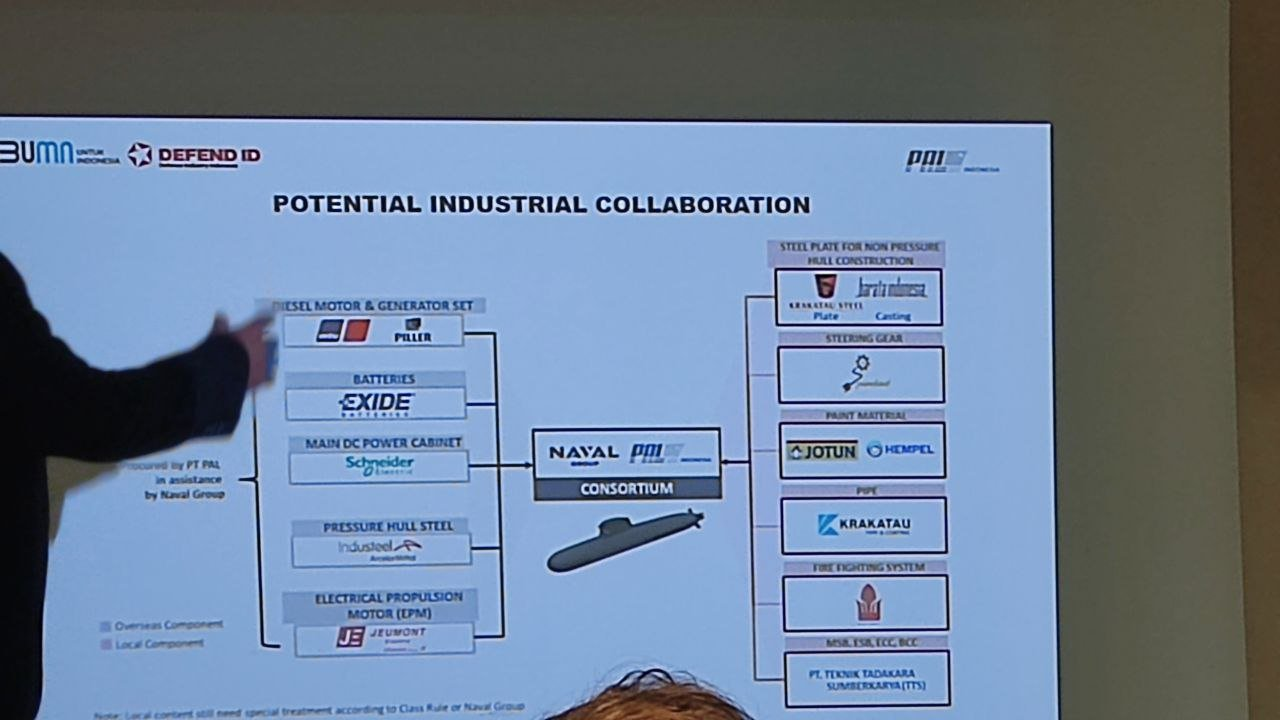

also the detail which local Industries will took part in Indonesia Scorpene could be seen from the naval group presentation
source
For Local industries:
non pressure hull steel by Krakatau steel, steering gear by pindad, paint material by jotun & Hempel, piping by Krakatau, fire fighting system, and Mainswitchboard, ESB by Tadakara SumberKaya.
source View attachment 68033

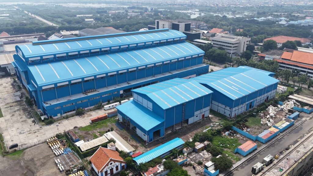

The Scorpène Evolved will be built by Indonesia’s state-owned shipbuilder, PT PAL Indonesia, in its shipyard complex in Surabaya City East Java, with the support from Naval Group. With a total cost of $2.16 billion, the Submarines should be delivered to the Indonesian Navy (TNI AL) within 96 months or eight years of the contract’s effective date.
PT PAL’s submarine production facilities in East Java. PT PAL Picture
While the loan agreement that will finance the project is currently being worked on by the Indonesian Ministry of Finance, PT PAL has begun the process of upgrading its submarine production facilities. The upgrade will include constructing a new torpedo and electronic workshop and a new office for its submarine division.

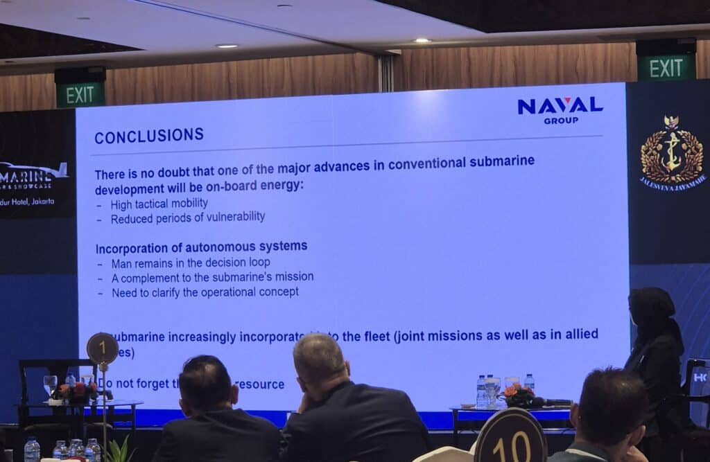

Naval Group Explaining Submarine-UUVs Integration during the Submarine Seminar in Jakarta (14/7). Naval News Picture.
During the Future Submarine International Seminar & Showcase organised by the Indonesian Submariner Club between May 14 and 15 in Jakarta, Naval Group presented its Unmanned underwater vehicles (UUVs) solution that can be integrated with Indonesia’s future Scorpène. Depending on user needs, the UUVs can carry out various types of missions, including special forces support as well as intelligence, surveillance, and reconnaissance (ISR).

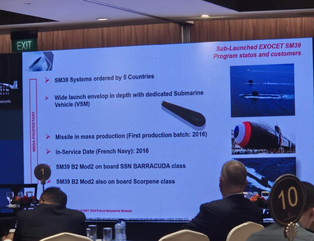

MBDA also presented its SM39 B2 Mod 2, the submarine-launched variant of the Exocet missile family, that can be launched from Scorpène’s torpedo tubes.
These presentations suggested that the French Government had approved Indonesia’s potential purchase of the aforementioned systems. On many occasions, including during the seminar, TNI AL officials have conveyed the silent service’s desire for its future submarine fleet to not only rely on torpedoes and onboard sensors.

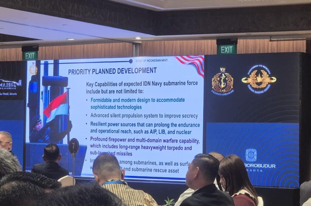

Admiral Ali also outlined some key requirements for TNI AL’s future submarine fleet; advanced propulsion system, resilient power sources such as lithium-ion batteries (LIBs), air-independent propulsion (AIP), and nuclear, as well as multi-domain warfare capability.
MBDA Presenting Exocet SM39 during the Submarine Seminar in Jakarta (14/7). Naval News Picture.
