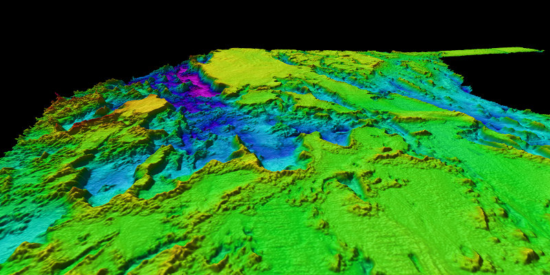

At this situation we are probably looking for a submarine has run aground on the bottom. Hydrographic vessels suits best for this case. Anything with a side-scan sonar or multi-beam (such as KRI rigel) sonar for mapping the ocean bottom is needed.
It was a common practice for a vessel with side-scan sonar to acompany torpedo exercises 1st to scan sunken object and to track torpedo.

multi-beam and side scan sonars intended to scan directly below the vessel, unlike the ASW submarines, hydrographic vessels are not interested with a detection far from the source, but right in the nose of the source so refraction &reflection effects are minimal.
They will serve their purpose when they arrive at the location, at least localize the site and determine status of the submarine via ROV,inclination of the sub and etc, so that rescue can start as soon as possible.
