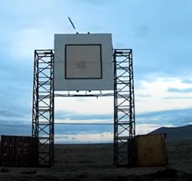

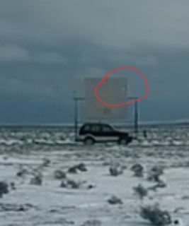

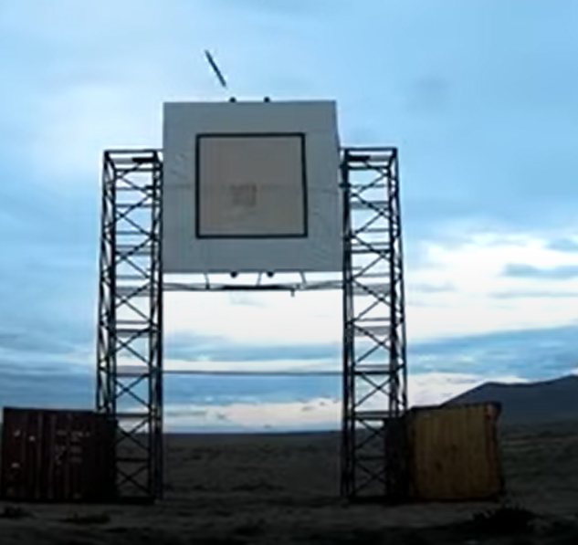

No, you can see the hole left behind by the missile. It just doesn't have a active warhead.
I don't know I just felt like it passed just above. There is one sequence with hole before but can not see here after it passes.

Well the laser spot, which we do not see, could be close to the front, or if there is deviation it could be within the tolerance for SAL guidance… overall a very nice video.
Next stop should be jet powered NLOS missiles with more range.

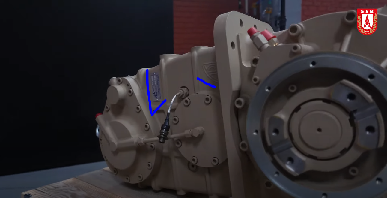

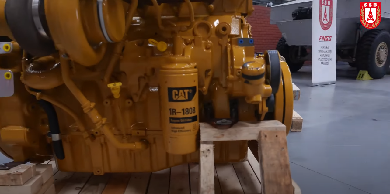

I was looking through previous FNSS Videos to see if they still use Advance Design Solutions Products.
FNSS Pars IV 06/2020 Start of Serial Production.

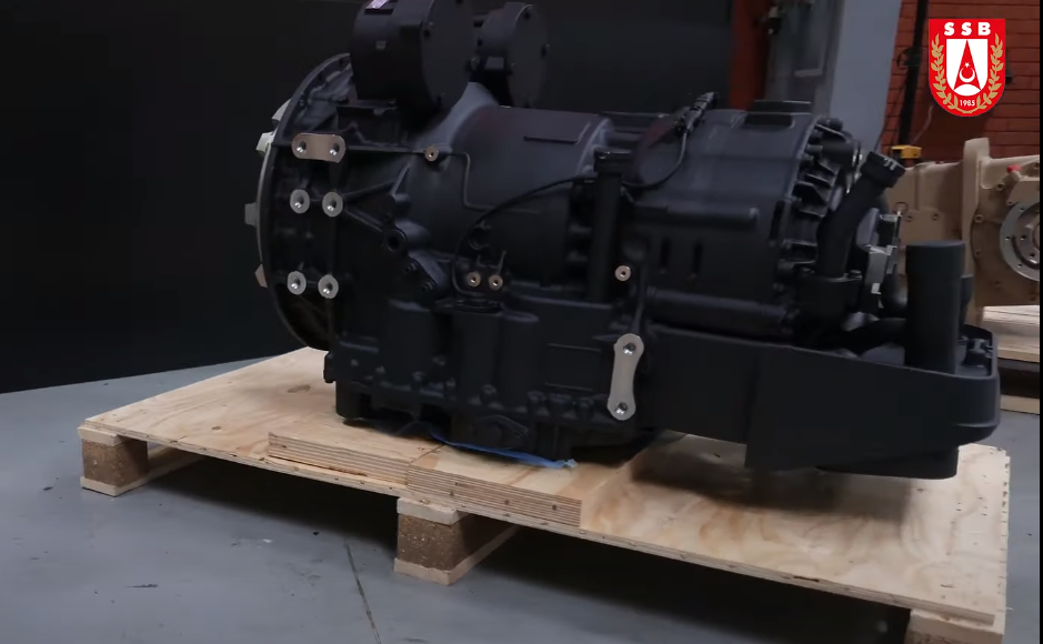

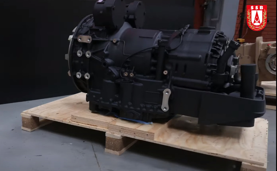

> ADS Transfer Case
Allison 4500 Automatic Transmission.

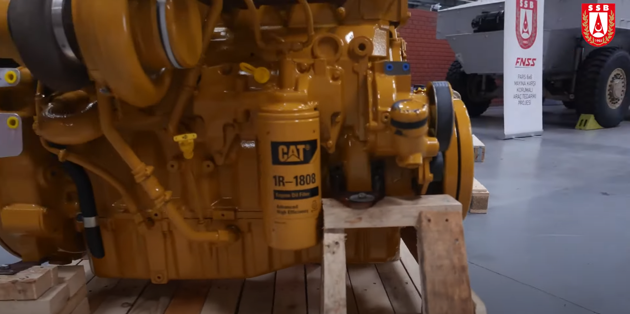

The Engine OIL Filter with the Serial 1R-1808 belongs to the Caterpillar C9 Line of Engines
View attachment 37962 View attachment 37963
The Engine Power should be 525 HP because FNSS always aims for 20 hp/ton Ratio and since the Vehicle weighs 26 Tons this would be given.
Additional Info at this point.
FNSS usually went with DEUTZ Engines, specifically 482 HP Engine but due to German Embargo likely selected the CAT C9.
FNSS PARS IV 6x6
> CAT C9 525 HP
FNSS PARS IV 8x8
> CAT C13 711 HP
