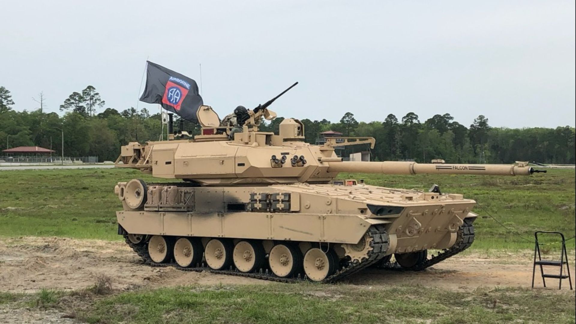

IMHO Turkish Land Forces especially Navy should acquire relatively light tanks around 35-40 ton.
In this regard Turkish defence industry has every capability. Why not use the opportunities?
The U.S. Army Is Getting Its First Light Tanks in More Than 50 Years​
