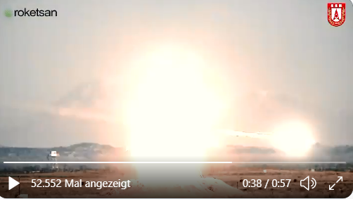

I rated the shot as a failure when the missile is indeed ATGM.
But if I look closely at the pictures, I see that the rocket actually has a different mission. Namely against gatherings of people, for cave operations and against underground bunkers like the Armenian applications during the last war. By watching the development of the explosion, I can definitely say that the missile did not carry an anti-armored head.
The exposure is a thermobaric explosion, which makes the missile a weapon of hell. Now firstly the Picture fron new Video:
Especially in the third picture, you can see how the oxygen is sucked in

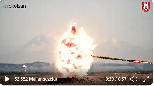

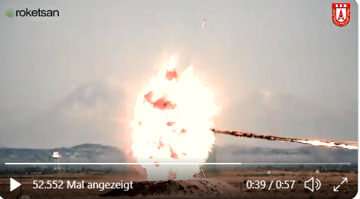

For comparison, same OMTAS as ATGM.You can see how the penetration jet is created.

I saw three effects on the video.
1) Shock Wave: What will explode the lungs of everyone around.
2) shrapnel
3) Sucking off the oxygen
Deadly more than deadly

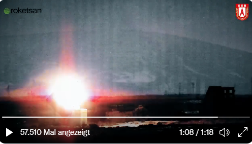

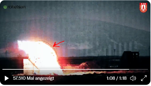

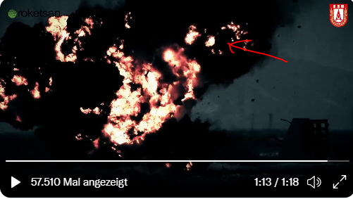

Perhaps the reason behind the differing explosions could be due to the target types.
For instance, in this frame there is a lot of debris. Almost like ERA tiles.
And in this frame, you can see how the extent to which there is reversed projection of explosion similar to how explosive reactive armour is designed for
So, it could be that OMTAS was tested against a target with ERA tiles?
The target; looks like square segments on the facia with a sandwich of plates
Here, one of the square plates likely part of an ERA tile is seen quite clearly as it shoots by the camera

I must say for sure that you are right. the target is with reactive armor with ERA tiles. Even in the video we see another target with ERA tiles 1st generation.
The fact that ROKETSAN supported the targets with a thick concrete segment also hides from us whether the target has penetrated. I have to say pretty clever.
