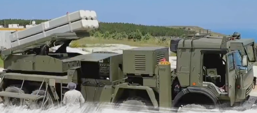

Written by a Greek author, this article explains in depth, what our TRLG artillery rockets are bringing to our army’s capabilities.
How TRLG-230 and soon to be TRLG-300 are becoming killer missiles for moving land targets as well as moving sea targets. (Their introduction, according to this writer may also be expanded in to Bora TRLG.)
These missiles with these seeker heads, can be used against enemy naval assets as well. This together with the use of UCAVs carrying them 24 hours a day will create No-Sailng zones around Turkish coasts in excess of 100-150km.
As they have high supersonic impact speeds, they will be carrying so much kinetic energy that it would negate the need for large explosive heads.
guess in some cases when needed even ULAQ type unmanned surface vehicles can be used as a Laser designator to call for a TRLG-230 strike against enemy naval assets :devilish:

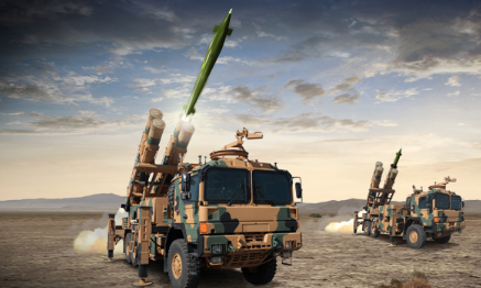

But there is a problem .. the laser seeker require designator .. so either land elements or uavs has to illuminate the target ..ok the laser seeker are far cheaper than iir and rf ..but they require designation .. and with maximum range of laser designator ~30km in turkish uavs ..i think they will depend on gps/ins guidance mainly

Can we assume that TRG 300 air launched version from F16 will be over 250 km?
Trg300 has a Range of 90-120 km
trg230 has a Range of 50-70 km
So if trlg230 when air launched goes 150+ km;
Pro-rata trlg300 should go 250+ km
Israel already using trg300 equivalent as “rampage” missiles. And it is said to have “hundreds” of km of range. That would indicate at least 300+ km range. (200 km should be couple of hundred, not hundreds)
Remember this missile doesn’t need as much explosive due to it’s kinetic energy when hitting targets. So you can put more fuel to extend it’s flight time and range.
