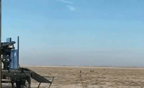

Within the scope of the "Pedestal Mounted CİRİT Weapon System Project", which was launched with the aim of providing additional capabilities to the anti-tank divisions and capable of firing UMTAS and CİRİT missiles, the targets determined in the inspection and acceptance firings carried out in Konya/Karapınar were hit successfully.

I didn’t like the black smoke at the initiation of main engine of “Karaok” missile
