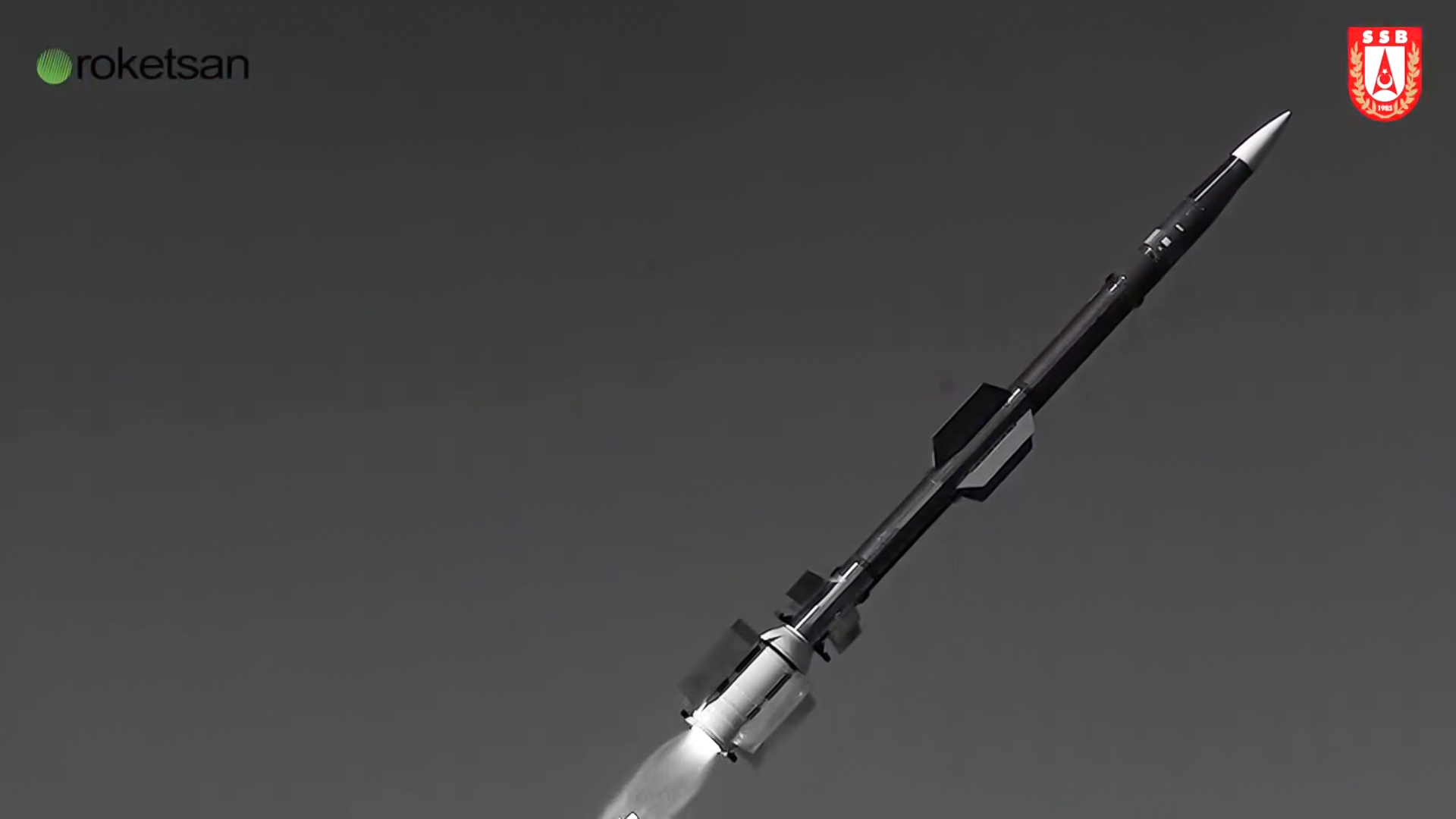

Imaged, is Hisar-O with booster ? Structurally the surfaces do not match with SIPER
4,259
256 22,242
It is a fact that as soon as you add or change anything on these missiles, you are altering the missile’s aerodynamic structure. So if by adding RF seeker head and a booster, they altered these so much that even the fin design had to be redone.
I can add as a conjecture; Whilst at it they may have streamlined it so much that it would fit in to MILDAS’s cells in quad pack form. Hence the black missile. Looking sleeker and very different.
President of SSB was talking about HISAR-O being integrated with booster in recent CNN interview, I'm wondering whether these are two separate projects.
Thinking out loudly; If the Hisar range is really for the Army and the Hisar-O RF is the only one Navy is interested in, then it is logical to increase the range of Hisar-O+ with a booster for the army. Having done that and finding what you can achieve, they may have gone on to Siper Naval! The black missile.
That goes along with your theory of two different projects. Especially as the Navy is insisting on quad packable missiles.
But if the same results are obtained for both missiles. the Hisar-O+ with booster could be dropped in favour of the quad packable black one.
