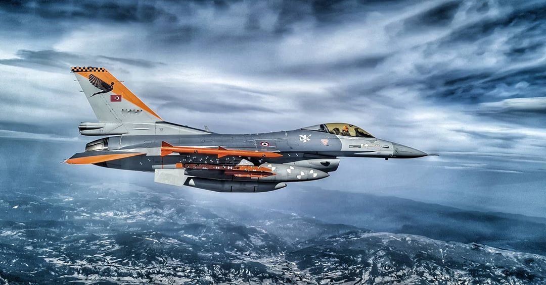

One thing I do not understand is why SSB is not pushing for the development of air launched trg-230 and trg-300.
if launched from air at ~40000ft and ~0.9mach; as the missiles will not have to overcome the gravitational pull and dense air friction at lower altitudes, their range will be dramatically improved. Israeli sources claim “100’s of miles” for their Rampage missiles.
These missiles have max speeds of around 4.2 mach. Making them high supersonic. By optimising the range and fuel quantity you can have more range (say 150miles) and more explosives with a trg300. It is almost impossible to stop these missiles by air defense systems. The missiles are very cheap compared to say subsonic SOM or Atmaca. They can be used in quantity without breaking the bank. TRLG version of these will be great to use together with small laser targeting drones for pinpoint accuracy.
Come on Roketsan stick your finger out and develop our Rampage!

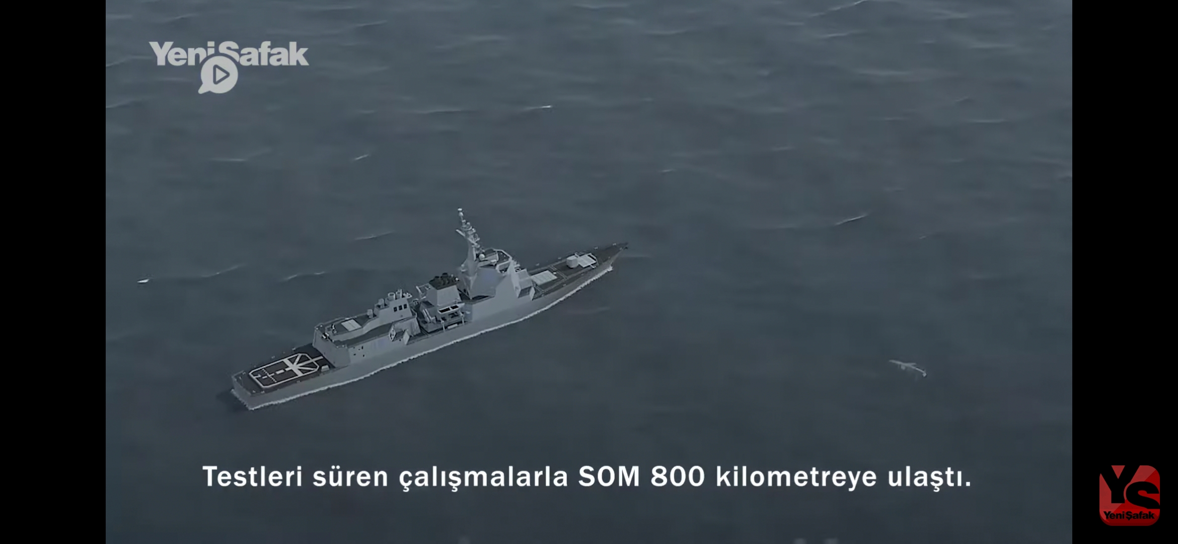

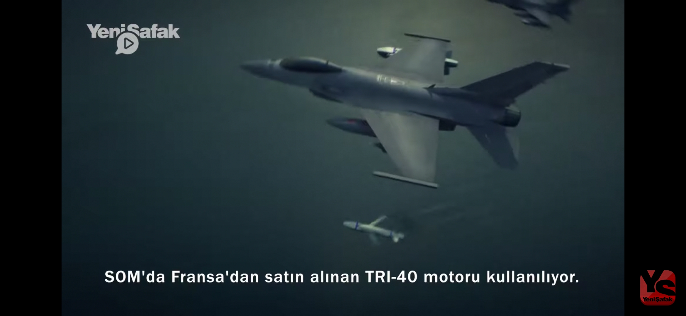

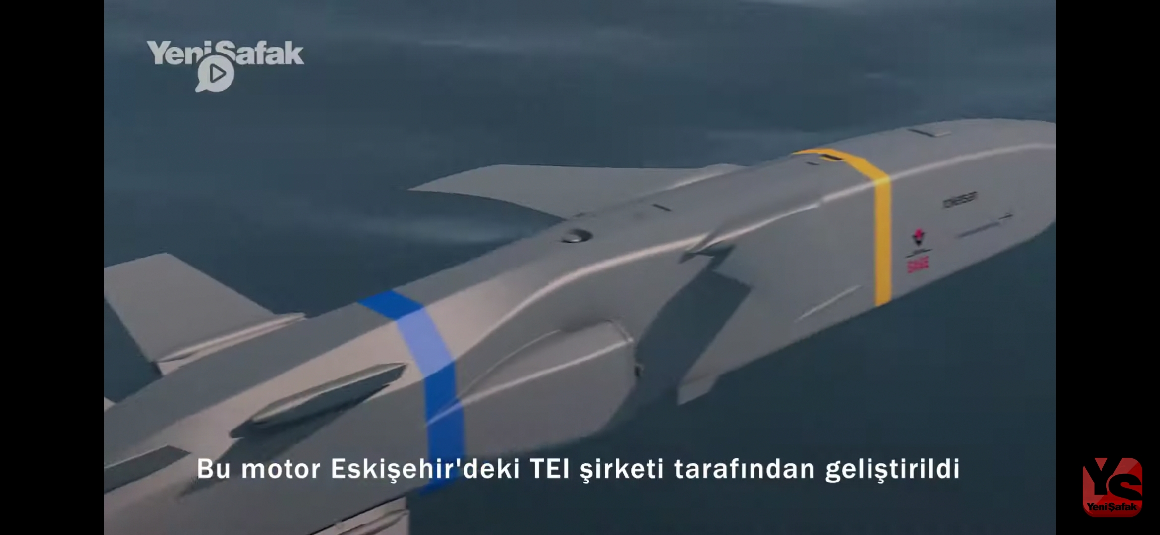

Pro government yeni Şafak claims TEI modified the tri 40 engine used in Som cruise missile and reached 800 km.
Before making such outrageous claims, don’t they ask someone who knows about these missiles? TR40 (Turbojet) driven SOM just can not go this distance. If they changed the engine to a turbofan 3.1-3.5KN thrust engine that could work a little longer and lost a bit of the explosive weight , then may be range would increase. But still not to that level!
He probably mixed it up with Gezgin land attack cruise missile. Rumored range matches also.

Interesting idea. TRG-300 Blk 2 weighs close to 700kg and is nearly 5m long. What kind of air platform do you have in mind that could safely carry it?
Rampage missile of Israel is of 306mm diameter, weighs 570kg and is 4.7 m in length. F16’s are used to carry and launch 4 of them. Trg300 block 2 is 670 kg. F16 has enough space and load capacity To carry them. Block 1 is same as rampage.
