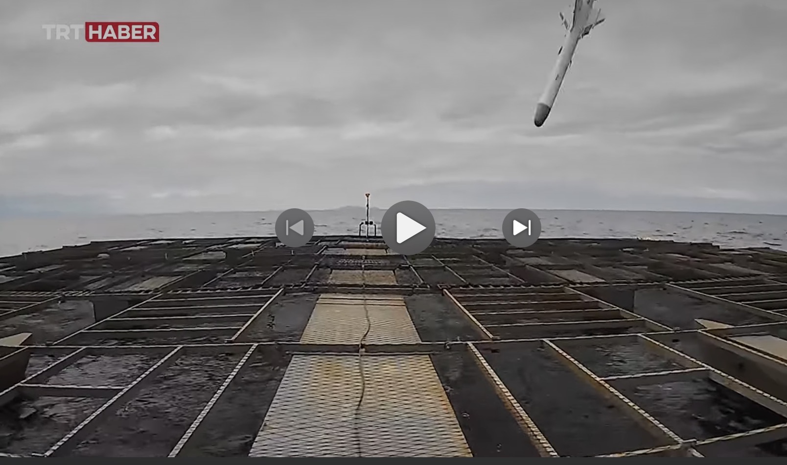

I dont know but i just see missile falling in to the sea in like max 3km distance???

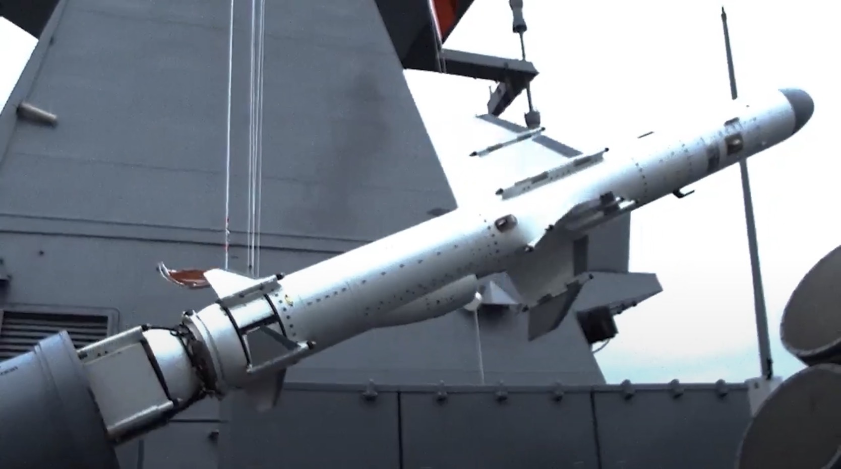

Atmaca firing to a target over 55NMs away.
MSB: Activities for the 'Distinguished Observer Day' of the 'Denizkurdu-II Exercise', currently underway in the Gulf of Antalya, are proceeding successfully.
During the exercise, in which targets were successfully destroyed, the national anti-ship “Atmaca Guided Missile”, developed by ROKETSAN, was also fired, successfully destroying a target approximately 100 kilometres away.

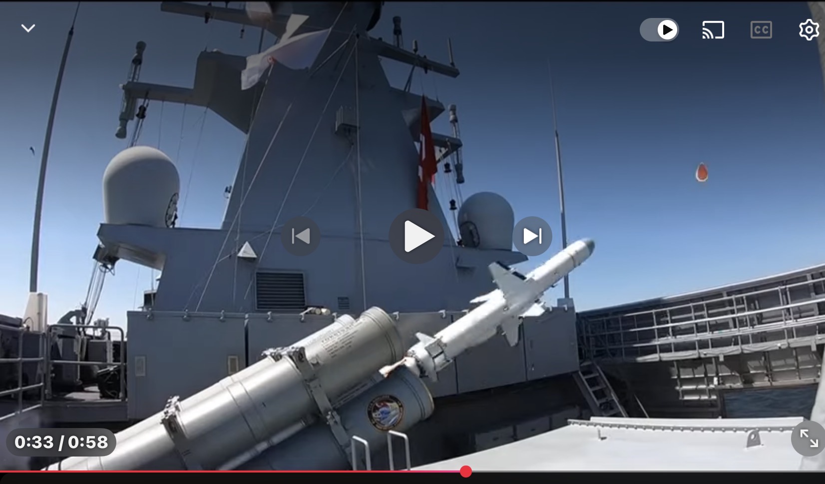

But is the missile itself going away? I dont see it, i tried to zoom in but cannot see it
Check out 12th second. Booster section separates from the missile.
Atmaca has a solid fuelled booster engine for initial launch. Once the missile reaches necessary speed it is dropped. You can clearly see separation of the booster.
As it has forward momentum it falls quite a bit further in to the sea. Missile itself carries on with the jet engine (presumably KTJ3200) thrust.
In a different video you can see this missile hitting a target 100km away.
