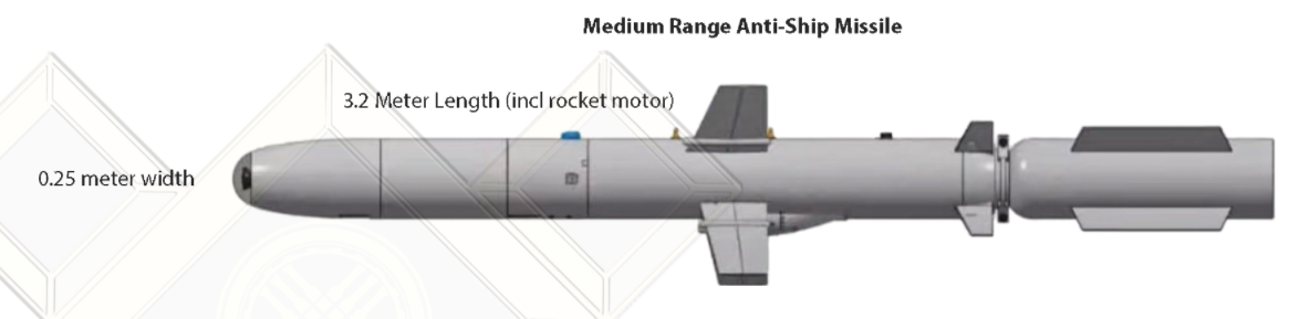

Did anyone else notice the wing configuration on Medium range anti-ship missile?
It doesn't seem to have traditional X wing configuration we are use to seeing.. Angle does not appear to be perpendicular to the opposite wing on the lower side of the missile - As an example, could be similar to early artists rendering of Gabriel-V Anti-Ship missile.
I guess its for preventing wings from overlaping with helicopters pylon.

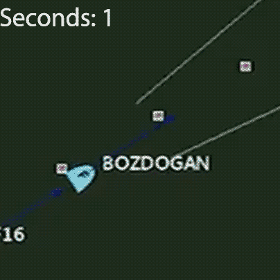

Looking at the telemetry, it seems every point in the diagonal represents 5km distance - which when compared to the radius around the F-16 is about 25km - taking into account max range of the missile is to be at 25km. When we apply the distance to the cone which starts to encapsulate the target drone at around 40km. Does this mean the tiny seeker on Bozdogan can track a small drone like Simsek at around 40km ? Also, it could be they chose this engagement angle with the sun in the backdrop to further test the seeker?

I tried to calculate too, my estimates are:
20-25 km for missile lock
10-15 km for launch
Slightly shorter flight distance due to target incoming. I used a 5 km uncertainty because I was lazy to use the real speed of sound, also did not use MS paint with precision.
Based on F-16 speed guess* (since no afterburner, and this could be their normal speed) of 0.8 to 1 Mach, FL200 to 300. (Reduces to 0.8 times those values for 0.8 mach @ FL300)
Şimşek target drone is flying 1000-2000ft below F-16, if not the same level, observing the HUD. Missile speed could be 2.4 to 3 Mach if F-16 is 0.8 to 1.0 Mach.
The distances between points are not equal, that’s why I did not guess using them.
The complete circle is shooting range, almost equal to LAU to other LAU, the outer one is locking range. Could be only for test purposes.
Note the circle stops moving after launch, so its center is where computer thinks missile is launched.

I did some calculation with closure rates and distance travelled in a second. 20-25km.
How did you calculated that each dot represents 5km?
Missile reaches one point to the other in average speed of 1.25 km/s. That's around 3.6 mach, missile is stated to be around 3-4mach.

Makes sense, but missiles rocket motor is probably still burning. It may either gaining speed or losing.
Would be nice to know whether Bozdogan has a dual-pulse rocket motor, some sources state that it does, but no official information has been released. If it does, it could be that we are just witnessing the sustainer burn/burn out with second terminal stage propelling it to Mach 4+
Would especially like to know why it weighs so much compared to it's equivalents :)
If they are flying near FL200 it’s even more, like 3.9 Mach if 1250 km/h is assumed. But this time F-16 must cruise at 1.3 Mach based on relative motion (roughly 3 times) on the screen. They don’t seem to use afterburners, of course they could be slowing down...
