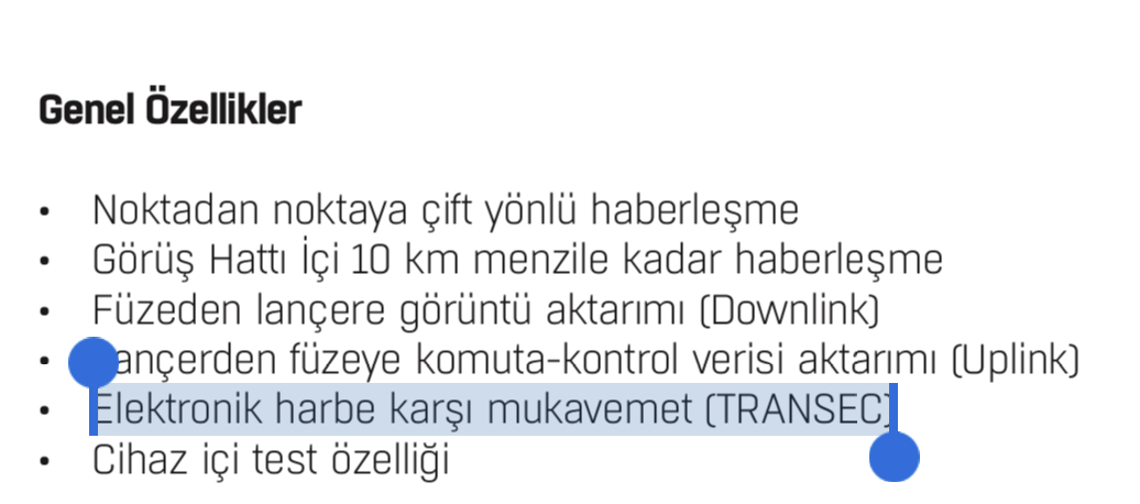

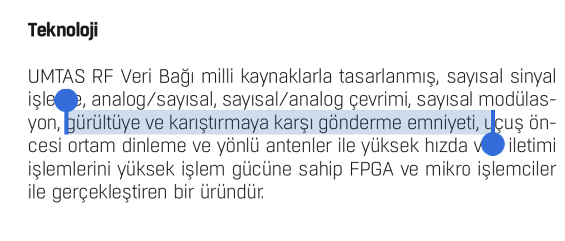

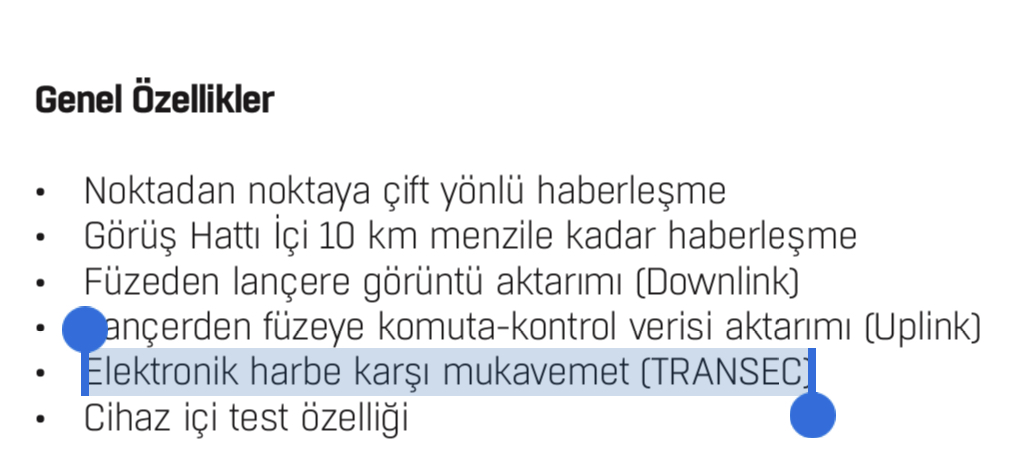

View attachment 21572 View attachment 21573
What is this, forum EW experts?
If you want range - which is what you want, you are going to go R/F there's no ifs or buts to it. No one is denying electronic interference can be an issue, and I'm sure Aselsan who has decades of knowledge in this area are fully aware and have hardened their links with various techniques to overcome such issues.

I like how they reduced range from 12km to 10km :)
Also note how it says: line of sight. UMTAS feed looks much better than OMTAS and that’s not just the sensor. OMTAS has some analog like drop out or low bitrate, even some Israeli munition footage from AZ has dropouts like these at low altitude. I doubt they have true over the hill guide or beyond the wall capability. Hope to be incorrect though for OMTAS/UMTAS.
