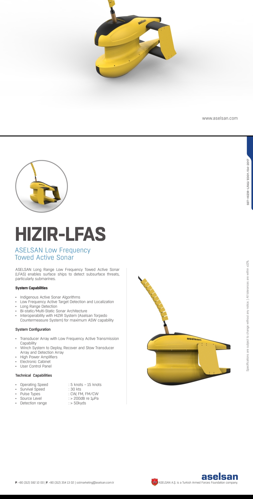

İ always thought they had stationed and towed sonars since they were ASW corvettes? So Do they have currently sonars or not? I'm shocked.
They have hull mounted sonar + dipping sonar on the deployed seahawks.
Hizir TKAS also have passive towed array sonar and can be upgraded with LFAS with ease.
Probably they are waiting for things to mature to apply an upgrade package.
LFAS is a towed low frequency system.
Yakamos / Fersah are hull mounted mid frequency systems.
TF-2000 will have hull mounted low frequency system.
