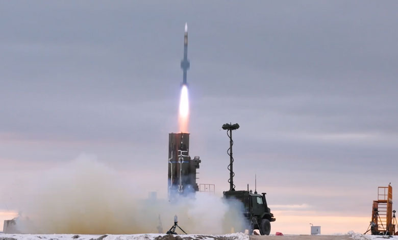

Hisar-RF is what Navy seeking forwards (with its latest form), and will be deployed on MIDLAS as Hisar-Deniz as ESSM replacement, however there is some other development with SAGE's G40 but i don't know what is that for, whether an in-house project or they plan something else. The Navy had joined the Hisar-RF project and Roketsan introduced an iteration on the form to make it for Navy's requirements.
From here we can further hope, Siper-Block I will be quadpackable as well (Since it is practically Hisar-RF+Booster) and it will boost air defense capabilities of the Navy.

If it has longer range as you claim, contrary to what the sources I shared give, can you provide sources that back up this claim please? You are correct. the block two version does not need illumination. But the given range is the same as Block 1.
Everyone speculate with certain logic that HisarRF should have longer range than what the SSB is giving. But at the end of the day it is just speculation. On paper, what SSB says, is valid.
according to below site, Hisar RF missile has a range in excess of 35-40km.
When talking about the range of a missile the altitude at which this range is achieved also plays a big part.
Can it be so that, we want our missiles to go as fast as they can and be still under engine power at the terminal phase, to guarantee a hit? Can it also be so that our given ranges are for highest altitude the missile can achieve?
These last two points will show a much more conservative range figure than, may be, under real life conditions.
Also one has to remember that these missile systems will be available to other countries. So the range of Export version and a local version, may not be the same. In fact, it should not be the same. Also the real range of the missiles used by TSK, should not be open knowledge to everyone.
essm has more than 40 km range and essm block 2 will have around 60-70 km range. So you say that hisar-o rf has same ranges or more than this figures? source?
Range alone means nothing. Altitude and range should be given together. Hisar-RF is "at least" similar in performance to ESSM 2. Hisar-RF has around 35km range at 10km altitude and at those values the missile still has enough kinetic energy(thanks to dual pulse rocket motor) to preserve its high Pk value. 40km figure for ESSM is for 8km altitude and since ESSM doesn't have a dual pulse rocket motor its Pk decreases when the missile approaches its maximum engagement envelope.

Hisar O RF IIR for navy, thinking loud and could be not based on facts:
- short range point defense - yes
- ballistic missiles - no
- discern low RCS targets - should be tested with simulations & target drone tests
- discern tartgets skimming over sea - should be tested as well
- high maneuver capability - should be enough for point defense
- long range - with booster yes, if booster can be fitted to national VLS major boost for Turkish navy
- high altitude capability - with booster yes, upper levels would need other means for control
- quadpack - depends on the diameter. Despite photos I could not calculate its diameter because other missile dimensions are also unknown. Probably similar to ESSM, between 200 and 260 mm diameter. ESSM has short aspect ratio wings, Hisar RF/Siper wings are bigger and could be hard to quadpack. Length is also a mystery for me especially with the custom booster. If we could fit the booster with the missile to Corvette sized ships it would be awesome
- big warhead - not enough to knock big and fast targets when pass distance is big
- speed - test videos suggest low speed at launch compared with other missile tests like Aster. Some of it could be due to low smoke propellants.
They always say. "We dont give up the exact range." Means more than official announcement.
Essm Block 2 has more range and altitude than your figures for hisar Rf.
4,336
276 22,718
Source?
Edit:
Yes correct. 40 to 50+Km ranges given for ESSM is more than what SSB gives for Hisar RF.
I misunderstood your above post. Sorry! I thought you were still on block 1 and block 2 issue; Because even Raytheon’s own site gives it as “around 40km” for both blocks.
Again what is the altitude? BTW ESSM-1 has a ~27nm (50km) maximum range at 5km altitude. 40km range is given for 8km altitude. ESSM-2 has also similar range altitude values. If you do the math Hisar-RF is similar to ESSM-1/2. 35km@10km, 40km @8km, and 50km @5km are the same thing.
