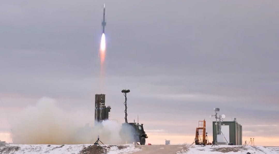

You don't really need a specific Hisar RF specification. Because it is essentially a Hisar O+ missile with RF seeker head. It uses the same propulsion.
Below site has Ismail Demir's take on the same where he is telling that the Hisar O+ fitted with RF seeker has been successfully fired.
