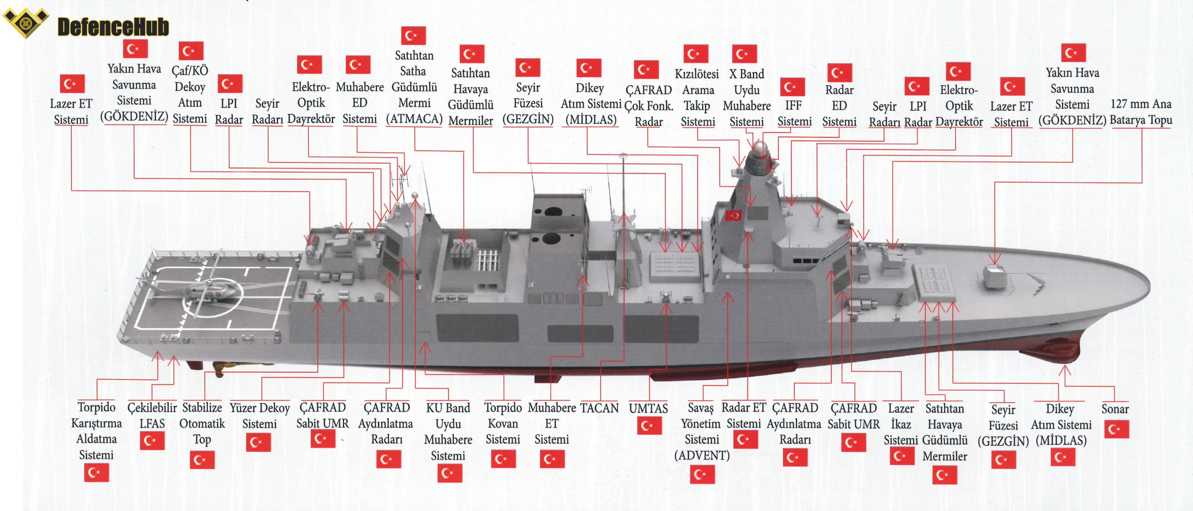

I am making some infographics and I would like to ask why the AREAS-2N ECM system equips the LHD but it was not considered suitable for the Istif frigates and instead they will be fitted with the less capable AREAS-2NC (four antennas)? I have seen also maquettes from IDEF 21 where Istif-class is fitted with both AREAS-2NC and AREAS-2N which doesn't make sense.
Happy New Year,
It wasn't as 'not found suitable' but back in time Navy was looking an effective system at affordable prices by applying minor changes on Ada Class to create the I-Class. At some point i don't know what happened, the Navy was given a go to for a different design and a contract was signed with STM to conduct design studies altogether with design project offfice. At the first design (before the contract) they placed the EA on side of the bridge to cover as much as possible, without modifying the existing mast and the EMI scheme.
However, DPO is known to abuse such instances and they instead went for a design nearly overhauled the sensor suite in comparison to Ada class at greater prices.
I can't evaluate the up or downs or what Navy considered while opting for cassegrain and omitting the phased array but i know even at the current form the phased array (AREAS-2N) can be integrated on the AREAS-2NC position if found necessary (it was designed as such).
Also i doubt if the spot on sides of the bridge is made to support AREAS-2NC with the current update. All coolers and cabling are mainly around-in the new mast.
So, the final design is what available in STM's brochures (with minor changes), the mockup with both AREAS 2N and 2NC is not accurate.

This is the final:
TF2000, not a double post, a HD version of what is being circulated among the media.
The image, above, was posted at IDEF 21. However some changes took place since then. The old image shows AREAS-2N as the EA system but Navy's armerkom is pursuing for planar arrays with stronger jamming capability.
Also there will be C-ESM and C-ED system on top of rear antennas (C-ED is already present but it is merely a place holder). They have gone for simplistic C-EA but i expect a better one, considering it was a place holder.
At some point they have considered an integrated antenna similar to Japanese Mogami, to combine LOS communication with for UAVs or USVs, C-ESM, TACAN within a unified antenna for the middle antenna position, but the time is limited for R&D.
The antenna holding C-ESM-ED (most rear antenna) is definitely being made to support a low frequency (L / VHF depending on block) Early Warning radar.
