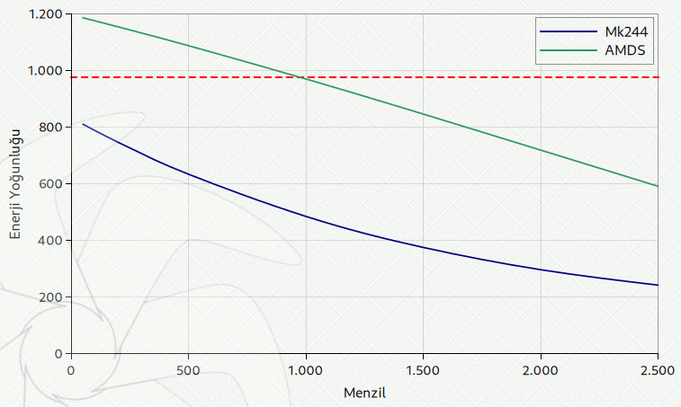

Uskudar's new writing on CIWS systems used on Barbaros-class
Quick Translation
20mm / 25mm
Barbaros-class modernization includes replacing 3 Sea Zenith with 1 Gökdeniz and 1 Phalanx
Using two different systems for CIWS can be considered problematic and thinking it can be a alternative to Sea Zenith would be optimistic.
The reason Navy wanting to replace Sea Zenith is because inability to integrate it with other electronics, software and very high price of replacement parts rather than issues against neutralizing targets.
Phalanx uses 20x102mm kinetic energy ammunition for anti-missile.
Depleted uranium based MK149 Mod 2 was replaced with Tungsten based Mod 4 ammunition due to risks. Current ammo type that is used by Phalanx for anti-missile roles is MK244 Mod 0 APDS.
Sea Zenith uses Tungsten based 25x148mm AMDS ammo for anti-missile.

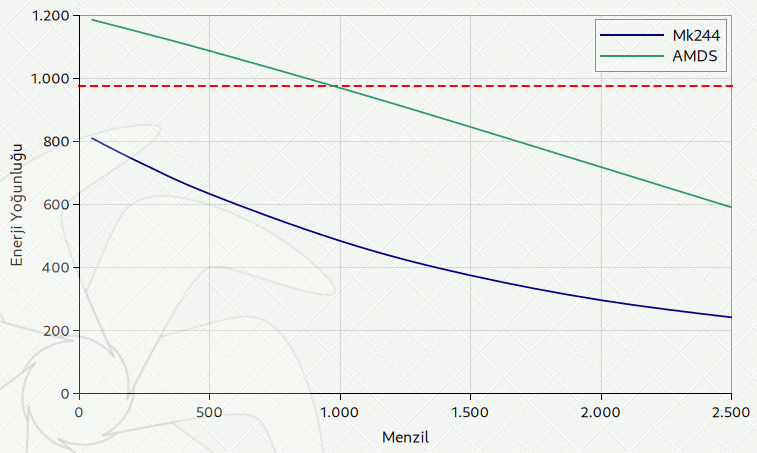

Energy density of the anti-missile ammos over distance
Energy of Sea Zenith ammunition is enough to completely get rid of the missile threat while energy of Phalanx ammo is only enough to damage. For example, if a anti-ship missile gains ballistic momentum, Phalanx might not be able to stop it depending on damage level on the missile and where the missiles location.
Conclusion:
1) Phalanx is not enough the meet the needs of Turkish Navy, even if it were to be given for free it should be nationalized as it is the last defense against threats
2) Country like Turkey needs much bigger Navy, because of this there should be no dependence systems such as this.
3) Gökdeniz might be a capable solution, if not it should be under development
It is inaccurate to compare two CIWS rounds based on their kinetic energies at certain distances and claiming Phalanx is not carrying enough energy to pierce through warhead of an anti-ship missile.
There is something called dispersion, rate of fire which ensures certain amounts of rounds are engaging the target
If Phalanx was ineffective we wouldn't have been seeing it on US warships at first place.
Zenith is aged, sensors are out of the date, the best way to use from this point on as only remote control weapons. And it was spoken in earlier posts why Phalanx was probably chosen for above the hangar.
