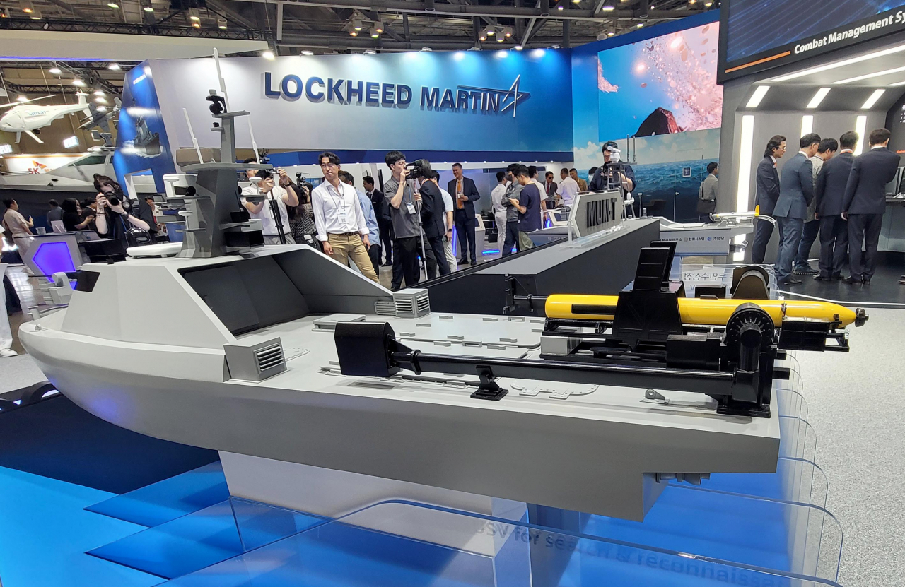

To counter Hellfire, Spike and other NLOS I think instead of a CIWS we need some manpads, anti-UAV solutions and better sensors to detect carrier of these threats and a USV will work dearly for the case. I think the winning part of an upgrade will be the addition of a USV on NTPB.
USV (with sonar or Sungur depending on the mission), Sungur-Levent launcher, MAR-D or scaled down ARDA (CENK-300N)* and CENK-100 or AKREP-200N* for better target tracking and maybe ORKA/TORK torpedo could be the maximum of a possible MLU. Also i believe in a pure HAS mode Levent missile can attain longer ranges.
*These will be luxury if happens.
I think if TORK goes through and a miniature torpedo is introduced after the project, these can be used with UAVs similar to how Corvettes/Frigates use helicopters to deliver a dipping sonar and torpedo bundle to hunt and kill.
