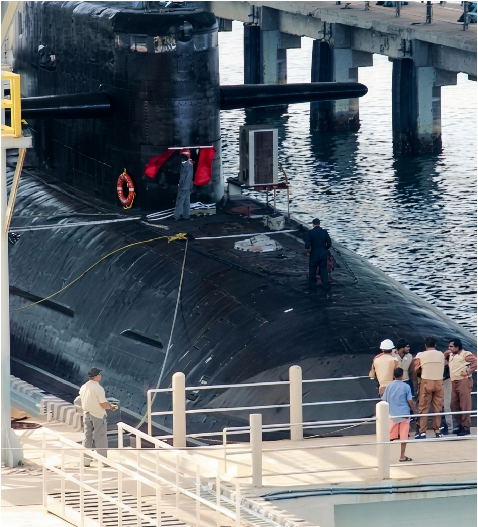

The 3rd Arihant-class nuclear-powered ballistic missile submarine (hull S4, pennant SSBN-82).
The S4 marks the advent of the "Arihant-Stretch" sub-class. Biggest outwardly visible change being the expansion of missile launch cells from 4 to 8.

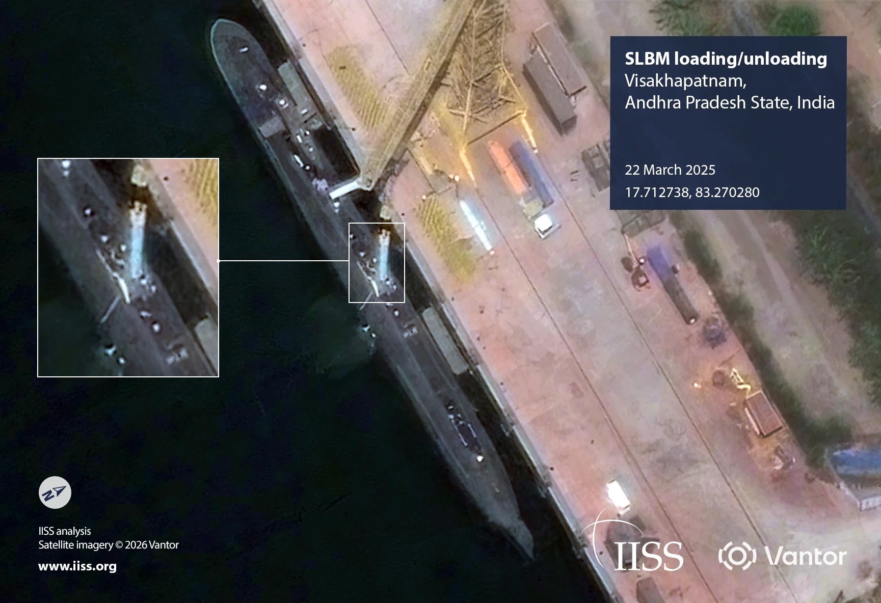

Good article from the IISS (International Institute for Strategic Studies), credit to Joseph Dempsey & Karl Dewey:
There's lots of interesting satellite images (via Vantor) and information, here's some excerpts:

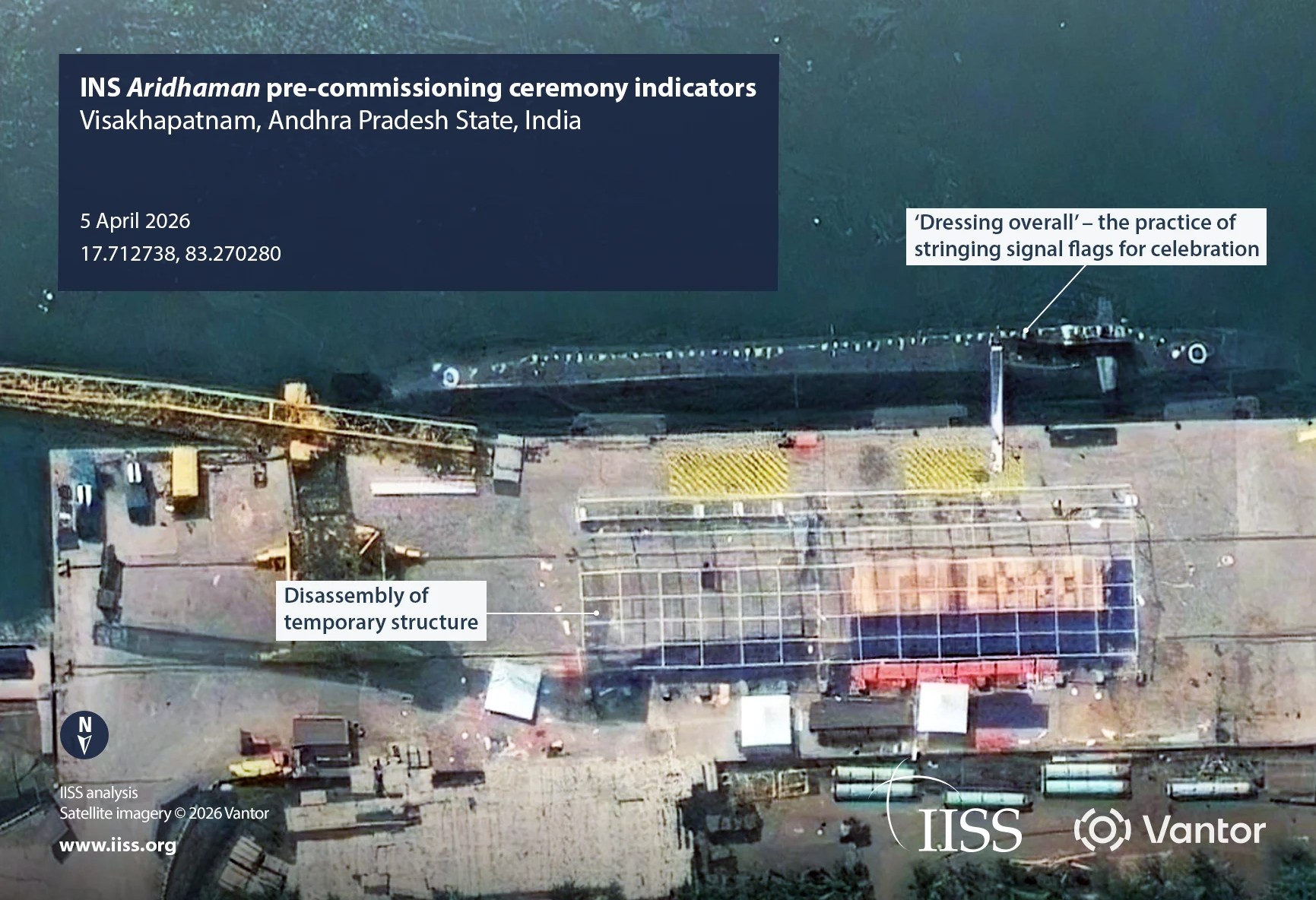

"On 3 April 2026, the Indian Navy commissioned INS Aridhaman (S4), its third nuclear-powered ballistic missile submarine (SSBN), at Visakhapatnam on the Bay of Bengal.
Despite widespread reporting by local media, there was no official confirmation, with New Delhi remaining secretive about its growing SSBN capabilities. Nonetheless, satellite imagery analysis by the IISS corroborates reporting, with imagery from 5 April showing an SSBN – almost certainly INS Aridhaman – with maritime signal flags strung along its hull. Known as ‘dressing overall’, the practice is reserved for special celebratory events."

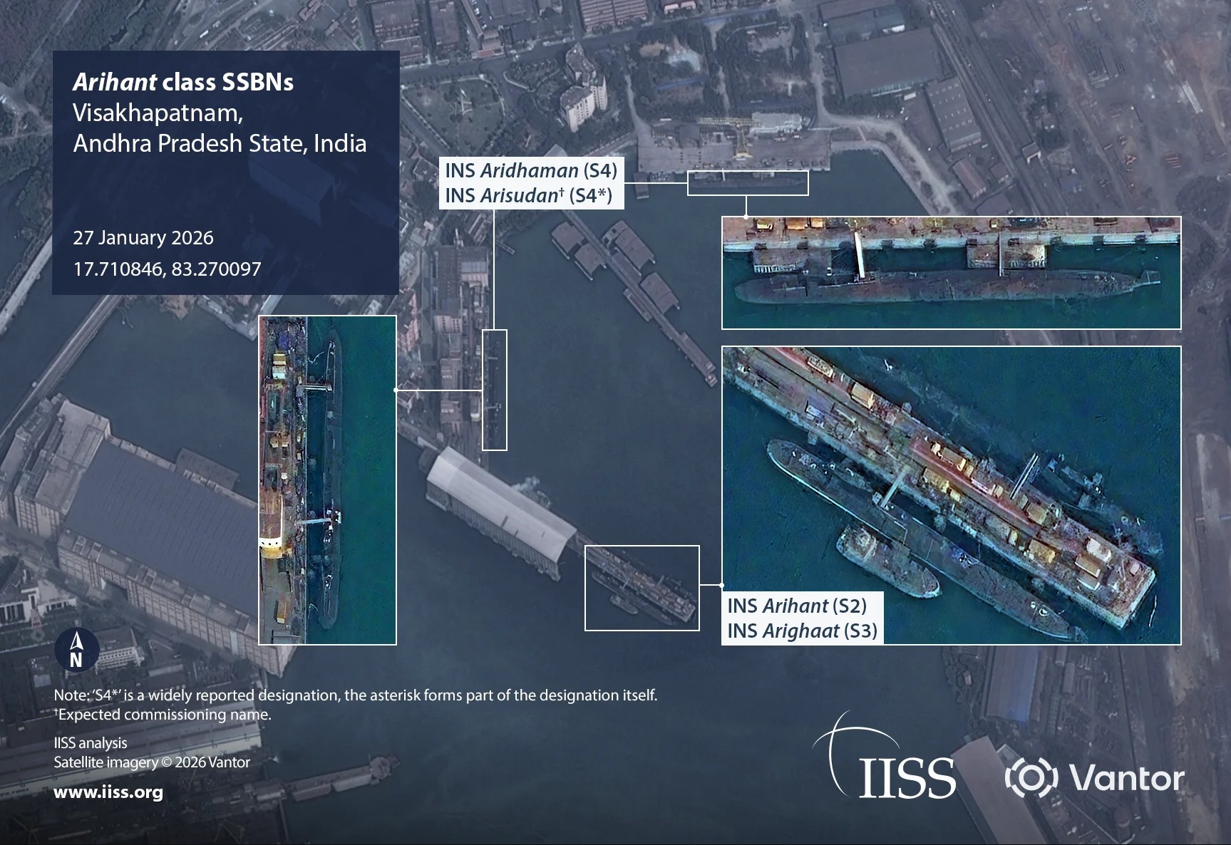

"Assessments regarding the status of India’s naval deterrence are mixed. Indian authorities credit their SSBNs as having undertaken ‘deterrence missions’ – with the lead boat Arihant completing a first patrol in late 2018. However, their growing fleet is not yet fully operational in a commonly understood Continuous At-Sea Deterrent (CASD) role, with imagery from January 2026 showing all four hulls alongside at Visakhapatnam."
"Though a continuous patrolling cycle is theoretically possible with three boats rotating between patrol, repair, and training, this leaves little redundancy or flexibility, especially considering that each stage is likely to vary in duration. Commissioning S4*, potentially in 2027, will ease operational pressures and allow at least one boat to be continuously on patrol. In conjunction, the other SSBNs can progress through repair and training cycles while the fourth boat remains in reserve, in case of operational or technical issues.
As such, only once all four Arihant-class boats are commissioned will India have the foundations for a robust nuclear triad, though purists may go further and insist that, because of the seeming capability differences between the Arihant class’s two batches, Indian strategists may need to wait for the S5s to enter service before the navy has an undeniably robust CASD. In addition to the boats themselves, other factors, such as India’s evolving submarine-launched ballistic missile (SLBM) capability and growing Very Low Frequency (VLF) communications systems, are also key to a survivable second-strike capability."

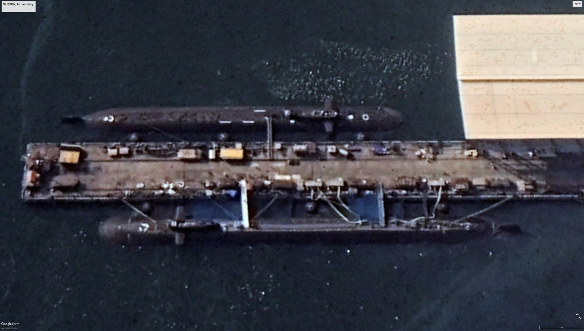

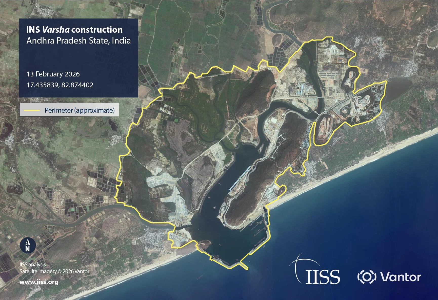

"Visakhapatnam has been home to India’s SSBNs for several decades, with the four Arihant-class boats all constructed, fitted out and operating within close proximity. Housing an SSBN base within a wider congested port complex may pose operational and physical security challenges, with mobile floating shelters providing limited concealment and little in the way of protection.

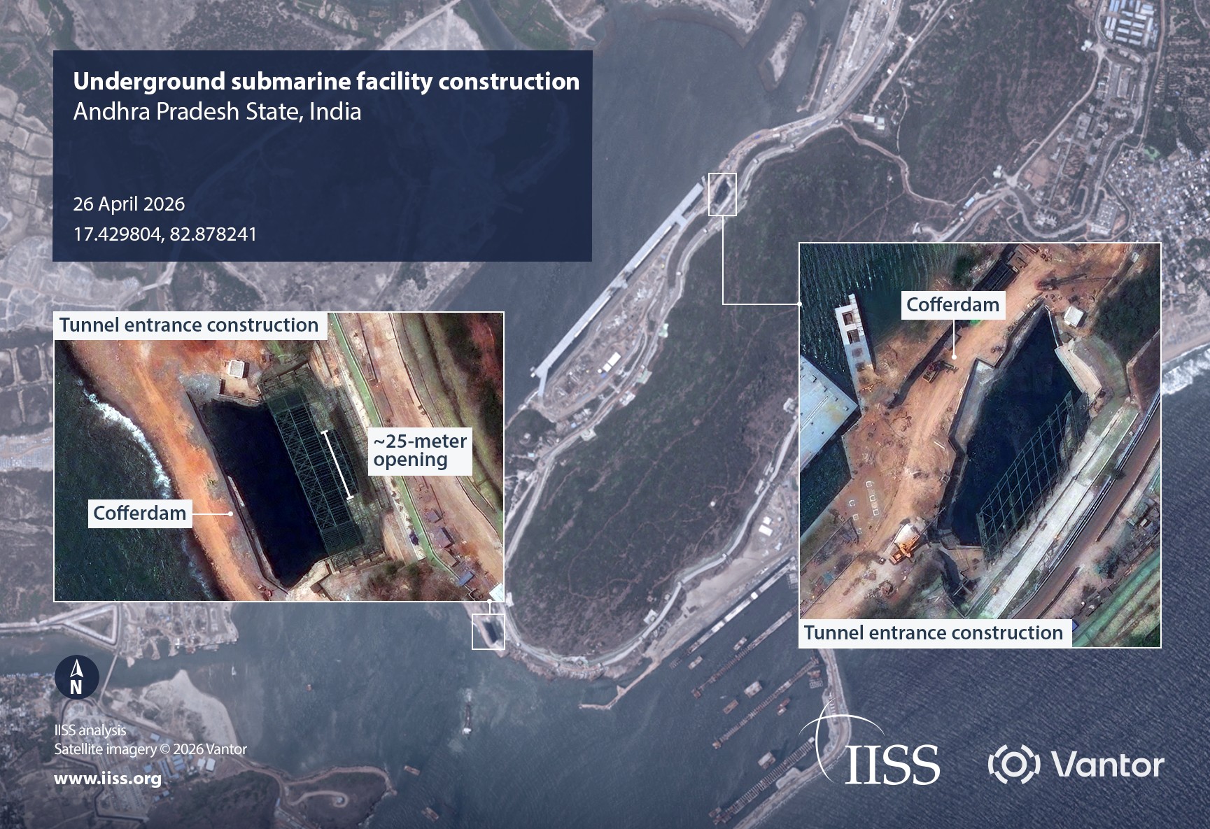

However, over at least the last 15 years, work has been slowly progressing on a more remote and secure home, some 50 km south of Visakhapatnam. While the new naval base, known as INS Varsha, is expected to host other elements of the Indian Navy’s Eastern Naval Command’s growing fleet of surface combatants, it is expected principally to serve as a nuclear submarine support facility for India’s SSBN fleet. In addition to the existing fleet, INS Varsha seems prepared to accommodate India’s next generation of SSBNs, with two S5 SSBNs already under construction at Visakhapatnam, according to local media."
"Information on the secretive base remains sparse, but one element that is increasingly apparent from satellite imagery is the widely reported construction of an underground submarine facility, with two large tunnel entrances visible. Recent imagery indicates water within the tunnels, suggesting completion of the waterway, and a logical next step would be to remove the cofferdams used to hold back the water during construction. Though the layout of the facility is not clear beyond these two – presumed linked – water entrances, some 1.5 km apart, it is also ringed by over a dozen apparent road-access tunnel entrances, indicating the potential for a much vaster underground support complex for SSBN operations."
"While housing the facility underground provides additional natural protection for berthed submarines and infrastructure, it also aids in the concealment of deployed numbers from space surveillance. There are numerous precedents for underground submarine basing, and this is a feature of China’s People’s Liberation Army Navy base at Hainan Island."

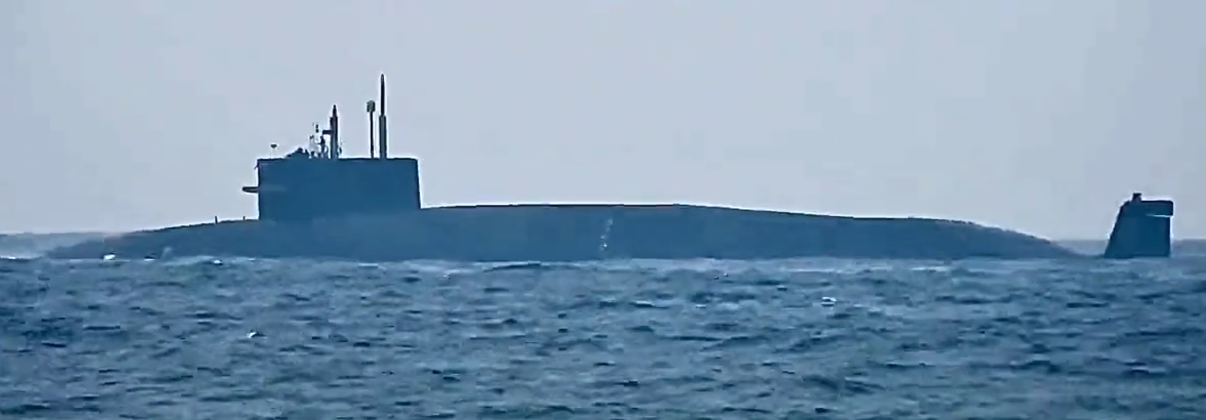

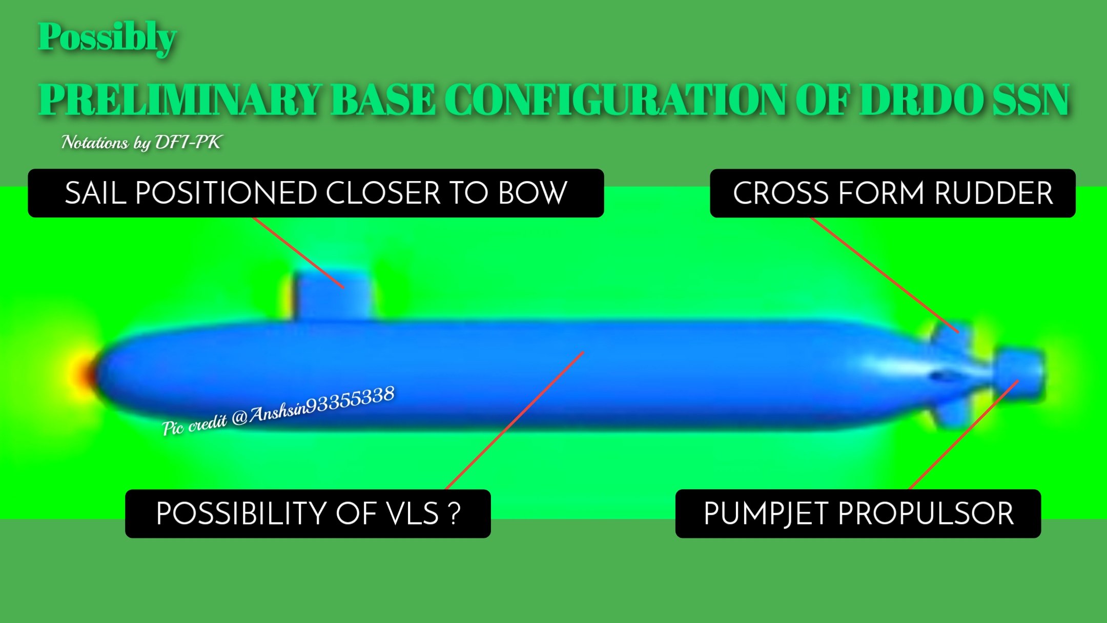

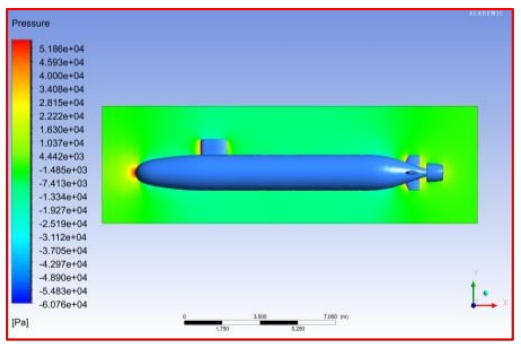

So apparently, NSTL is testing this design, lack of a missile hump implies this is an SSN:
It does not necessarily mean that the upcoming Project-75A/76 SSN will have a pumpjet, or that this is indeed the indigenous SSN design (could just be a case-study of a generic modern SSN boat). But it's definitely interesting.

Knowing what we know now (confirmation of ~10K tons, VLS & what not), I think it might be worth it to take a second look at this design that NSTL was testing a while ago:
Overall configuration appears to be quite similar to the Virginia-class (sail-forward design, crossform rudder, pumpjet).

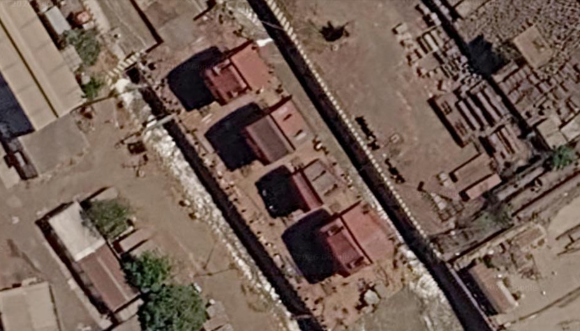

Member 'Project IGI' on another forum made an interesting find!
Modules/hull segments of what could be the first S5-class SSBN were spotted at L&T's heavy engineering facility in Hazira (the place where modules of nuclear submarines are built).
We cannot be 100% sure if these S5 modules, might as well be some unrelated ship/engineering project (L&T builds a whole lot of stuff, military & civilian, at this complex) but the shapes are certainly interesting, especially the 3rd one from top.

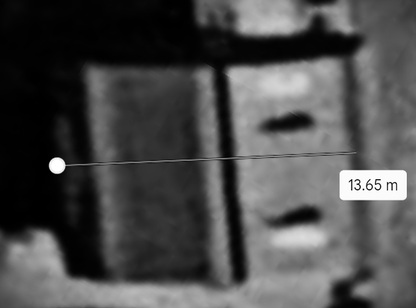

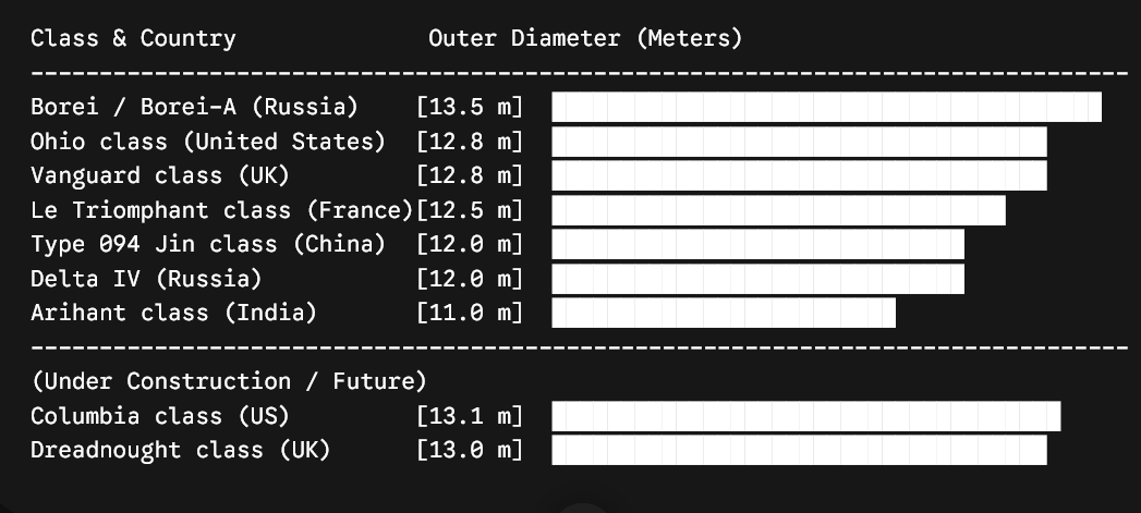

'Project IGI' also made measurements of the width/diameter of one of these purported hull sections:
Pretty huge! He also made a comparison with other contemporary SSBNs. The closest would be the large Borei-class:
I had previously written that the first two S5-class hulls were already in production as of late 2025:
So the timeline matches.
