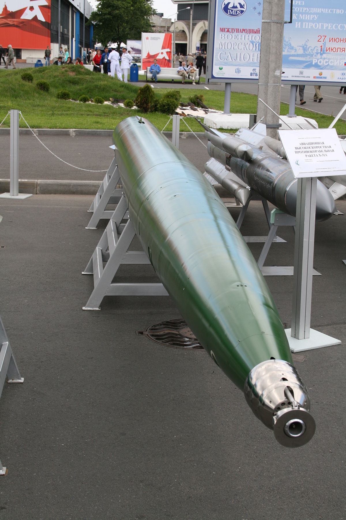

Here i found the solution.
Using RAM launchers you launch very light mini torpedo with rocket assistance.
SeaPike is compact.
Diameter 124mm
Length app 2m
Weight just 35kg with booster!!!
İndeed those were designed for RAM launchers!
Torpedo diameter 124 mm, so RAM launchers are enough to be fit .
We should put on every corner of MİLGEMs 4x GÖKSUR launchers . 3 ASROC + 6 SAMs.
Thanks to rocket flies 8km, than in 500meters hits.
The advantage is very short reaction time.

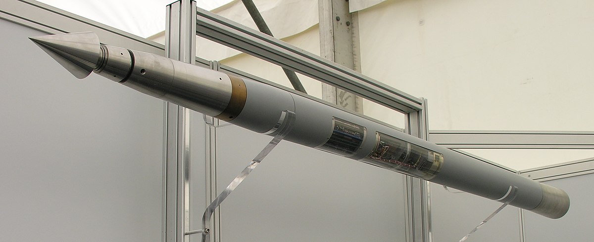

BTW Apart from this anti submarine rocket, this program evolved in USA very light torpedo program.
For UAVs , USVs, they created 100kg weighted, 180mm diameter , 2 m lengght mini torpedo with 11 km range.
Our USV and YTKB must have such very light torpedos.

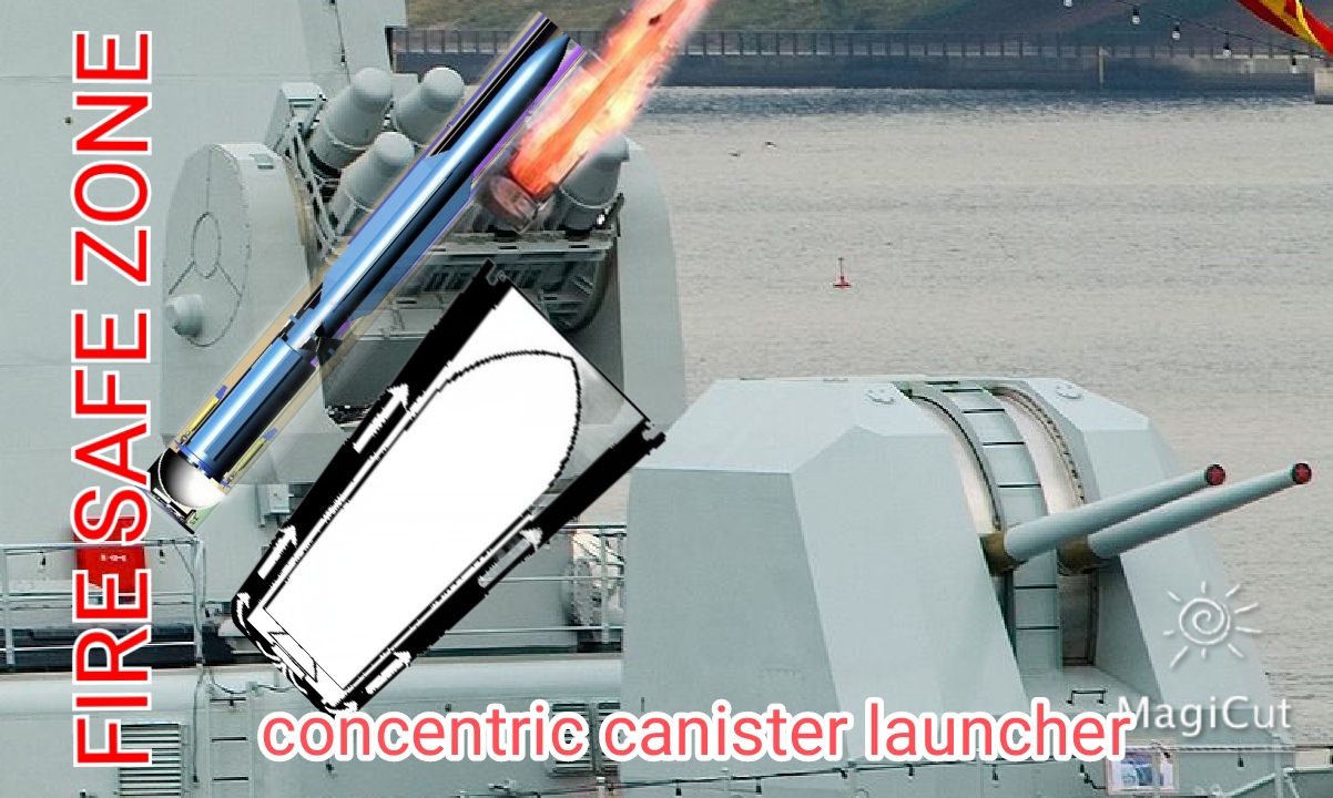

I invented a system where you can place as many missiles as you want anywhere on the ship, eliminating the danger of fire, which is the most important threat to warships.
congratulate me.😂😂😂😂
You don't need very expensive navsl VLS.
Geminin üzerine yangın tehlikesi yüzünden koyulamayacak yerlere koyun bu lançerleri. Önlerine de sabit AESA plakaları. Ohh her yere koyun.
Bundan sonra oraya lançer konmaz orası yanar tehlikeli demeyin:)

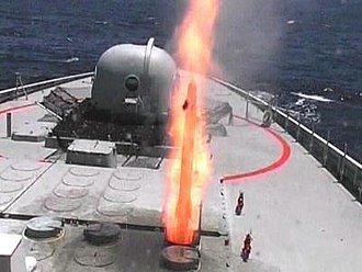

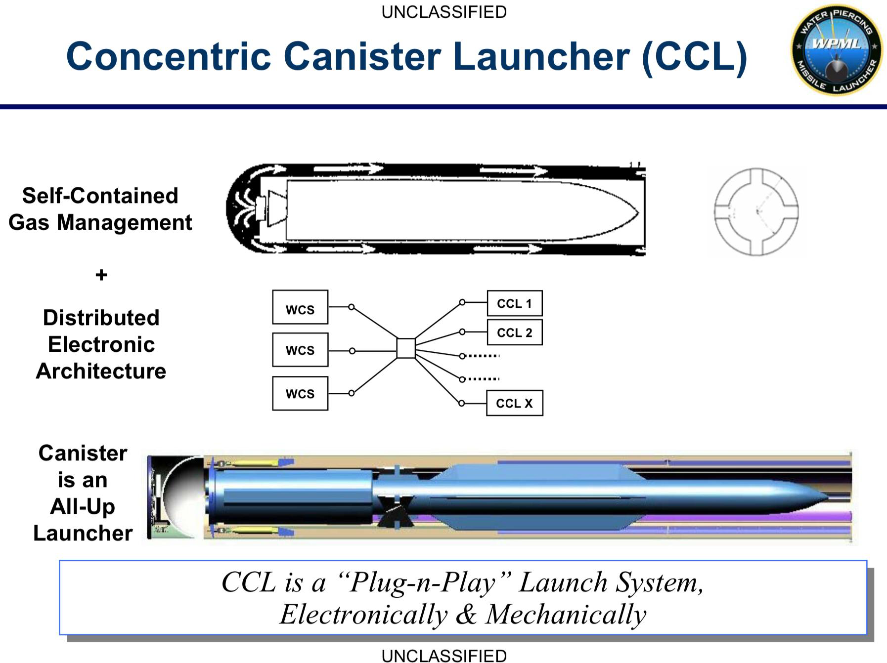

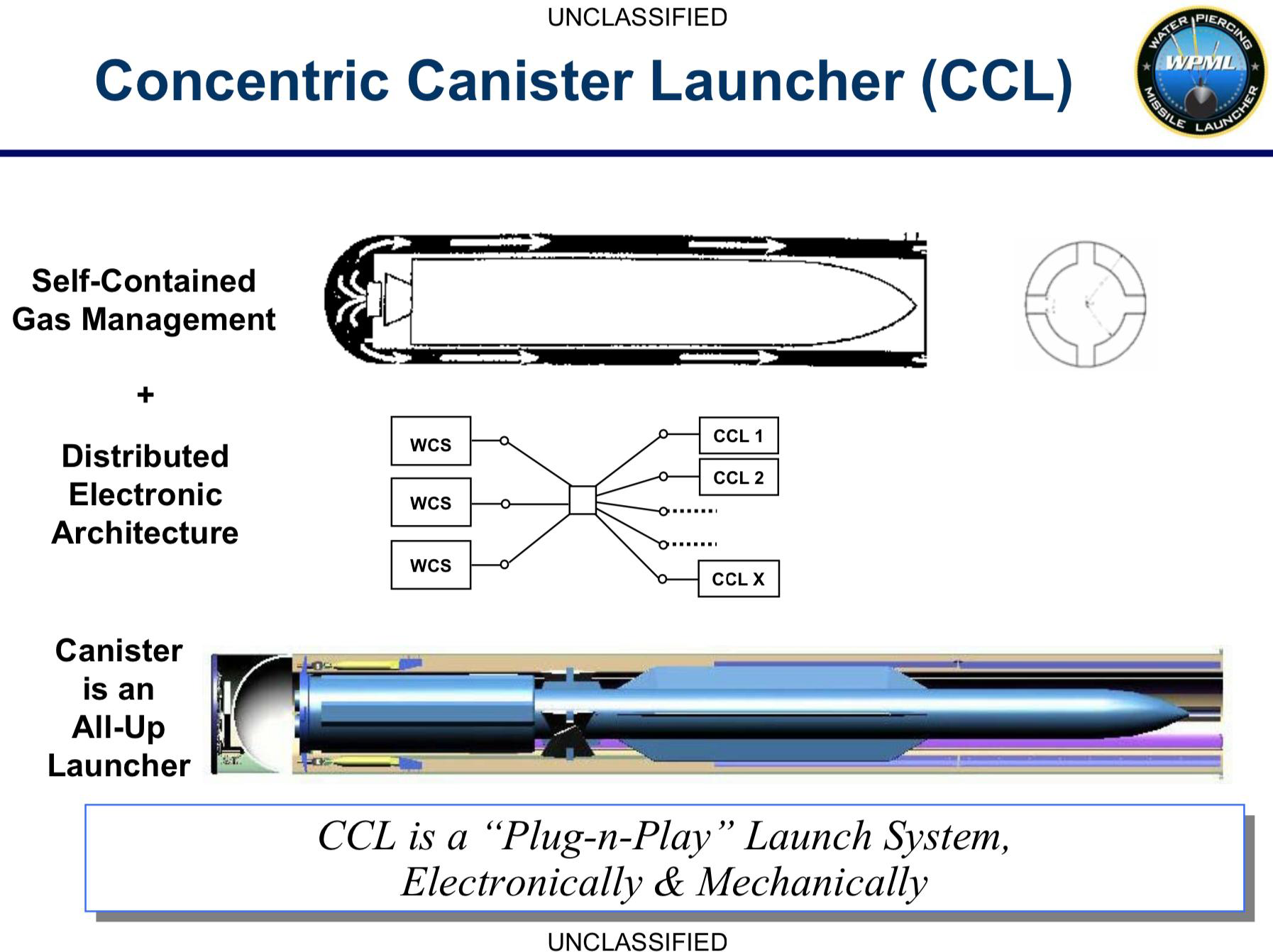

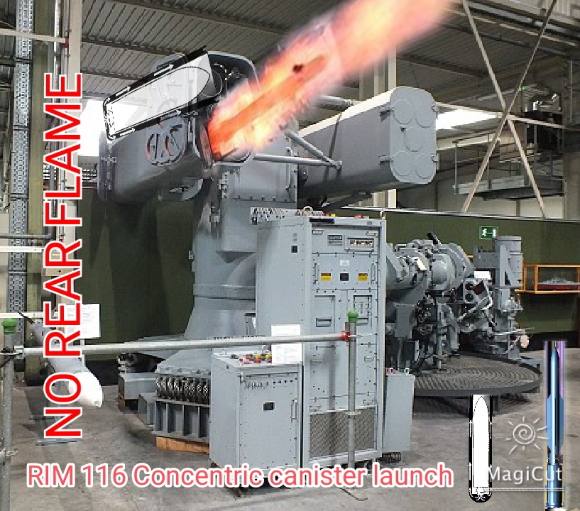

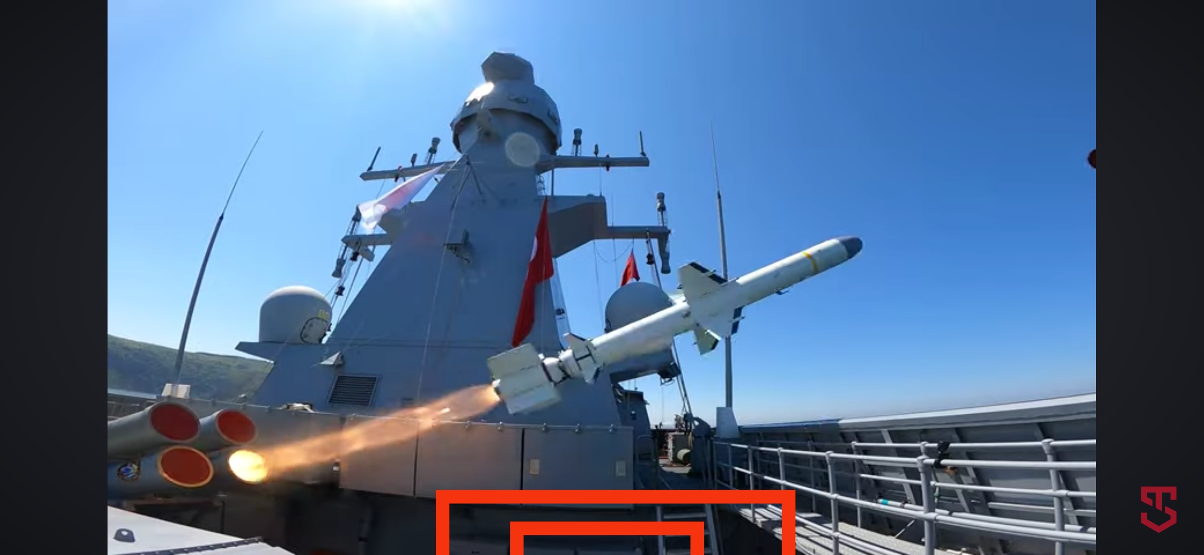

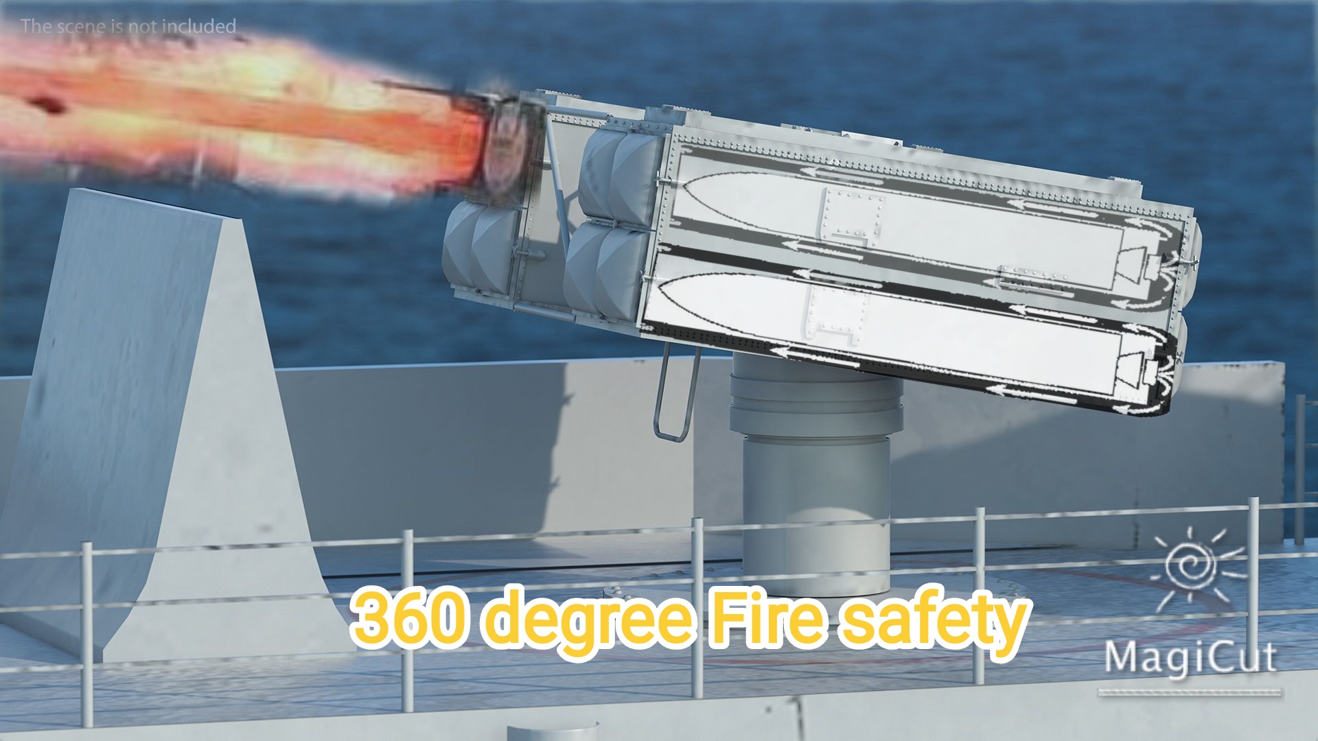

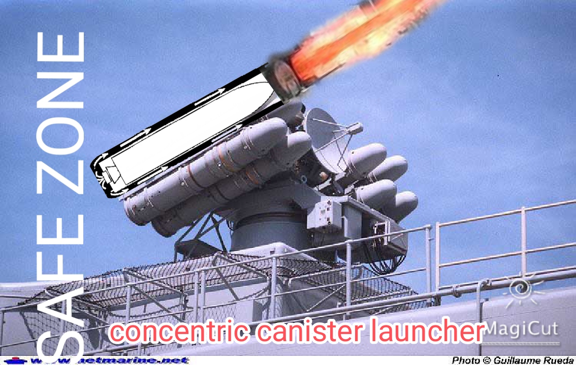

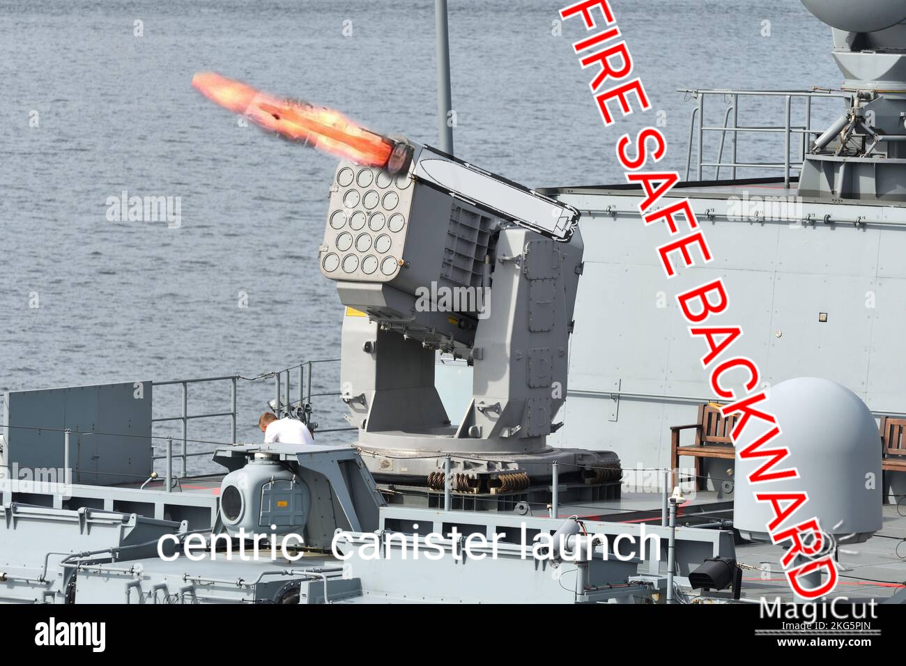

First i would like to explain what the concentric canister launcher:
Umkhonto SAM uses this VLS.

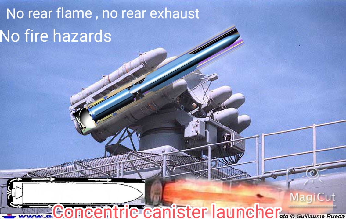

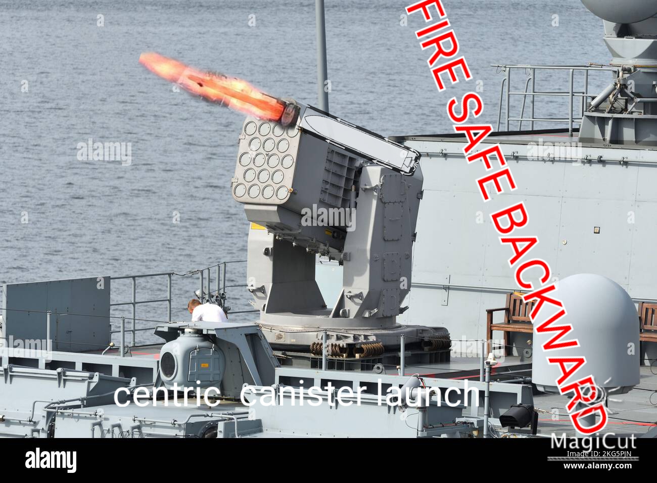

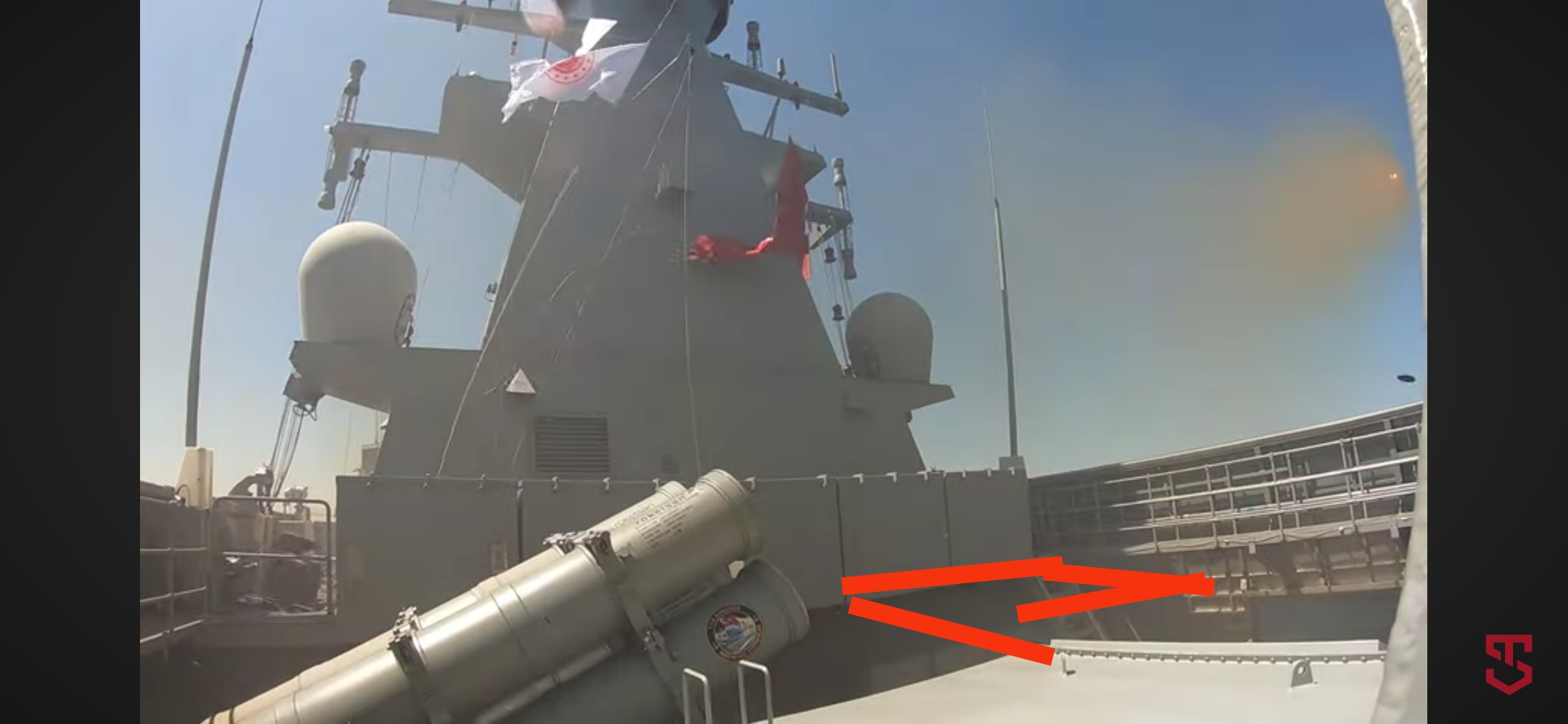

İ have been thinking about limitations of RAM, Levent,Göksur naval launchers due to fire hazards.So i might have solved this problem.
Even those canister could be static if you use Datalink.

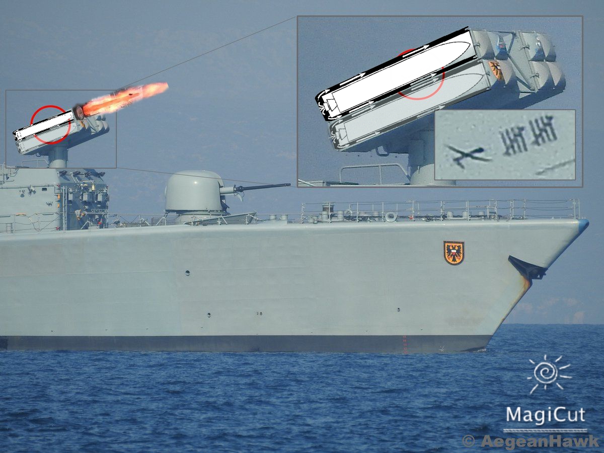

Could UMTAS or Bozdoğan missiles be damaged if they were launched in such a way?
On the other hand this launcher should be bulky or missilemcapacity of the launcher should be reduced. Anyway it is much more cheaper than VLS, and safer than horizontal launchers. You could use every point of your warship.
Most probably with Gökdoğan missiles it would look like as same as Mk29 launchers. BTW we could upgrade old warships with consenteric canisters.
So we could have rotating VLS😎

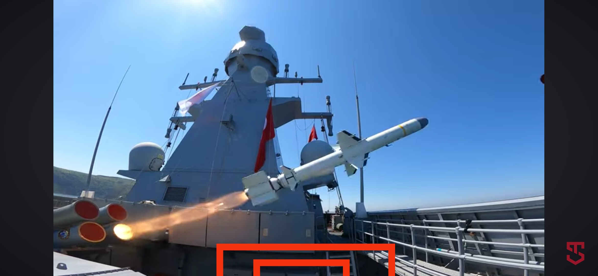

Absolutely it would be useless. Levent and RAM are same shit. No difference. Levent can lock just line of sight . You cant preset fly path before or after launching. But Bozdoğan before launching cannpreprogrammed from radar data. Also future models will have Datalink. More range, higher altitude, heavier warhead in compact shape.
[/QUOTE]
Additional two STAMP or UMTAS launcher.
You can not stop Kamikaze unmanned surface vessels with STOP. Just top attack UMTAS could.
