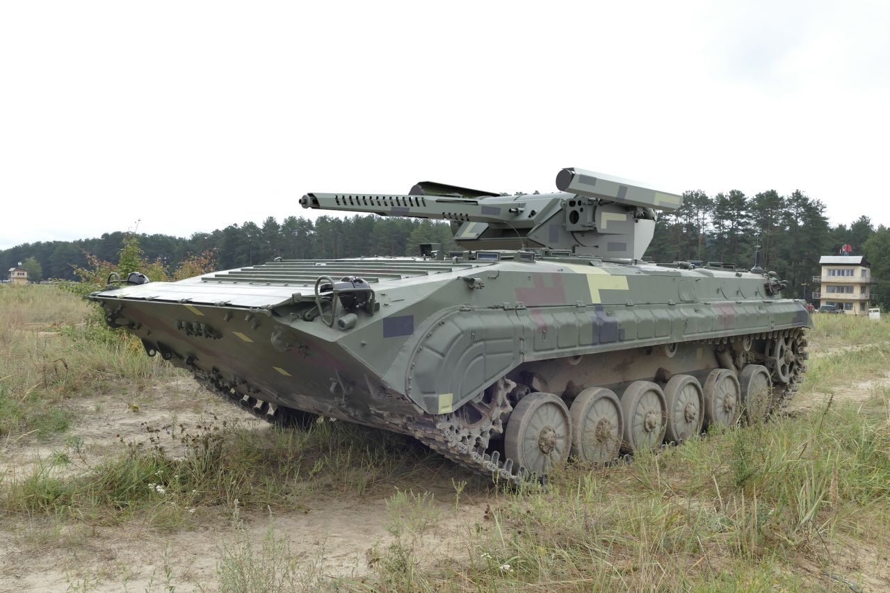

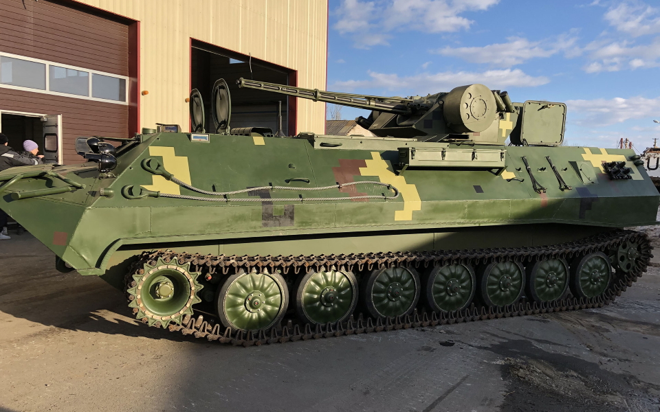

In Ukraine, new remote-controlled combat modules for armored vehicles - "Will" and "Will-D", which were developed by VAK "Nova Technology" (Nova Technology).
This was reported by the Ukrainian military portal with reference to the founder of the Defense Blog site Dylan Malyasov , who published photos of the modules on his Facebook page.
In October 2020, the AFRICA Intelligence website wrote that the modules developed by Techimpex LLC and its subsidiary Nova Tehnologiya were offered to Egypt and Uganda as a program to modernize Soviet equipment.
According to the site of the developer, combat modules - designed to combat armored and unarmored, ground and low-altitude non-speed targets.

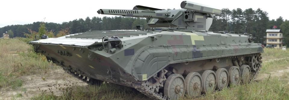

The private company showed a new combat module Will-D BMP with the combat module "Will"
The fire control system and the digital stabilization system of BM "Volya" / "Volya-D" provide guidance in the horizontal (360 °) and vertical planes (- 5 °… + 45 °), support and effective destruction of ground, air and surface targets during the day and at night, when shooting from a place and on the go.

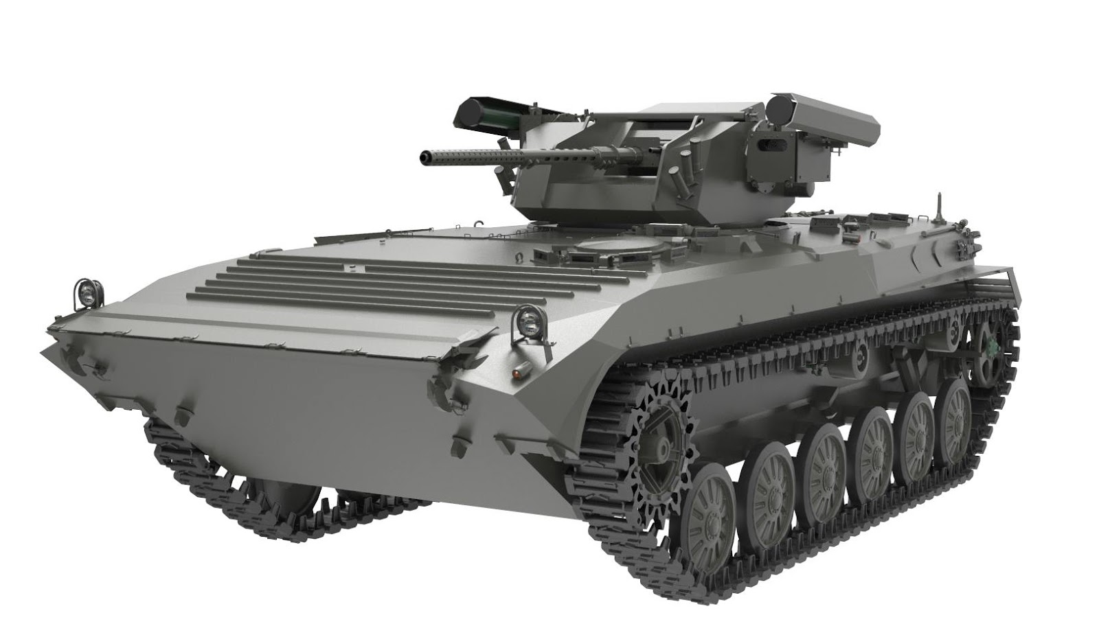

The private company showed a new combat module Will-D BMP with the combat module "Will-D"

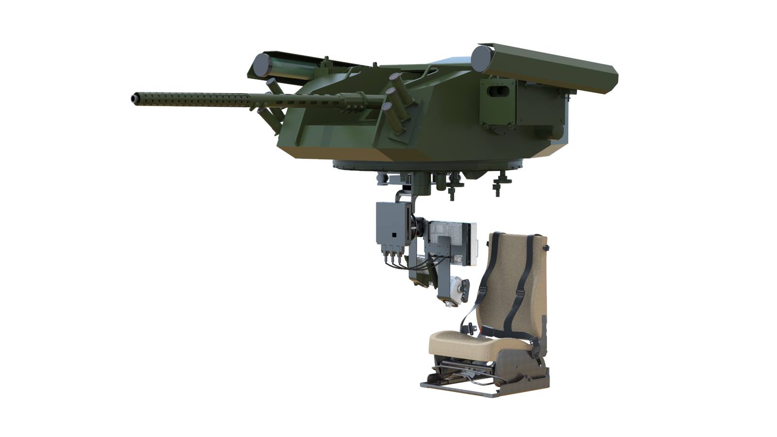

Work with the module as part of the combat vehicle is carried out by the operator and the commander (the commander has duplicate controls).
All components of the module and ammunition are placed inside the module above the body of the combat vehicle, the operator's workplace can be located anywhere in the machine.
Composition of the combat module "Will" / "Will-D":
1. Arms tower:
  • 30-mm automatic gun - ZTM-1 (2A72), ammunition 290 shells (all shells are ready to fire), BM "Will-D" - 320 shells
  • 7.62-mm machine gun PKT, 2000 rounds (350 rounds in the store ready to fire)
  • 30-mm automatic grenade launcher KBA-117 (AGS-17), 116 grenades (29 grenades in the store are ready to fire)
  • ATGM "Barrier", 2 launchers, 4 ATGMs (of which 2 ATGMs on guides, ready for launch)
  • system of installation of smoke curtains 902B "Cloud" (6 PU)
2. Fire control system (SLE)
  • operator panel;
  • commander's console;
  • BOOM control unit;
  • opto-electronic module (day channel, thermal imaging channel, laser rangefinder);
  • video monitor of the operator;
  • video monitor of the commander;
  • PN-B guidance device.
3. Arm stabilizer
Length of BM "Will" ("Will-D") with armament - 3780 (3700) mm, without armament - 1780 (2120) mm. Height - 820 (750) mm. Width - 2150 (1880) mm. The diameter of the shoulder strap is 1350 mm
The level of ballistic protection of the module corresponds to STANAG 4659 level 2 - frontal projection, lateral projection, rear projection from BZT bullets caliber 7.62x39 mm. The weight of BM "Will" ("Will-D") is with ammunition - 2000 (1600) kg, without ammunition - 1550 (1150) kg.
With additional booking for STANAG 4659 level 3+ - frontal projection, side projection, rear projection from B32 bullets caliber 12.7x108 mm, combat module "Will" ("Will-D") will weigh with ammunition - 2250 (2100) kg, without ammunition - 1800 (1650) kg.
