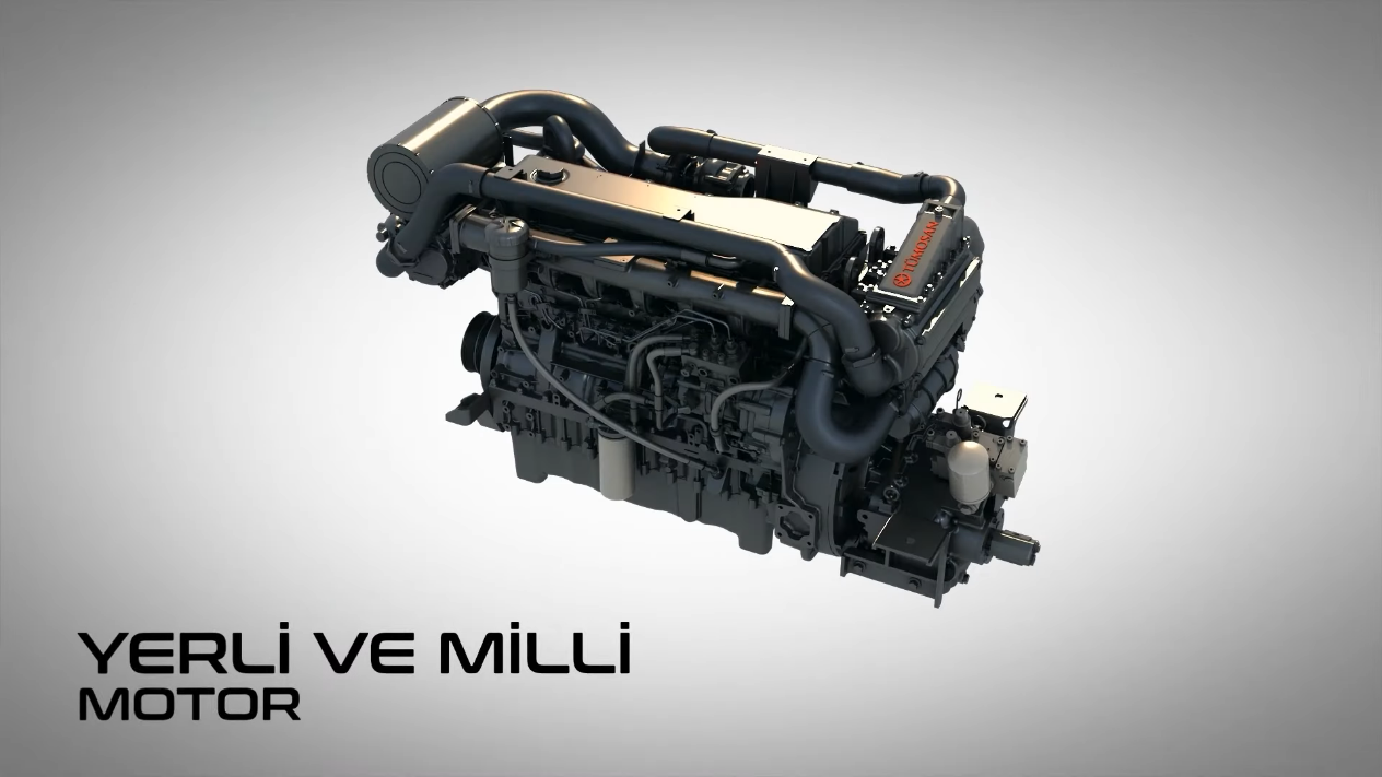

National high speed marine diesel engine by TUMOSAN.
To be certified for naval uses.
Specs? 105 HP or new one?
This is a new one, based on TTZA engine, whichever engine it was based on, add 40% power thanks to the water cooling. Not sure about the power but should be 500-600 or even higher.
500 HP and above is very good number. Our yacht companies can also use this engine instead of man engines or Volvo engines that they mostly use.
They need to take a long way to target yacht business. But unmanned platforms and mass produced inspection boats or patrol boats are very good to begin with to gain experience.
They seem to target up to 10000 HP engines but not sure how doable at the moment. That would be sufficient to provide up to 4000 HP currently.

Wow! Is this the actual prototype?
