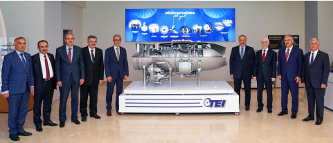

"@TEI_TUSAS Genel Müdürü Mahmut Akşit: "TEI-TS1400'ün bütün fikri mülkiyet hakları Türkiye'ye ait. TEİ'ye ait değil."
No, Mr. Akşit did not say exactly that. "All the rights of the Ts 1400 turboshaft engine belong to our state. Of course, it belongs to the Presidency of the Defense Industry on behalf of the state," he said.
There is no difference except saying the same thing in a different way.

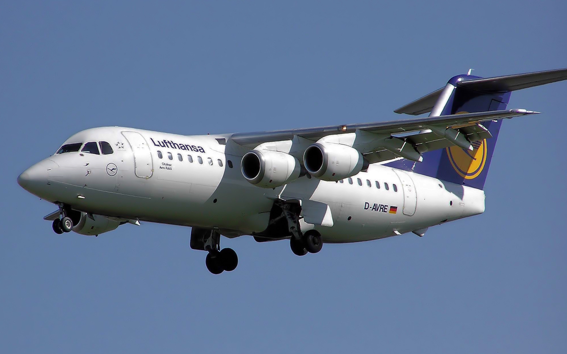

Is there any possibilty for return to national regional passenger aircraft project and new light cargo aircraft project with help of tei tf-6000 turbofan engine ?
Dornier Jet 328
Erj-135 Lr
They can caary 35-40 passenger and their engine have similar thrust with Tf-6000
British Aerospace 146 can carry -+ 100 passenger and carry a 4x engine who have similar thrust with Tf-6000
All of that aircrafts have enough ranges for regional .
And if we use 4x Tf-6000 we can make a Kawasaki c-1 kind local jet cargo aircraft for , awacs, cargo and air refuel etc.

TF6000 is a military class engine. It is not really suitable for passenger aircrafts. Military class engines are low bypass engines that are more akin to turbojets. Passenger planes use turbofans with high bypass ratios. Not taking in to account the certification issues, a passenger aircraft’s turbofan has a much larger fan than a military engine’s.

I understant thanks. But is it hard ? So I mean making a high bypass turbofan ? With core of tf-6000 or entirely new core ?
It is sooo hard for Turkiye.
In two perspectives, it would be a very very difficult and even impossible task for TEI.
a) While there are military turbofan projects such as the TF-35000 that need to be completed very urgently, we cannot allocate qualified personnel and capital to that project.
b) TEI is currently the largest producer of foreign civil jet engines parts such as LEAP Engine parts. Why would TEI, which has suffered serious financial damage due to Covid-19, risk this position?

At some point the design team of TEI will be relieved from work on the design of the TF35000 engine which is when they can and will be willing to take on new challenges. I would give it 3 years for TEI to start work on a relatively high bypass engine to power relatively fast subsonic planes.

Commercial + civilian mass production side, it is best if Turkiye perfects it turboshaft and turboprop and work through MRO feedback cycle to develop reliable name there.
Only with that done can commercial turbofan follow in optimal way, otherwise you will throw too much money at it for little market return (given long term costings airlines look at), I can guarantee that.
This is large part of why Russian engines did quite badly in the end in world market (even in their own domestic market) even though they had all classes of engines unlocked quite a long time by Soviet legacy.
You need to ramp up and develop reliability + proven cost efficiency in the larger sense in the aircraft hangar side especially.
