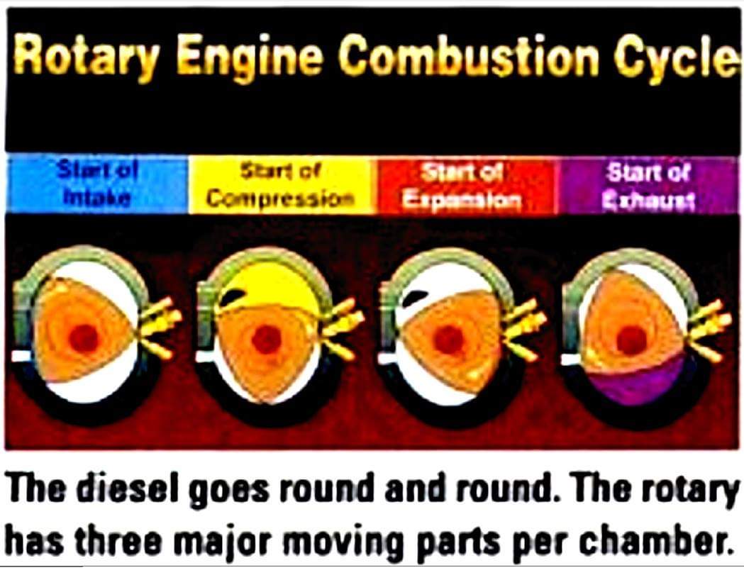

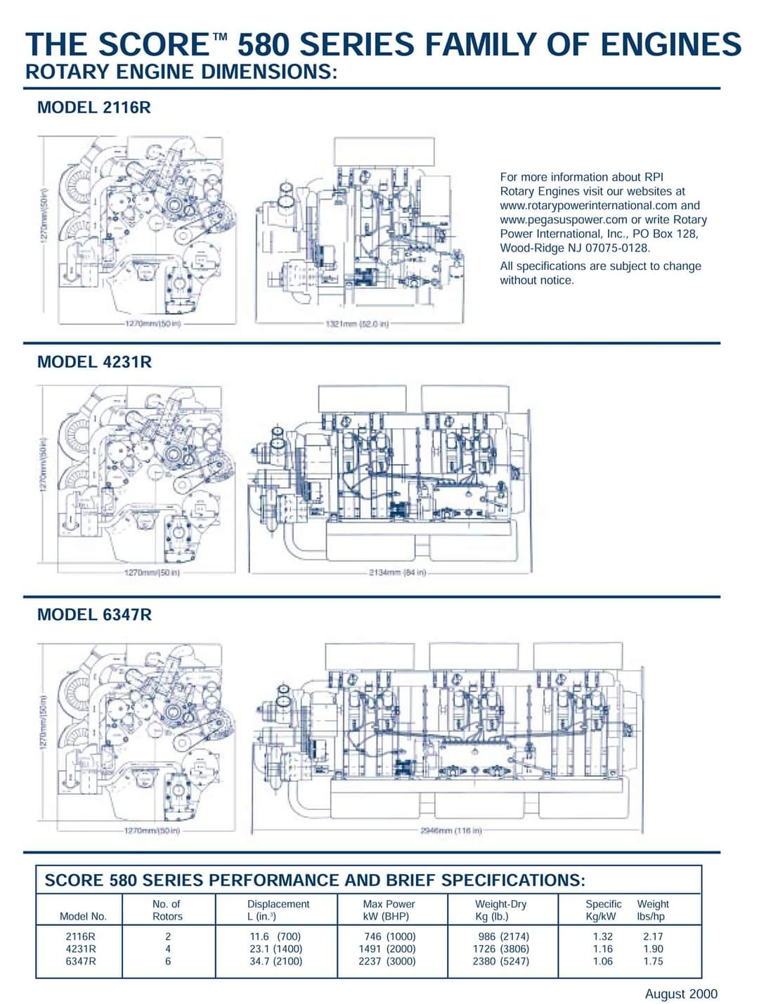

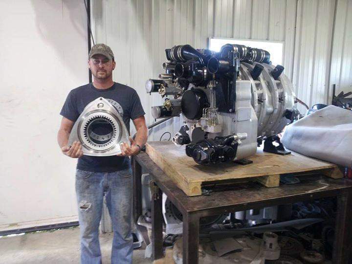

Do you need a light and compact engine or generator for MBTs?
Here is the rotary diesel engines!
2 rotor 11,6 liter 746kw(1000hp) 986kg
4 rotor 23,2 liter 1461kw(2000hp) 1726kg!!!!
torque, about 1,550 pound-feet at 2,400 rpm.
Would diesel rotary engines be generators for future electric MBT's?

Wankels wear out easily. You need to replace them once in a while. Also they burn motor oil.
