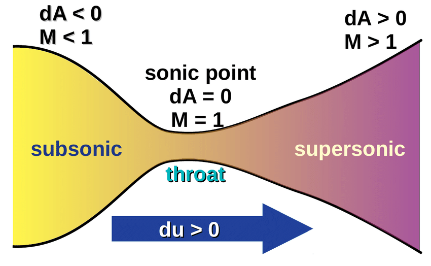

In order to achieve continuous sustained supersonic flight the engines’ nozzle design is most important. We have all heard Dr Aksit mentioning CD nozzles (Convergent/Divergent) . To understand this better one needs to look at the coarse representation of a “Laval-Nozzle”
Here we have hot air exiting turbine where the yellow area is. The air is “converged” and constricted/choked at the throat to a high pressure to adjust mass flow rate. Before the throat the air flow is subsonic. At the throat the speed of air flow is Mach 1. But as it leaves the throat the air is released and gains speed. It becomes supersonic. This supersonic flow, thrusts the engine and the plane in the opposite direction towards supersonic speeds. By adjusting the throat convergence angle and also the opening angles of the divergence and the area of divergent nozzle, you can adjust the optimum state with which you can achieve supersonic flight.
An adjustable convergent only engine can allow a plane to reach intermittent low supersonic flight speeds. But not sustainable speeds. And not high supersonic speeds anyway. For that you need the divergence.

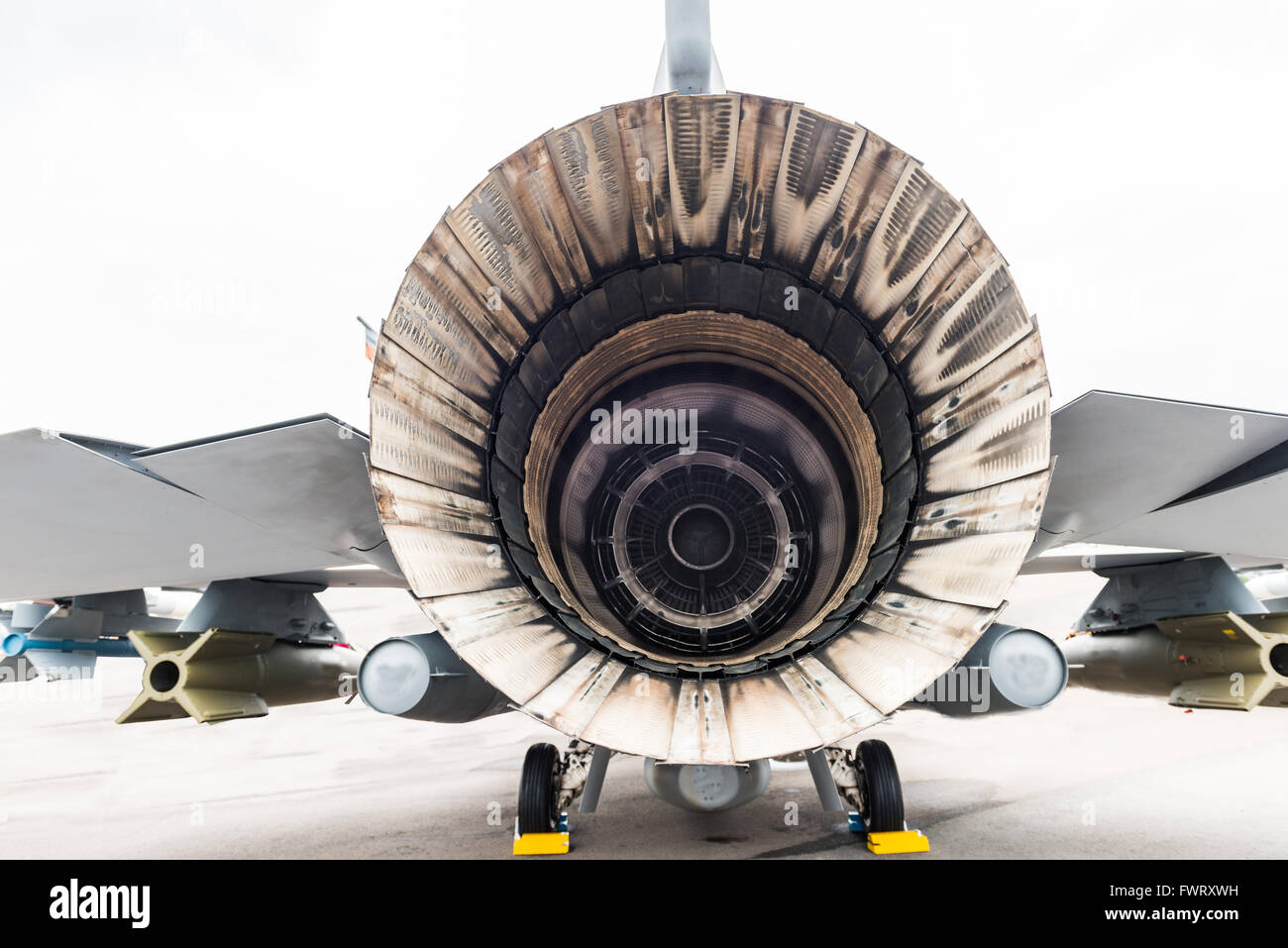

An F16 engine’s divergent nozzle wide open

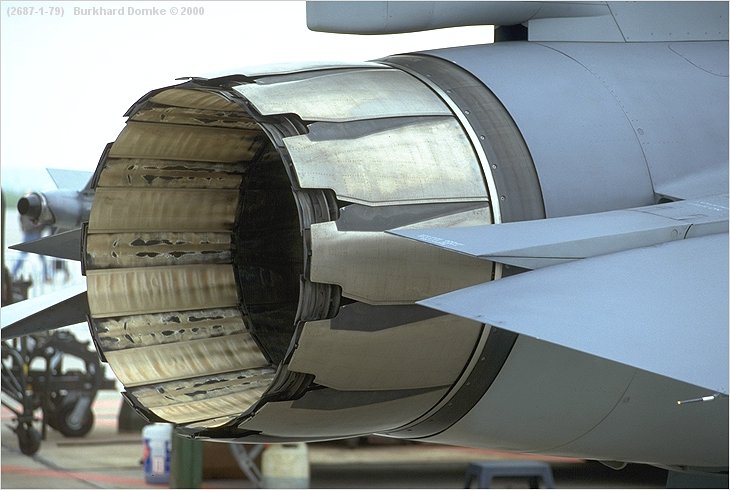

An F16 engine with an adjustable divergent nozzle

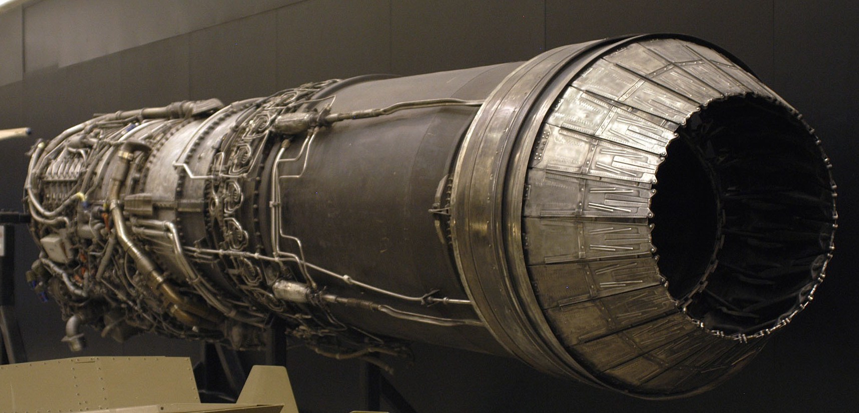

To answer your question; NO! TF10K is not at the same thrust level as the J-79 engine powering F4 planes. J-79, develops just under 120000lbf dry thrust with nearly 18000lbf in wet. In other words twice more powerful as TF6K/TF10K
F4 engine too, when pushing the plane to supersonic speeds, would have to use divergent nozzles.
