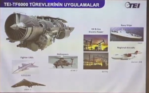

Any news about TEI TF6000 engine?
I did read before that they were trying to ignite it on the 100th anniversary of the republic
81 45,473
What would be the power on the helicopter variant?
It remains on the table as a very powerful (output power) option(compared to current options) if preferred. The other option is the production of selected Ukrainian engine in Turkiye, along with maintenance, repair and co-development and export rights. I guess option 2 should be stronger now.
I hope not,Ukrainian engine looks like a mistake(not enough power).
4,299
274 22,475
Exactly!
The TF6000 engine will turn in to a turbo shaft engine of 5000-7000HP power level monster. That sort of power is good for tilt rotor used in Osprey like planes. That is an overkill for Atak2.
The 3000 HP power level turbo shaft we need, can best be achieved if TEI is asked to manufacture it with extra manpower and cash injection and starts a new engine program with the experience they have gathered when producing the 2000HP class T700-TEI701D engine for the Blackhawk program. They produce more than 70% of that engine in house including hot parts. So it wouldn’t take as long as the TS1400 program.
But that will mean taking resources away from the KAAN’s TF35K program. So it will have to be put in the back burner for the time being.
TS1400 is too powerful for AKINCI, TF6000 is too powerful for ATAK 2. TF35K will be too powerful for Hürjet.
Nice problems to have :) We'll fill these gaps once TEI has less on her plate.

The last few post are causing mixed emotions in me. Seriously.
Should I be happy that we‘re gonna get TF6000 soon? Or just sad that only rotary application for that engine would have been a segment of aircraft rather “luxurious“ for our needs?
Should I be satisfied to know that 3000 HP turbo shaft just within our reach but only with pouring cash and slowing down TF35 program? And even though 3000 is close, should we maybe go with Ukrainian option with the lower power but export rights (not sure about the last bit myself)?
Not desperate but all tough choices and I’m confused 🫤

I'd say there's a merit to slapping bigger than necessary engines to a platform. It would perform more efficiently.

That (TF-6000) is an overkill for Atak2.
OK. I get it. But, we can not an engine with 3000 SHP power with an axial compressor be designed that uses only the first stage hot sector turbine of the TF-6000?
