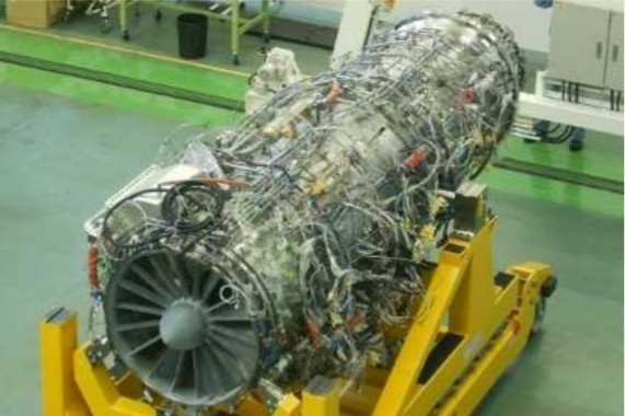

I can't speak for India but you should read more about Korean turbine engine programs that are both in service or in testing. They're not behind us. They will be if we achieve our goals with TF6000 and TS1400 but that's not today's reality.
