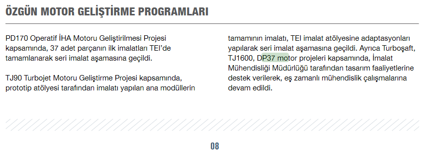

This might be totaly experimental stuff nonetheless It is exciting
From 2018 TEI magazine
Under "Original Engine development programs"
"...Beside, Syncronized Engineering work is contuined, supported by Production engineering department's Design support under Turboshaft, TJ1600 and DP370 projects."
From CV of an Engineer from TEI
So There is indeed Turbojet Engine work in TEI with TJ1600 name.

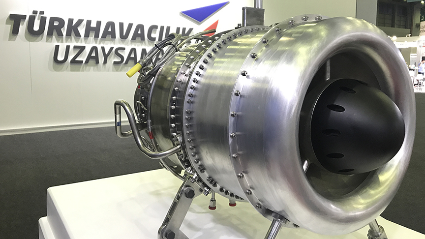

It is highly likely that the engine in question is this engine; but no specs mentioned.

But what is DP37?
His CV says experience on DP8-22-37 manufacturing. Evalutionary PD series?

This engine seems to have been developed as a side product to the TS1400 engine and probably has the same BHP rating as its turboshaft equivalent. I have seen this engine at one of the trade-shows and it does have a similar combustor size to the TS1400 engine.

This engine seems to have been developed as a side product to the TS1400 engine and probably has the same BHP rating as its turboshaft equivalent. I have seen this engine at one of the trade-shows and has similar combustor size to the TS1400 engine.
Hmm, I'll have to take your word for it then, but I am not entirely convinced.
