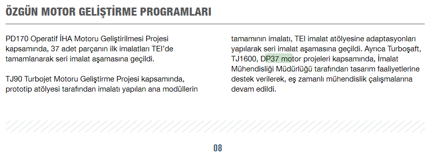

Thanks to @Zafer
This might be totaly experimental stuff nonetheless It is exciting
From 2018 TEI magazine
Under "Original Engine development programs"
"...Beside, Syncronized Engineering work is contuined, supported by Production engineering department's Design support under Turboshaft, TJ1600 and DP370 projects."
From CV of an Engineer from TEI
So There is indeed Turbojet Engine work in TEI with TJ1600 name.
It is said that the TJ1600 engine can be 2 times more powerful than the engine developed by Kale Aviation for the SOM cruise missile.
