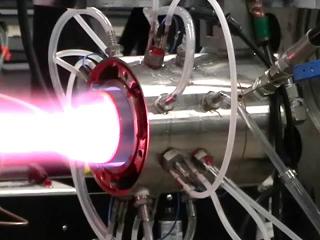

Turkish continuous detonation wave engine prototype
The first ignition of the engine happened yesterday.
Continuous Detonation engine architecture is a promising futuristic technology. I'm posting an article on the subject so you have an idea.
In summary, we can say that Turkey has developed the first prototype of an engine that can reach speeds like hypersonic or mach 4.
Prof. Dr. İsmail DEMİR: "TÜBİTAK-SAGE is working in the field of hypersonic missiles."
We can now say that Tübitak SAGE has performed the ignition of the first scramjet engine prototype.
