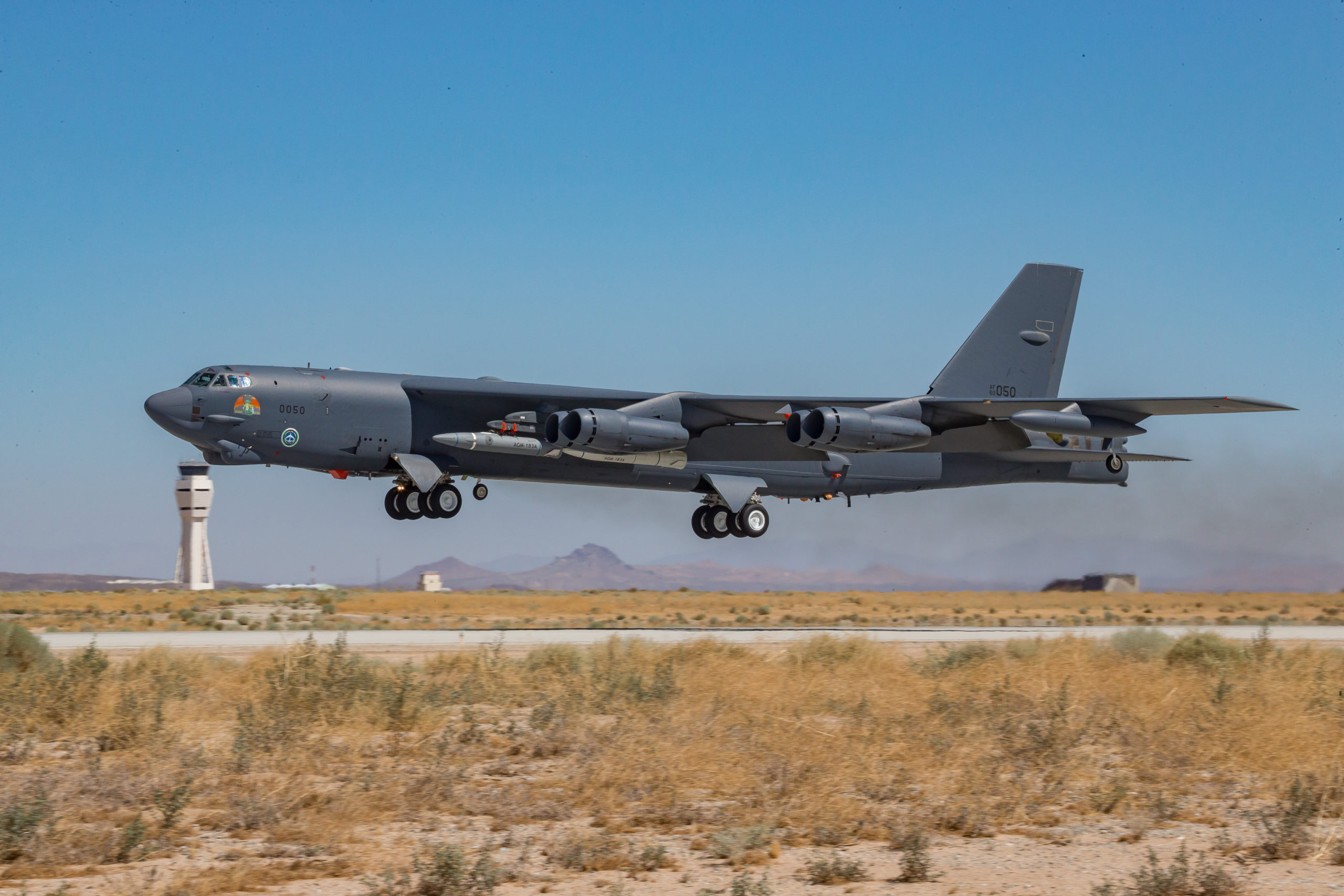

A hypersonic missile like ARRW will cost 15 to 18 million dollars a piece.
If you are not carrying a nuclear warhead, it is false economy to fire a hypersonic glide vehicle/missile over a thousand kilometres, unless you are aiming to sink a carrier.
