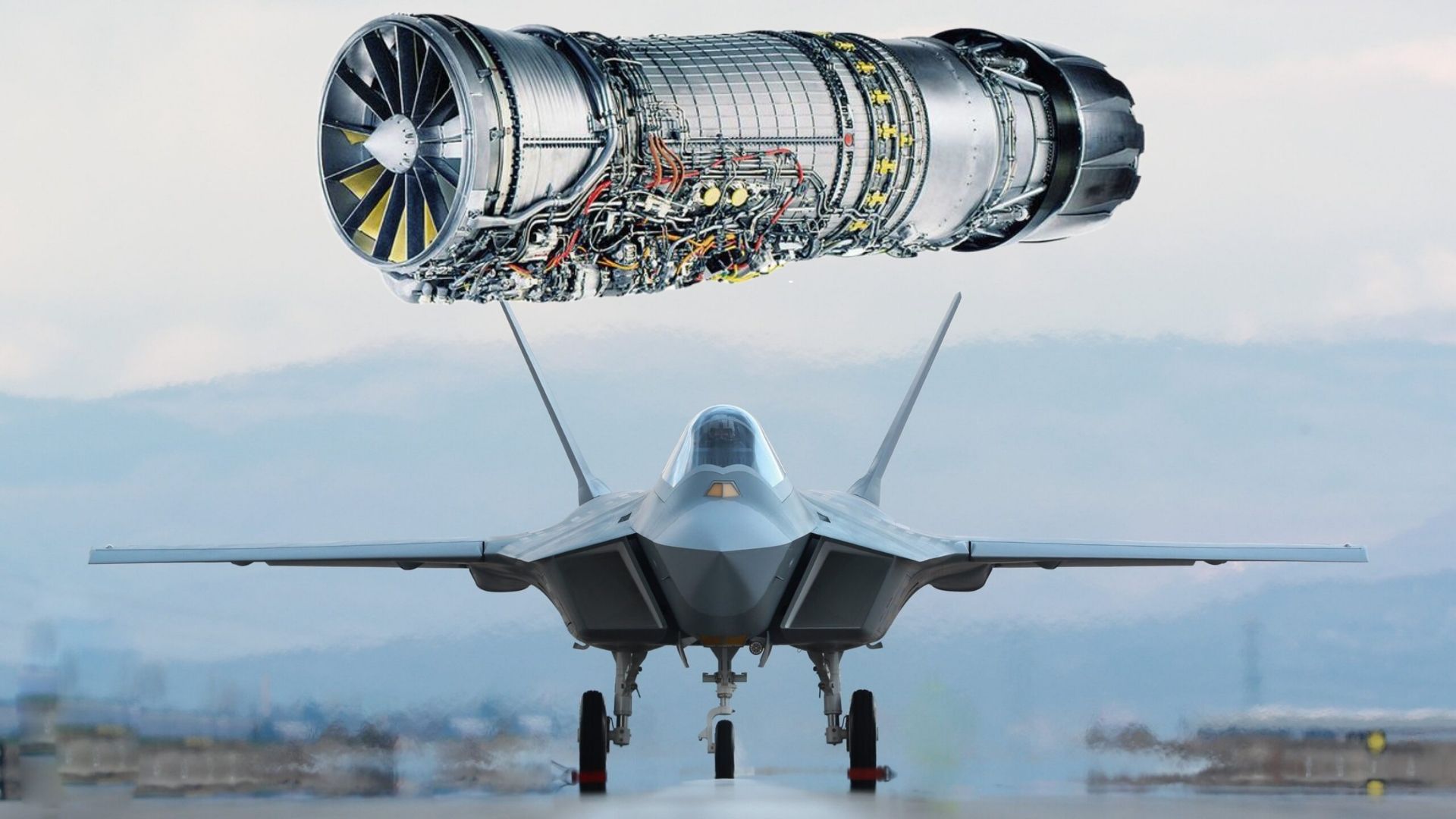

TEI-TF6000
Samba
265
4 439
They changed the tei website tf6000 now shows a different picture
The recent one looks more like from a production engine, more realistic, and a photo of the engine itself rather than a render or mockup.
