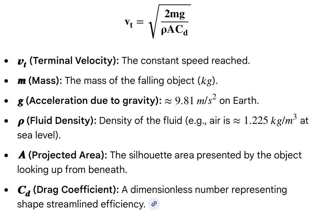

A ballistic missile with 3000km range can only hit its targets at low-mid-supersonic speeds because its engines will be shut off mid flight. A 6000km range ballistic missile can still have enough fuel allowing it to be high-supersonic or low-hypersonic in the terminal phase for the same range target. It's an important deterrant against countries like Israel who has capable ABM systems.
Not quite right explanation I am afraid.
As per @Zafer has stated, the bigger the mass at terminal stage the faster the missile hits it’s target
If you check the terminal velocity formula:
The cross section of the missile is important too. More perpendicular the missile approaches the better as it would decrease it’s silhouette.
As a generalisation for a ballistic missile, 60-70%of its mass is fuel. When the missile is in it’s ballistic downward motion it will have depleted it’s fuel
if you fire a 6000km range missile to a target that is 3000km away. You fire it at a more steep angle. It still depletes it’s fuel.
So a ballistic missile always depletes its fuel, independent of the distance to the target. And still it will have higher terminal velocity because of the approach pattern. Do I get it right?
Yes. They almost always deplete their fuel. They have high speed depending on their weight and their cross section area.
All the fuel is usually burnt during boost phase. Then missiles coast. Then start their terminal downward motion.
Here is a bit of background info:
  • Solid-Fueled Missiles: Most modern intercontinental ballistic missiles (ICBMs) use solid fuel, which cannot be throttled or turned off once ignited. These motors burn until the fuel is completely exhausted.
  • Liquid-Fueled Missiles: Older or some specific liquid-fueled missiles can shut down their engines before all fuel is gone. However, to achieve maximum range, they typically exhaust their fuel, or the stages containing the fuel are jettisoned once depleted.
  • Boost Phase Duration: The fuel is usually burned up within the first 3 to 5 minutes of flight.
  • Post-Burnout: After the rocket motor cuts off (burnout), the missile does not "drop dead" but instead continues to coast on its trajectory at thousands of miles per hour
A 100 ton ICBM will have 30-35 tons of mass in terminal stage. It will hit target at 8 to 10 Mach speed .
Bora missile may have 1ton of mass. So it will be just above 1 Mach.

Use logic,drop a something with a mass from 10m 20m 30m etc and see the difference.
The higher the faster.
No. Not correct. Because the example distance is too short. If a person sky dives from 30000m or 5000m , he will hit the ground always at the same speed. Depending on whether he is head down or flat position, that terminal speed is anything between 180km/hour to 250km/hour. If he hold his position same eac time, he will always hit the ground at the same speed. Even if he jumps down from space.

Thanks for the information. With the reframing of my -now better- ballistic knowledge, my point stays the same. Such a weapon system could be useful to surpass advanced ABM systems. It's good to have, if we really have it, of course.
Yes. Only possible way to stop them is during boost and coasting phase. Otherwise it is almost impossible.

@TR_123456
All objects fall to earth at the same acceleration (without air resistance) , 9,81 m/s². The actual speed at impact depends on the height of fall and the time.
See my post #179 in previous page pls. Terminal impacts velocity on earth is governed by the related formula.
smaller the silhouette and drag coefficient of the missile and the bigger the mass of the missile; then the bigger is the terminal impact speed as dictated by the formula.
