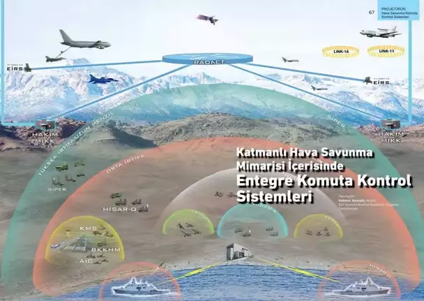

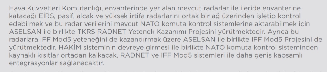

Aselsan radar projects that are going to be integrated to HAKIM command control system.
  • EIRS
  • AIR(Low Altitude)
  • Passive radar
  • YIR (High Altitude)

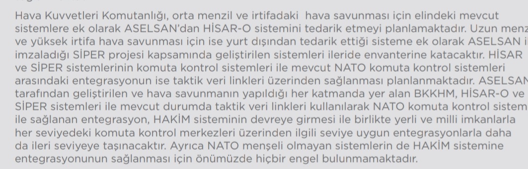

Non-NATO systems can be integrated to new generation HAKIM command control system.

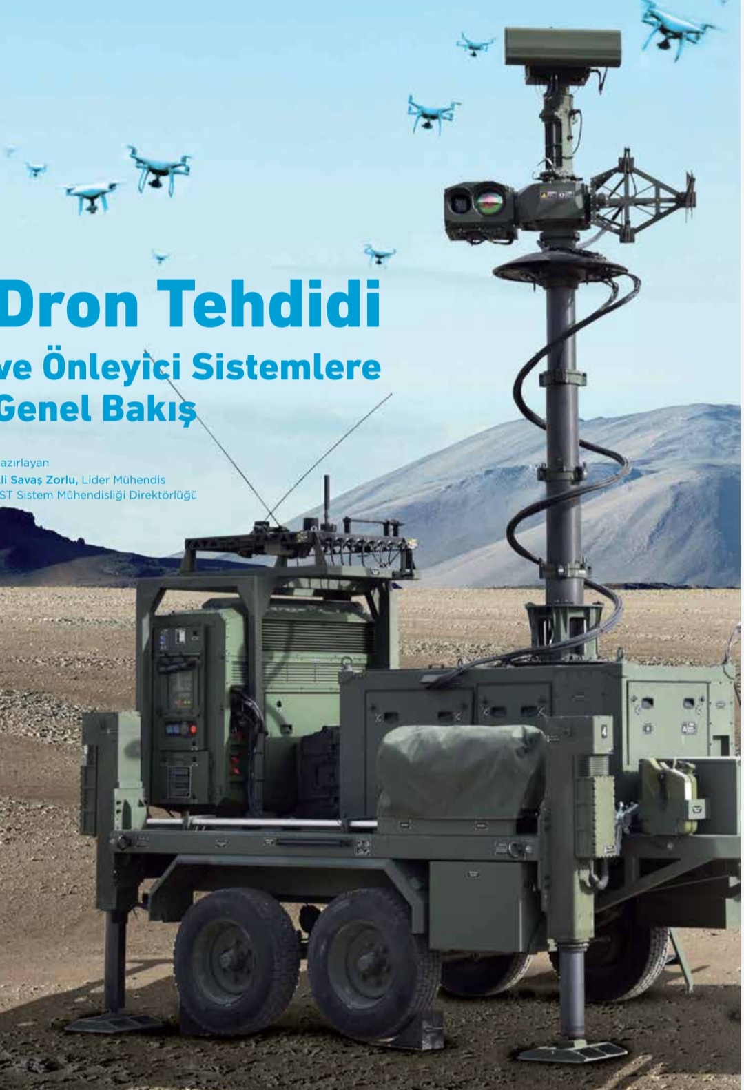

YARASA, the target's type information (Airplane, Helicopter, UAV, Missile, etc.) is predicted as probabilistic on the combined picture. With the use of multiple sensors and the processing of all information from the sensors, specific type classification of targets is also done. For example, with this capability, drone-class aircraft can be distinguished from other objects (birds, etc.), while predictions are made regarding the sub-class information of drone-type aircraft (DJI-Mavic, Parrot-Disco, etc.).
With this capability, which is based on artificial intelligence, the target type information of aircraft that may pose a threat to both long-range systems that make zone defense and short-range systems that make point/facility defense can be detected in a short time, thus enabling the system to operate an effective response process. The target classification system works whenever the main system is active and corrects itself continuously and automatically.

All these automation and decision support systems are developed for Turkish surface to air network centric air/missile/point defence systems. When these SAM projects are completed, the operational capabilities of TAF will be reached to high levels.
114 19,734
Automation and decision support systems integrated into the command & control structures are the future of warfare. Fire support, CAS, air defence systems, reconnaissance and EW platforms integrated with AI automation and decision support systems that are working with the intelligence provided within the network and effective communication means helping into classifying, analyzing threats and providing advices on when and how to engage. This will help a lot the commanding staff in their time with taking decisions and will improve a lot the clarity of the picture of the whole war theatre. This command & control structure combined also with offensive means will be something that will bring our armed forces levels ahead of the armed forces of many developed countries. I really love the network centric warfare concept of the SSB and the Turkish Armed Forces.
