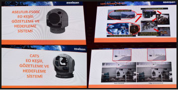

Aselsan continues development activities regarding electro-optical systems. CATS has been improved and continues to be improved. Major improvements are:
  • A more efficient dual gain detector is used, based on InSb in the place of MCT.
  • Internal temperature reduced to lower the 'noise' that the sensors are subjected to.
  • Weight reduced from 62kg to 56kg and further weight reduction underway to 55kg.
  • Changing algorithms and the use of filters allows the CATS to see the laser designator both during day and night, with work underway to see all the pulse repetition frequency codes necessary to guide munitions.
  • Adding two more FoV's between 3.2 degrees and 30 degrees in the near future.
  • Beam divergence of the laser designator (25km max range) was improved from 0.5 mrad (5m beam diameter at 10km) to 0.3 mrad (3m beam diameter at 10km).
  • Laser range finder has a range of 30km.
Thanks to Aselsan's studies and cooperation with East-Asian and Chinese companies, Aselsan accessed HD detector technology and started the development of the Aselflir-F500C system. Aselsan carries out dozens of detector programs from various resolutions, detector material, both cooled and uncooled.

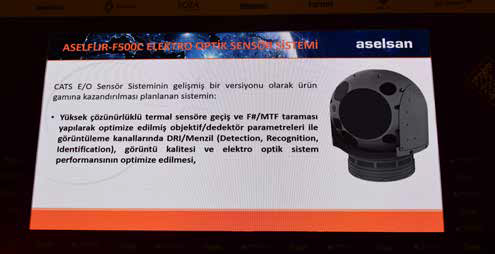

The Aselflir-F500C comes with the following capabilities:
  • Improved thermal sensors, imageprocessing, hardware, weight reduction and optimization of the overal system performance compared to the CATS.
  • Like the CATS, the Aselflir-F500C also uses a common aperture for the HD MWIR (1280x1024 15μm pixel pitch), HD SWIR (1280x1024 10μm pixel pitch) and FHD (1980x1080) visual camera.
  • Unlike other systems, the Aselflir-F500C will see the laser spot on all 3 sensors.
  • Weight is around 50kg and diameter 15 inches.
  • Preliminary and detailed design planned to be completed this year and serial production phase is expected to start in 2022.
  • Aselflir-F500C is to be used on tactical UAV's, helicopters and fixed wing aircraft.
Aselsan has started the 'new generation gimbal development project'. It is aimed to develop better performing gimbals with the use of direct motors on the outer axes and linear motors on the inner axes. Further improvements are in weight reduction and structural strength to withstand higher wind loads at higher speeds and vibrations of the platform.

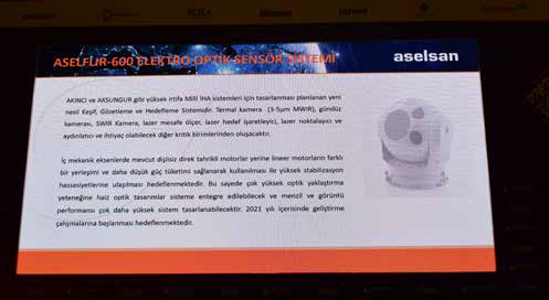

Aselsan has also introduced a new product called the Aselflir-600 made for HALE UAV's such as Aksungur and Akinci. Thanks to its bigger size of 22 inches and the improvements of the 'next generation gimbal development project', it will be able to have better performance.
  • Use of linear motors on the inner axes improves the stabilization which allows the installation of very high magnification sensors.
  • Increased laser output and decreased beam divergence is possible by the larger room available in the gimbal for laser modules.
  • Use of HD MWIR and FHD or higher visual camera. (Possibly also HD SWIR like on the Aselflir-F500C)
Finally, Aselsan has recently begun development of a new product situated between the mini-gimbal class and 15 inch class for use on short-range and tactical UAV platform.
- Defence Turkey Magazine issue 108 p.111-115

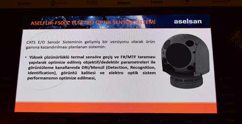

  • Like the CATS, the Aselflir-F500C also uses a common aperture for the HD MWIR (1280x1024 15um pixel pitch), HD SWIR (1280x1024 10um pixel pitch) and FHD (1980x1080) visual camera.

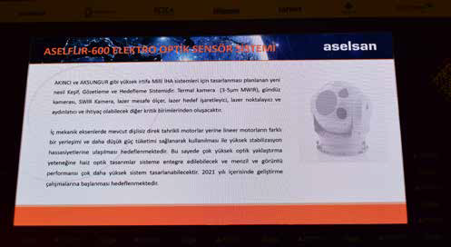

  • Use of HD MWIR and FHD visual camera. (Possibly also HD SWIR like of the AF-F500C)
