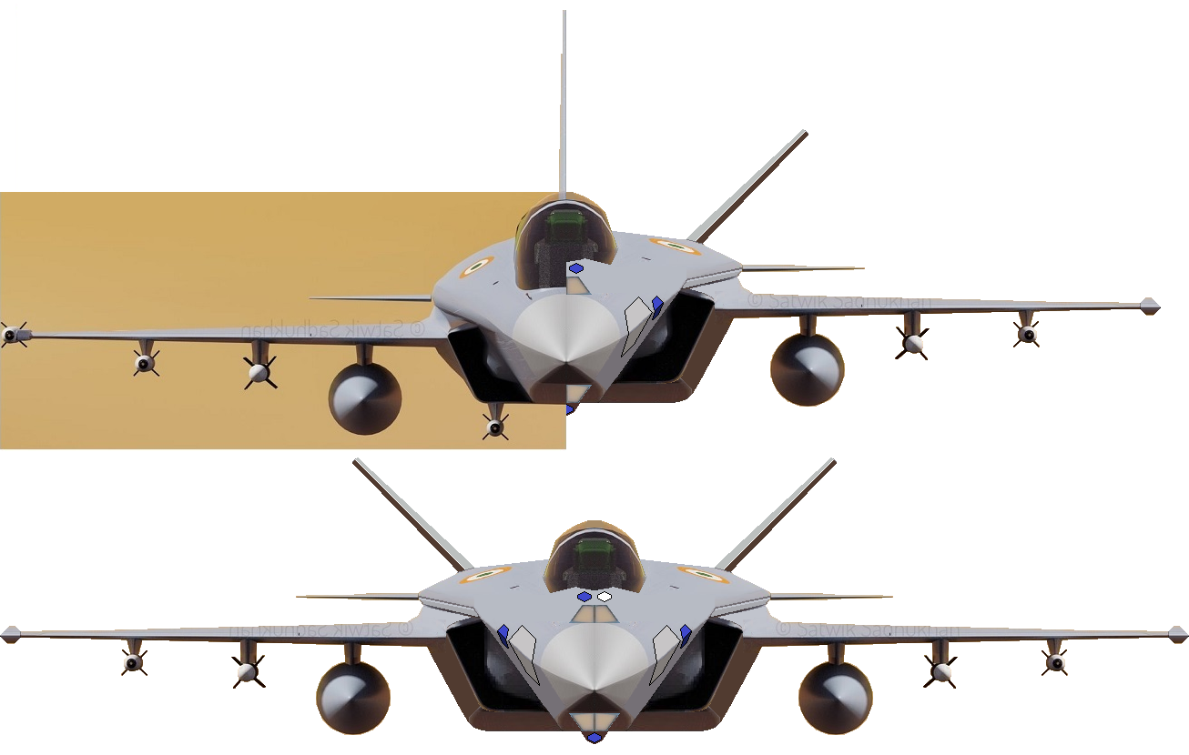

AMCA & current TEDBF would use same engines in twin config. so their dimensions, weight, size are also identical.

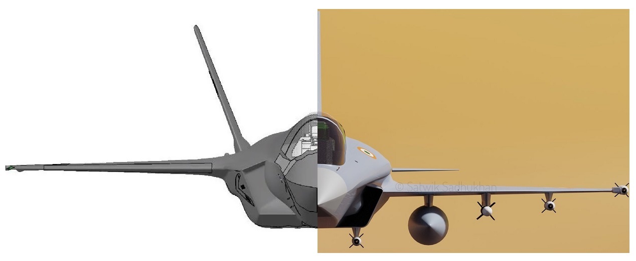

Following is a scaled comparison as per their width:
This comparison is identical to F-16 Vs F-35:

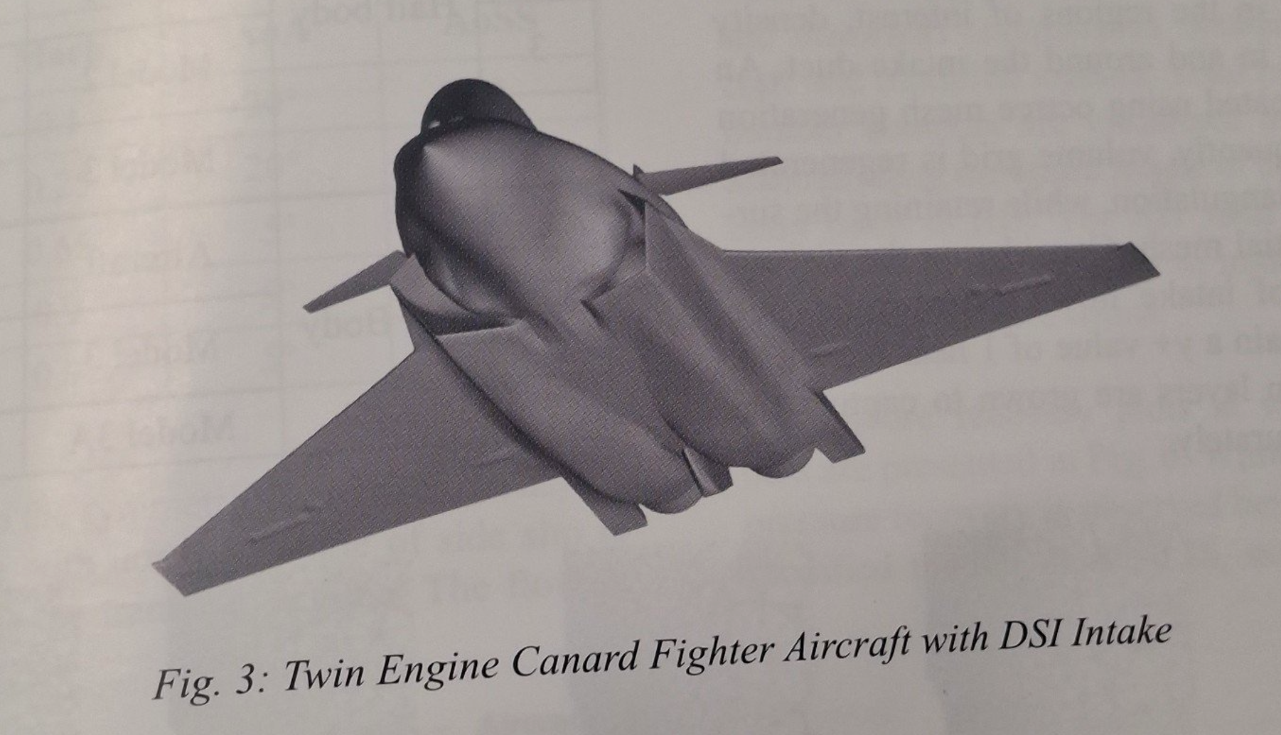

Although unofficial CADs are not the ultimate thing, the AMCA CAD looks relatively matured but if the TEDBF needs to be tweaked then clearly some things have to be modified like -
- lengthening & widening fuselage.
- reshaping narrow cockpit & over-sized canopy.
- create space for frontal sensors.
- adjust smaller intake area.
- pull up intakes & increase belly width for IWB.
- reduce bulky shoulder like fused CFT.
- remove vertical tail to twin canted ones.
- blend the wing more into fuselage.
- perhaps increase wing width/area little more.
- remove wingtip hardpoint by conformal tapered EW antennas.
IDK how i forgot this post 1 year back.

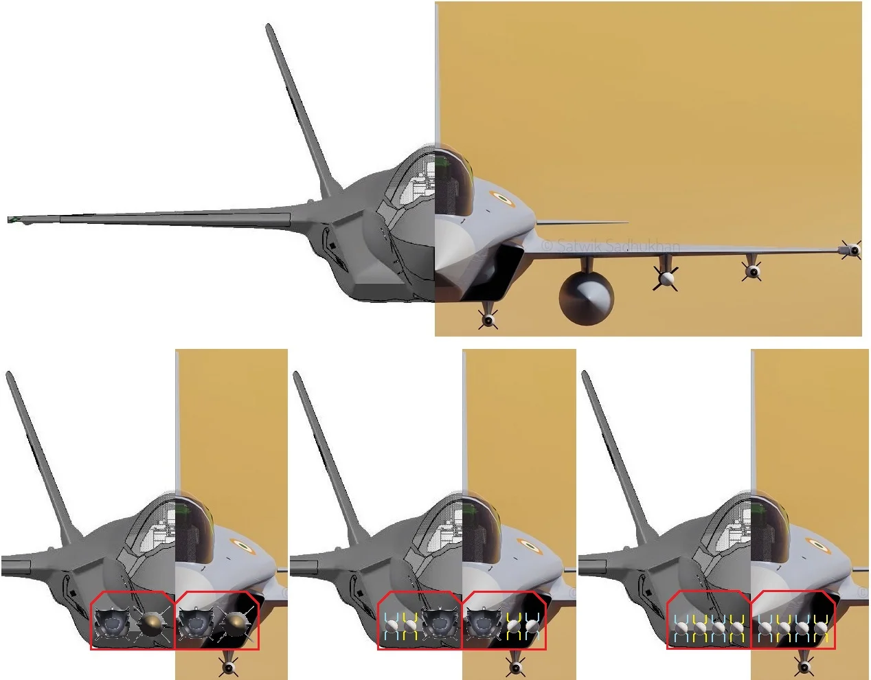

We noticed as per available diagrams & official dimensions that AMCA & TEDBF have identical span, dimensions, cross section at some places, like height from belly to cockpit ceiling looks almost same.
This means if AMCA can have IWB so can TEDBF.
For notional AG load I used CADs of AGM-88G, JSM, AGM-158 JASSM.
For AA load i used Astr AAM CAD.
When we superimpose AMCA's IWB dimension box on both jets with AA, AG & mixed load, it looks like this -
We see that TEDBF needs some tweaking like i mentioned in last post. It would be like X-35 to F-35.

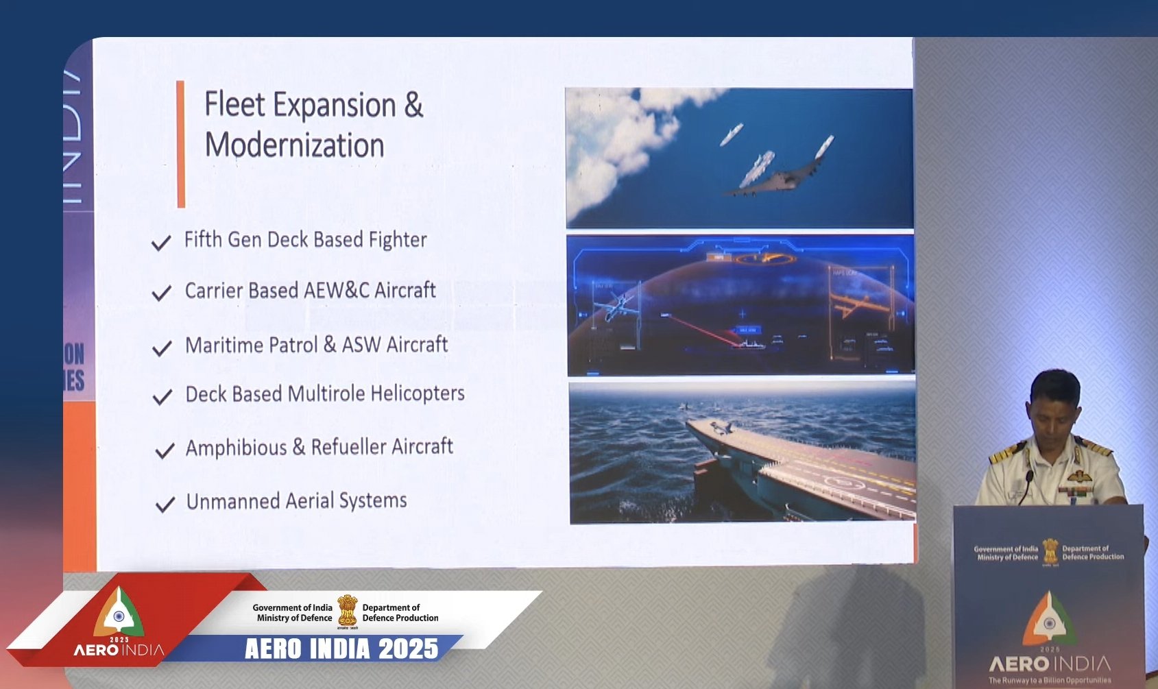

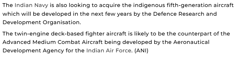

> IN indicated 5gen TEDBF at Aero-India'25. Some say it's for new CATOBAR IAC & 4gen TEDBF is for STOBAR IAC. IMO just like adjustment with Rafale has been done, similarly 5gen jet can be operated within STOBAR paramaters till CATOBAR IAC is made, otherwise from shore bases.

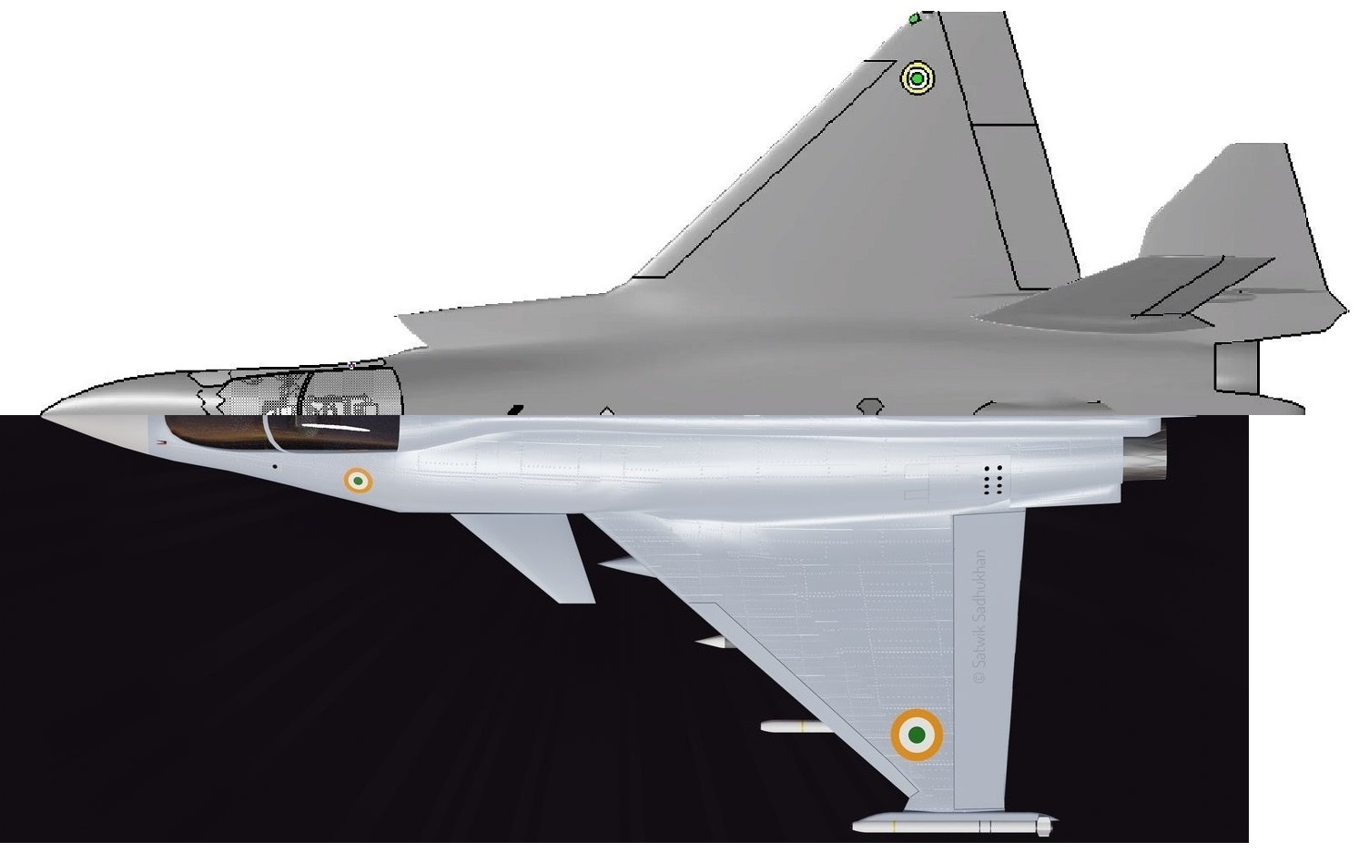

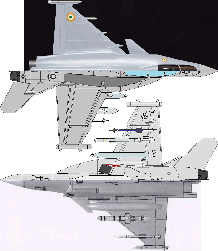

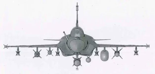

> 1st, for 4gen lovers i would like to do an approximate scaled comparison of this 4gen TEDBF with USN 4gen TEDBF the F-18 SH bcoz they would have same 2x F414 engines. And then present some points in my opinion.
NOTE - AFAIK the EWP'll be implemented, but dorsal CFTs have been cancelled due to technical/performance issues, still i'm considering that theoretically, analogous to a hypothetical model. Considered CFT weight = 2x400 Kg & fuel in them = 2x1.6 tons, EWP weight = 408 Kg & its payload = 1,134 Kg.

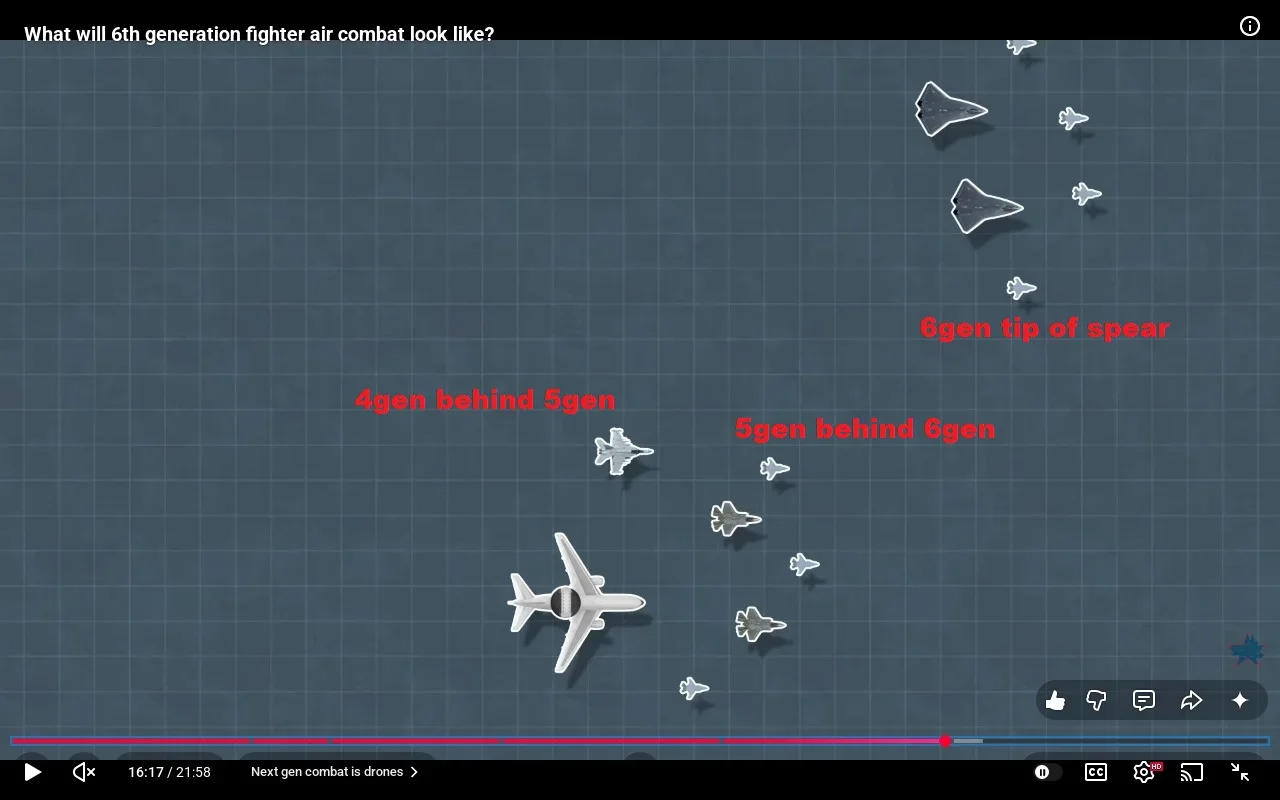

+ 4gen can be given many MLUs - radar, cockpit, Networking, composites, RAS, some RAM, sensor pods, LR weapons, even a DEW pod, but -​
- still 4gen body'll be most visible object in sky to be hunted by 5gen.​
- using LR weapons on 4gen is compelling thing to use their last series, not ideal/desired/efficient which is actually with stealth sneaking closer & increasing NEZ, that's where 5gen got limited IWB & 6gen will fulfil.​
- Stealth jet has higher chance of breaking lock.​
- And now 5gen also threatened by 6gen R&D.​
- Hence on both sides of battle if USA, China, EU, Russia fight eachother in proper blown war not just skirmishes, in 2030s/40s whenever, they'll also suffer big 4gen losses,☠️that would be the job of 5/6gen​
But 1 of most ignored point is that last series of 4gen'll hide behind 5/6gen & UCAVs if AI fully matured, while India's 5gen & UCAV R&D sluggish & no 6gen R&D -​
- USN has F-35, will have FA-XX,​
- PLAN is ready for J-35, will have J-50,​
- Russia is sluggish, but might disclose next gen successor of Su-33 any day.​
- France will have N-FCAS, could relax & jump to 6gen as Russia is sluggish.​
- Indian 4gen TEDBF will shout "AMCA help us!".​
+ UCAVs will cover 4gen like bodyguard. Sure, that's the future to protect even the 6gen. But -​

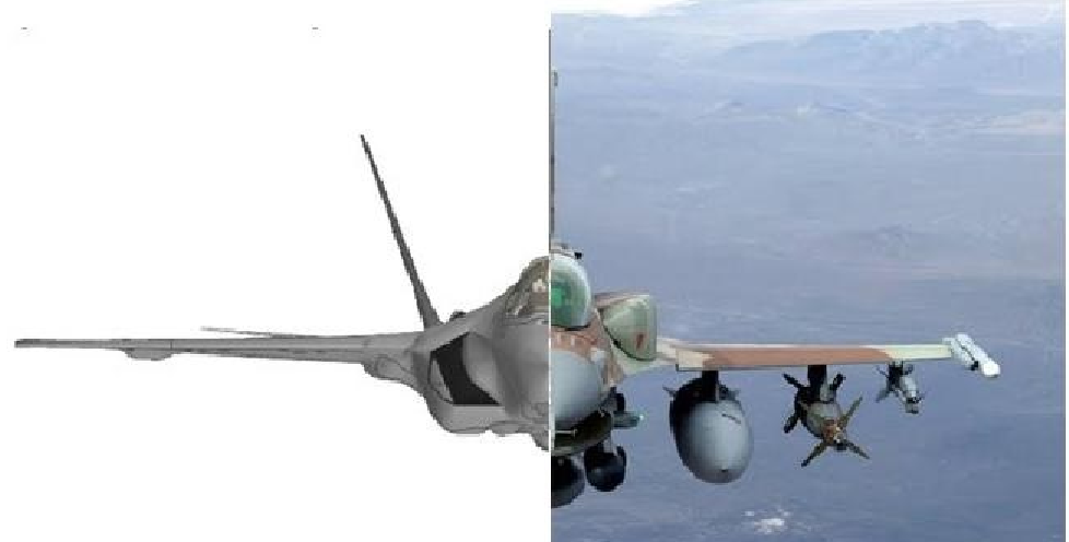

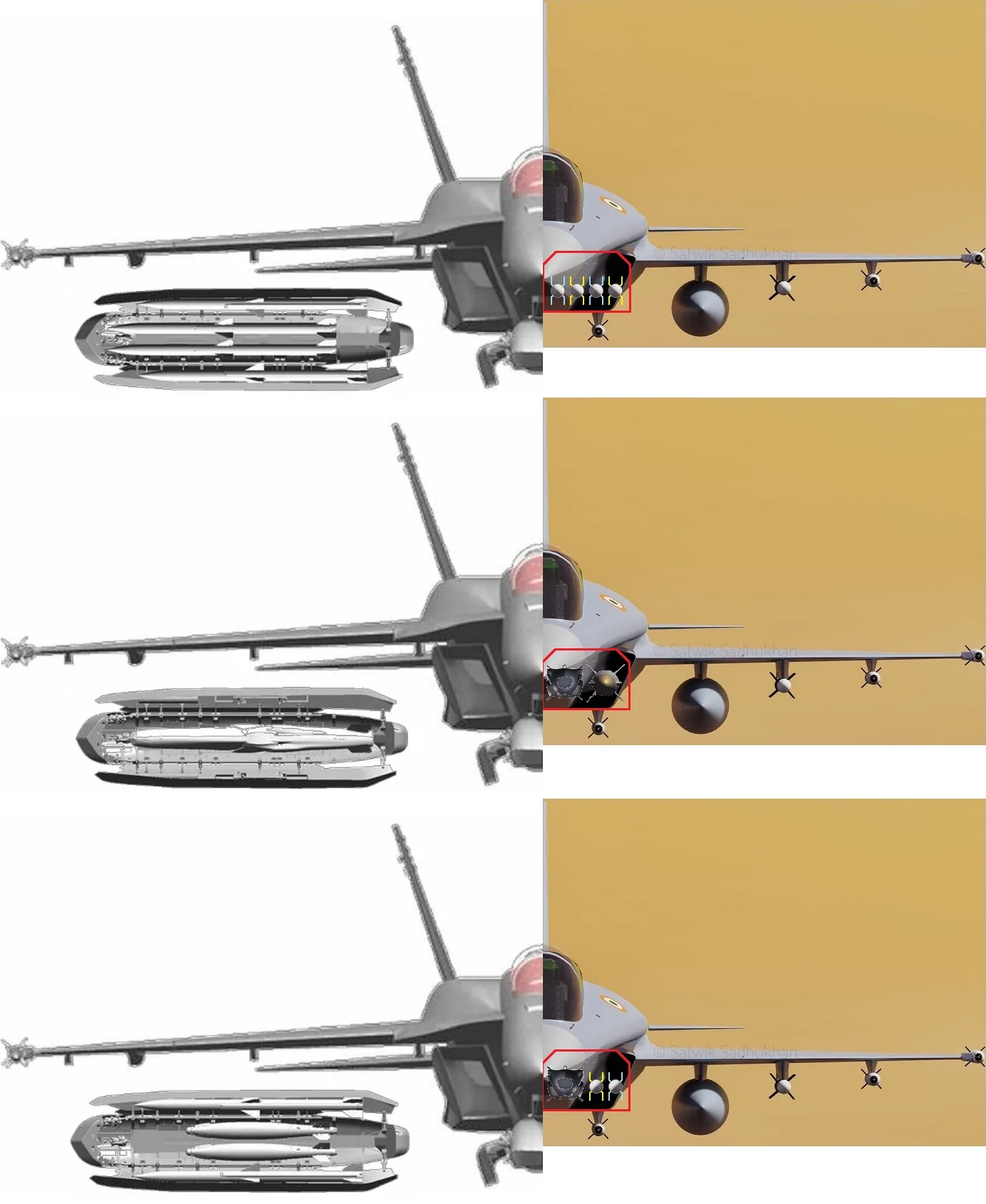

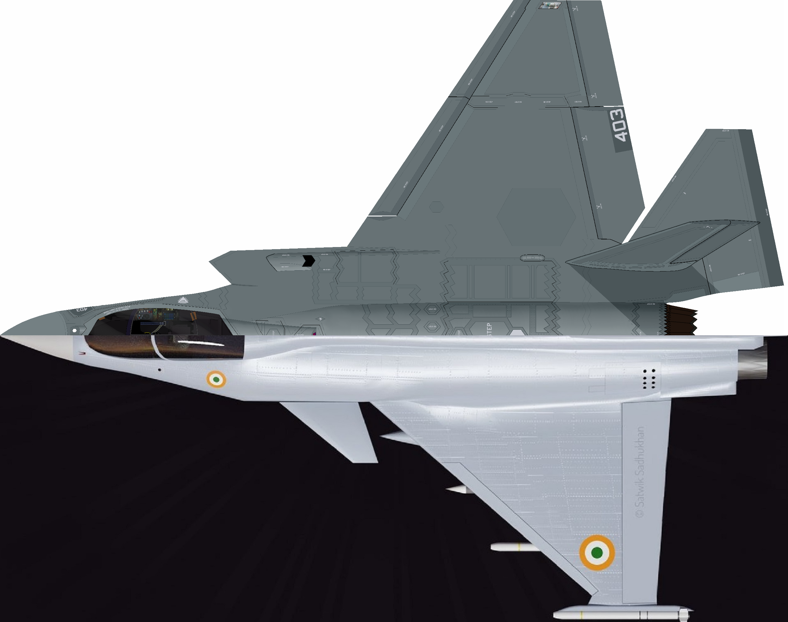

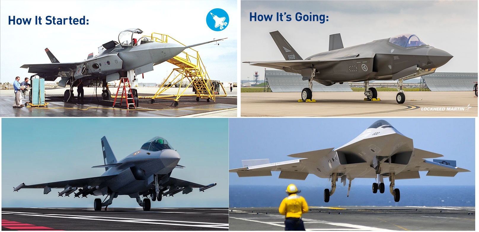

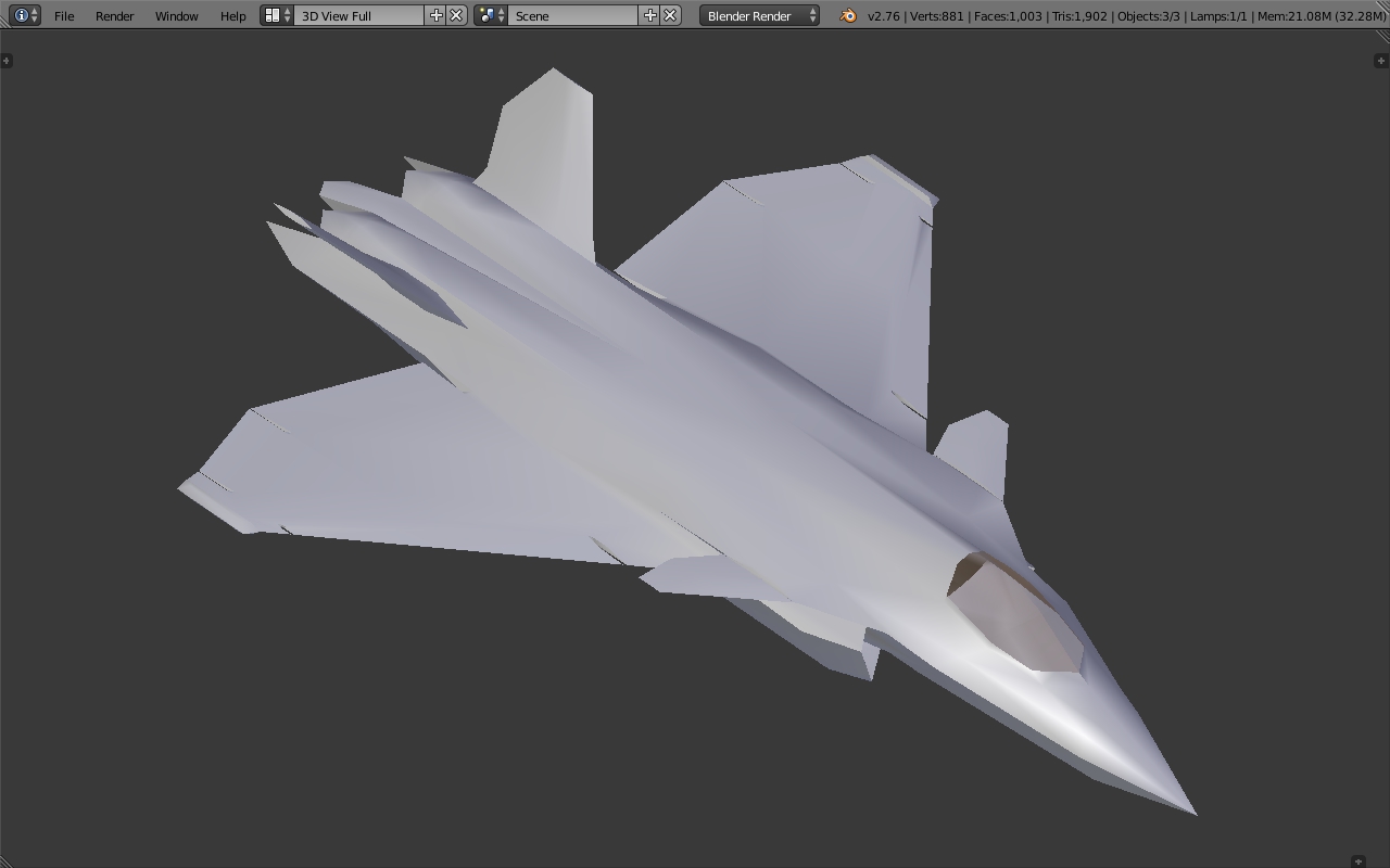

After adjusting pixels of available diagrams of TEDBF & AMCA to their dimensions & comparing, we found that their fuselage height is almost same; span & cross section area values are nearby, AMCA's belly spans more for IWB.
The overlay of AMCA's IWB outline shows that TEDBF can be tweaked towards 5gen (which i made last year but couldn’t show yet) or a cleansheet delta-canard jet.

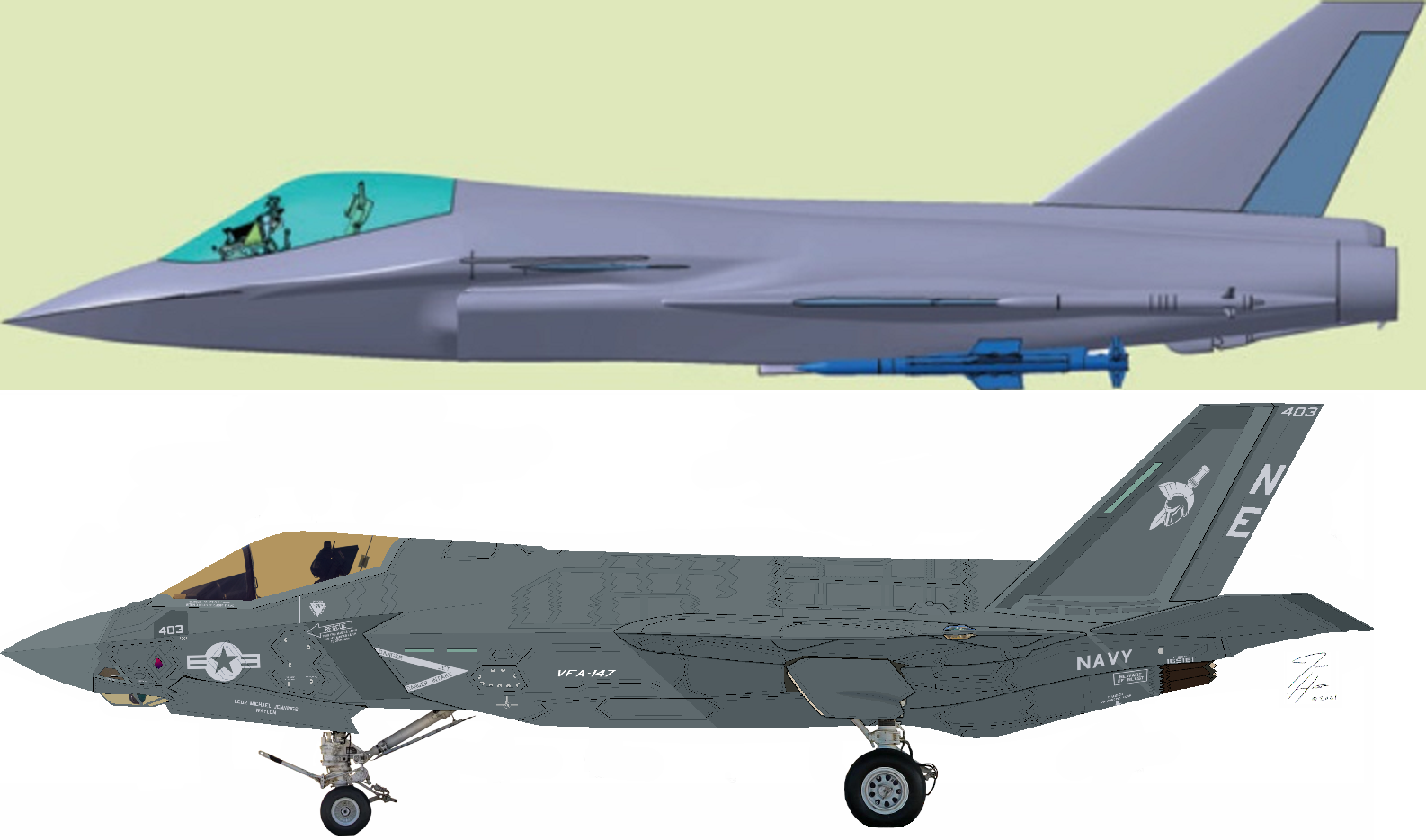

But as AMCA is not made yet, let's see comparison with existing similar tandem bi-plane medium category naval jet design - F-35-C, matching the pixels with dimensions. This can help in understanding transitioning from STOBAR jet design to CATOBAR & explore a STOBAR stealth design.
NOTE - This TEDBF 3D CAD is slightly different from official greyscale images not good resolution.

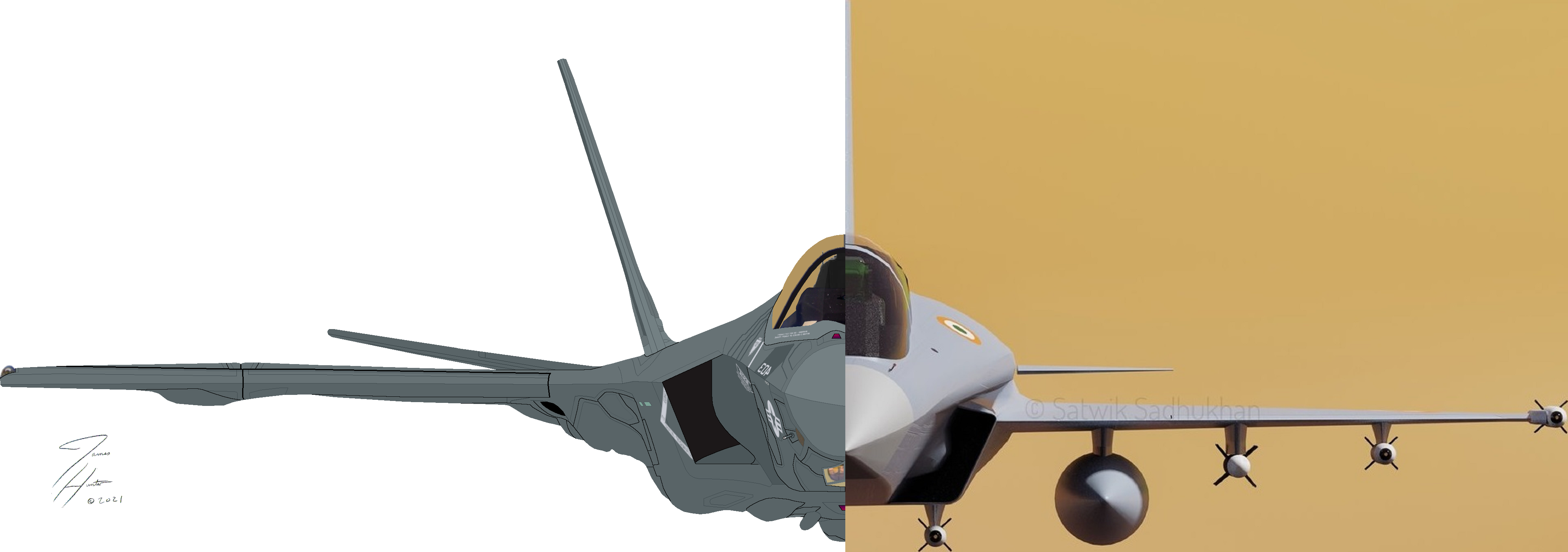

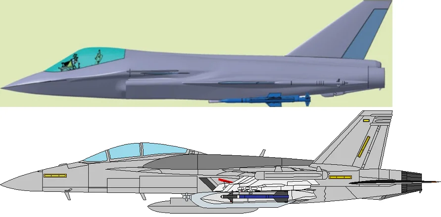

> From diagrams we can notice that -
- Like "Fat Amy", TEDBF looks chubby & voluminous too, but with smaller engines.​
- height of both fuselages are near equal,​
- From nose to exhaust, TEDBF seems to be longer,​
- F-35's fuselage width & wingspan is more due to IWB,​
- TEDBF nose is more tapered & drooped,​
- F-35's canopy is already big. TEDBF's canopy is way too big.​
- Rear half of F-35 packs cool stuff like cooling system, antennas, decoys, APU, counter-measures, etc. A 4gen jet may not have some of these things or not internally.​

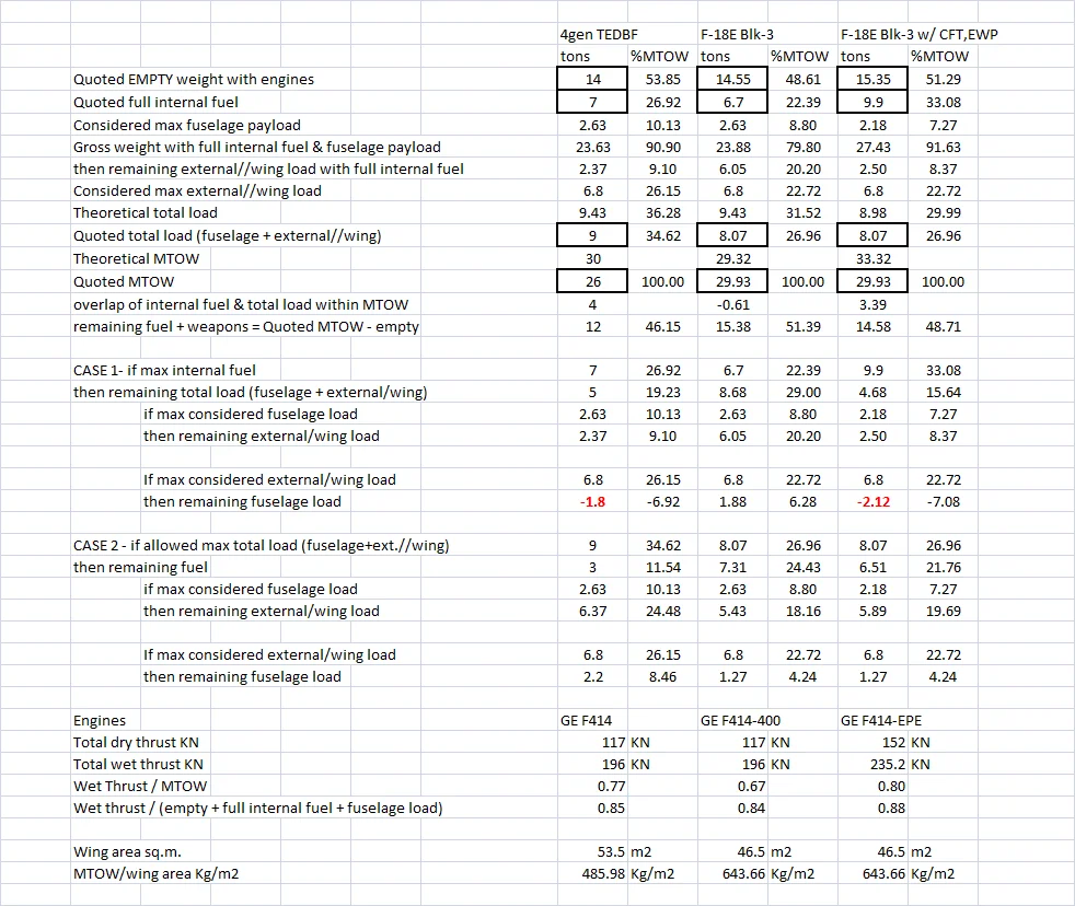

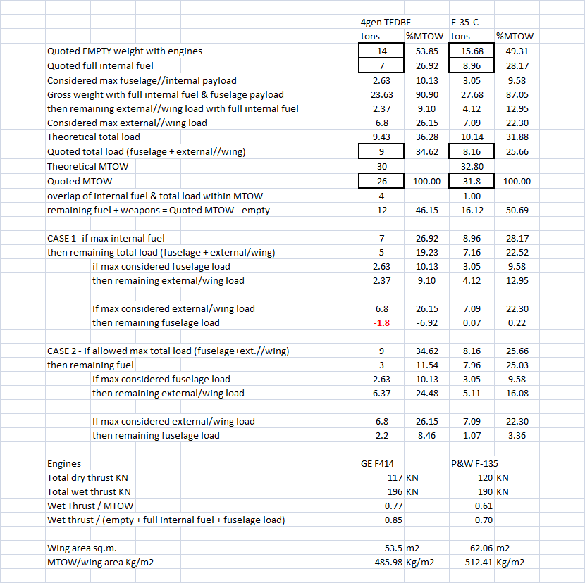

> Looking at numerical data -
- Total thrusts values look nearby,​
- but empty, gross, max weights, IWB load, fuel of TEDBF less than F-35's, perhaps bcoz CATOBAR has the catapult assist not on STOBAR,​
- hence the ATWR (A/c Thrust to Weight Ratio) of TEDBF is also more.​
- Wing area of F-35-C is more, but its weights increase in bigger ratio, so wing loading is more.​
More observations can be made.
> Take-off, gross weight, MTOW -
- Gross weight could be standard CAP config with certain fuel amount & minimum weapons. For my calculations i consider it as empty weight + full internal fuel + max fuselage load, analogous to a stealth jet.​
- In peace time light AA, AG, mixed loads are taken, just enough for CAP, to deter aggressors. MTOW is a war time capability which pushes A/c structural limits.​
- Common pattern in all fighter jets is observed that MTOW is roughly around or +/- of 2x empty weight.​
- MiG-29-K empty weight is 12 tons, quoted MTOW is 24.5 tons. With 2x RD-33MK engine's 88.3 KN thrust, wet T/MTOW = 0.74​
- Su-33 empty weight 18.4 tons, quoted MTOW 33 tons, < 2x empty weight. With 2x Al-31F3 engine's 125.5 KN thrust, wet T/MTOW = 0.78​
- F-35-C empty weight 15.68 tons, quoted MTOW 31.8 tons. With 1x F135 engine's 190 KN thrust, wet T/MTOW = 0.61​
- F-18-E empty weight 14.55 tons, quoted MTOW 29.93 tons, >2x empty weight. With 2x F414 engine's 117 KN thrust, wet T/MTOW = 0.67​
- TEDBF empty weight 14 tons, quoted MTOW 26 tons, <2x empty weight, due to STOBAR perhaps. With 2x 414 engine's 117 KN thrust, wet T/MTOW = 0.77​
- If aerial refuelling is available then T/o can be done with lesser fuel & more weapons.​
- Rear/longer T/o position is suitable for heavier load configs.​

= If TEDBF CLW is also taken to be like F-18E then it is 16.5-19 tons.​
- All naval jets have "Carrier Bring Back Payload" CBBP (fuel + weapons), calculated as CLW - empty weight.​
= It has been observed to be in range of 13-30% of MTOW.​
= If heavier beyond CLW, the weapons, especially smart ones are expensive to be jetissoned, so some fuel is dumped.​
> Pattern noticed is that -
- While CATOBAR jets with catapult assist have ATWR range in 0.6X, or relatively more weight, less thrust.​
- STOBAR jets need more ATWR in range of 0.7X, or more thrust, less weight.​
- To tweak TEDBF into 5+G design this ATWR range & CLW range will have to be maintained.​

So far we compared diagrams of TEDBF with AMCA, F-18 SH, F-35-C, matching pixels with dimensions.
Here is an attempt to look at Notional 5gen TEDBF, as close as possible to the 4gen delta-canard TEDBF.
I made this edit last year itself & on day of posting the F-47 was announced.
- pulled up the intakes,
- re-shaped the fuselage to make it less humpy bumpy like Humpty Dumpty, 🥚🐳🐼
- gave it shorter all-moving twin V-tail.
- add IRST on nose & EOTS on chin.
- add side shared multi-function RF-array & DAS on cheeks
- fuselage will be at least 2.2m wide like in AMCA, to carry AGMs & 6x AAMs.
I wonder if close-coupled canards need to be at higher level than wings like in Rafale or can be at same level.

When LM designed the F-35C was it really a new design or was it based on F-35A? If it was a heavily modified F-35A, could ADA not do the same with AMCA to produce a navalised AMCA? With 50 Rafale-M expected to come I wonder at the need for another 4G carrier fighter in the form of TEDBF.

It probably serves to know that IN always wanted a next-gen (read: 5th gen) naval fighter. The only reason they reluctantly 'agreed' for the current 4.5/4++ gen TEDBF was because they were promised a hasty timeline of realization (which became a necessity due to unforeseen operational problems with MiG-29K):
But now this timeline has been pushed back by 10 years. TEDBF was supposed to be ready before AMCA. It was supposed to be Tejas Mk2 >> TEDBF >> AMCA. But now it's become Tejas Mk2 >> AMCA >> TEDBF. They now expect TEDBF to enter service only by 2038.
In the meantime, the Navy got approval to pursue 26 Rafale-Ms to fill the immediate need for Vikrant. I'm also hearing persistent rumours that Navy is planning on buying another 31 Rafale-Ms (taking the total to the originally planned 57).
So a lot of the compulsions that forced IN to agree to the ADA proposal for a 4++ gen interim TEDBF are now gone.
We've entered a totally new environment. So IN now has the freedom to pursue TEDBF like how they originally wanted it to be: a 5th gen fighter. And that's what they've indicated they're gonna do now...
In short, the TEDBF design we've been seeing for last few years is most likely to be junked. And there's nothing to say whatever '5th gen' design to be pursued would be a 'stealthified' version of the current canard-delta TEDBF. It will most likely be a totally different airframe, much closer to AMCA.
F-35A, B & C were all part of the initial plan. The carrier version was not an afterthought of the air force variant.
Same for Rafale.
That appears to be the plan:
Perhaps designing a carrier fighter is beyond the capability of ADA. I recall that the Tejas naval fighter design was reported to be a whopping half a ton above its intended weight.
From all JSF documentaries, articles, it look like initially the parts commonality was supposed to be more than 50%, mostly in fuselage. But in reality it dropped below 50% i guess.
Anyways, to the eyes of citizens on the outside they look almost same except the bigger wings of C model, lift-fan of B model, etc.

Technically AMCA can be modified, like F-35-C, J-35. People can call it modification or clean-sheet, doesn't matter. A flying jet matters.

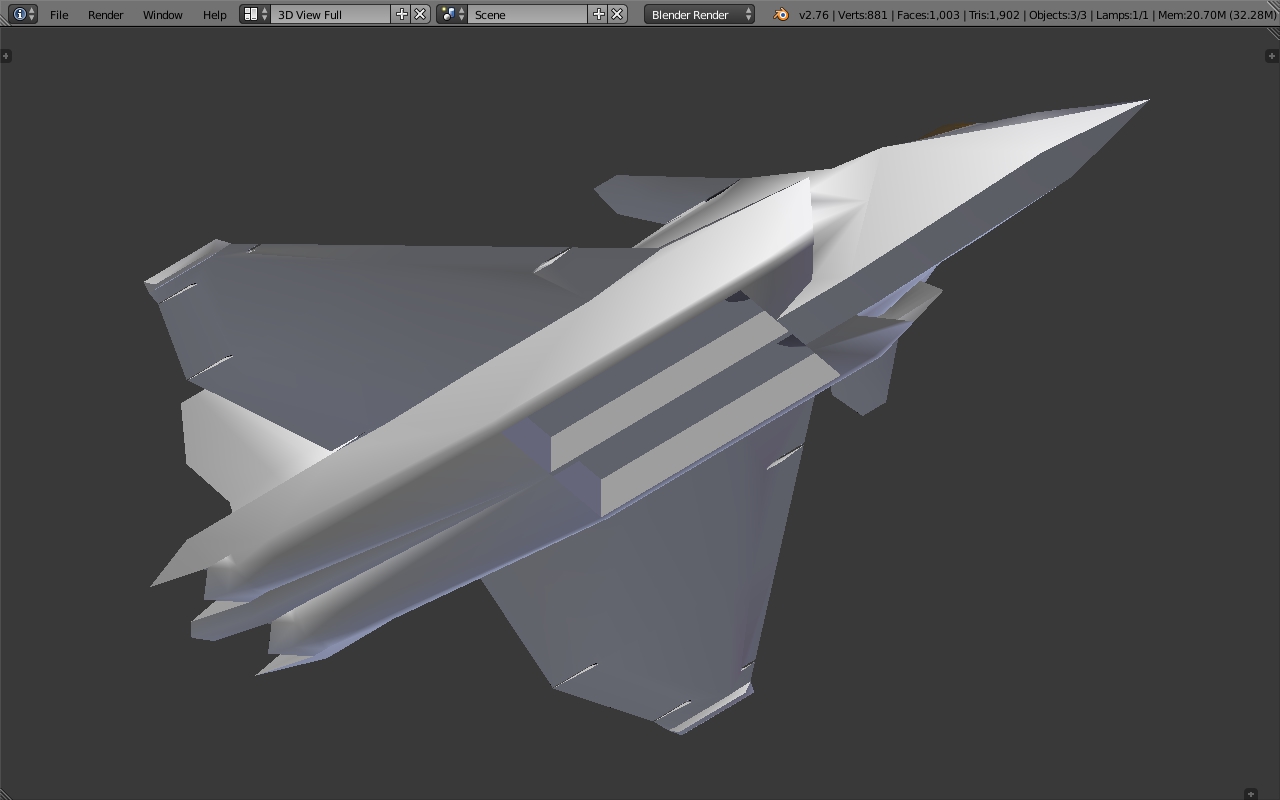

CAD work in progress of 1st iteration of notional 5+G TEDBF, Delta-Canard, V-tail, IWB for AGMs. Alternate of Naval AMCA.👀😳😲
5gen TEDBF, 1st iteration, 7 Sep'26,  Object mode, Solid view, right front low angle.jpg
5gen TEDBF, 1st iteration, 7 Sep'26, Object mode, Solid view, top right front angle.jpg

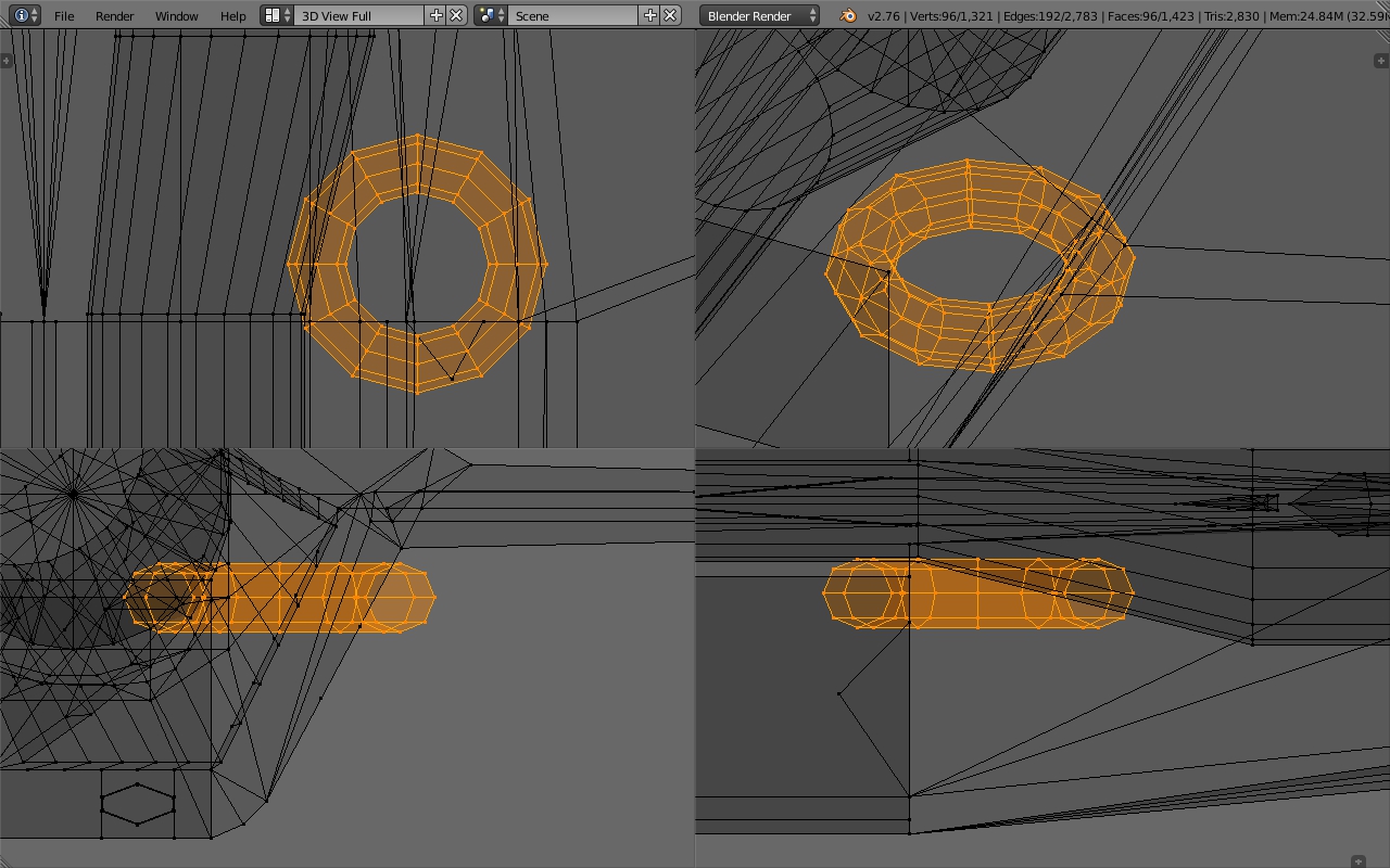

2D edits're not enough to imagine everything. 3d helps in rectification. I was going to just cut MLG bay door & color it separately. But rear tyre retraction, rest position affects fuselage shape. It shouldn't -
- touch the air duct
- overlap with IWB much
- peek out of fuselage much
I'm considering a lateral folded retraction like in F-18 SH, F-22 & not unfolded forward/rear retraction, keeping it just behind IWB with small overlap in top corner. The peek-out of fuselage has to be covered aerodynamically like in most 5gen jets. This'll give space for SWB also.
As per search, rear tyre diameters of F-18 is 30"/76.2cm, F-35-C is 34"/86.4cm, F-22 is 37"/94cm.
For now i'm considering 5gen TEDBF's rear tyre diameter to be 90cm.
5gen TEDBF, 1st iteration, 13 Sep'26, Edit mode, Wireframe view, rear tyre selected, quad view.jpg
5gen TEDBF, 1st iteration, 13 Sep'26, Edit mode, Solid view, rear tyre selected, quad view.jpg

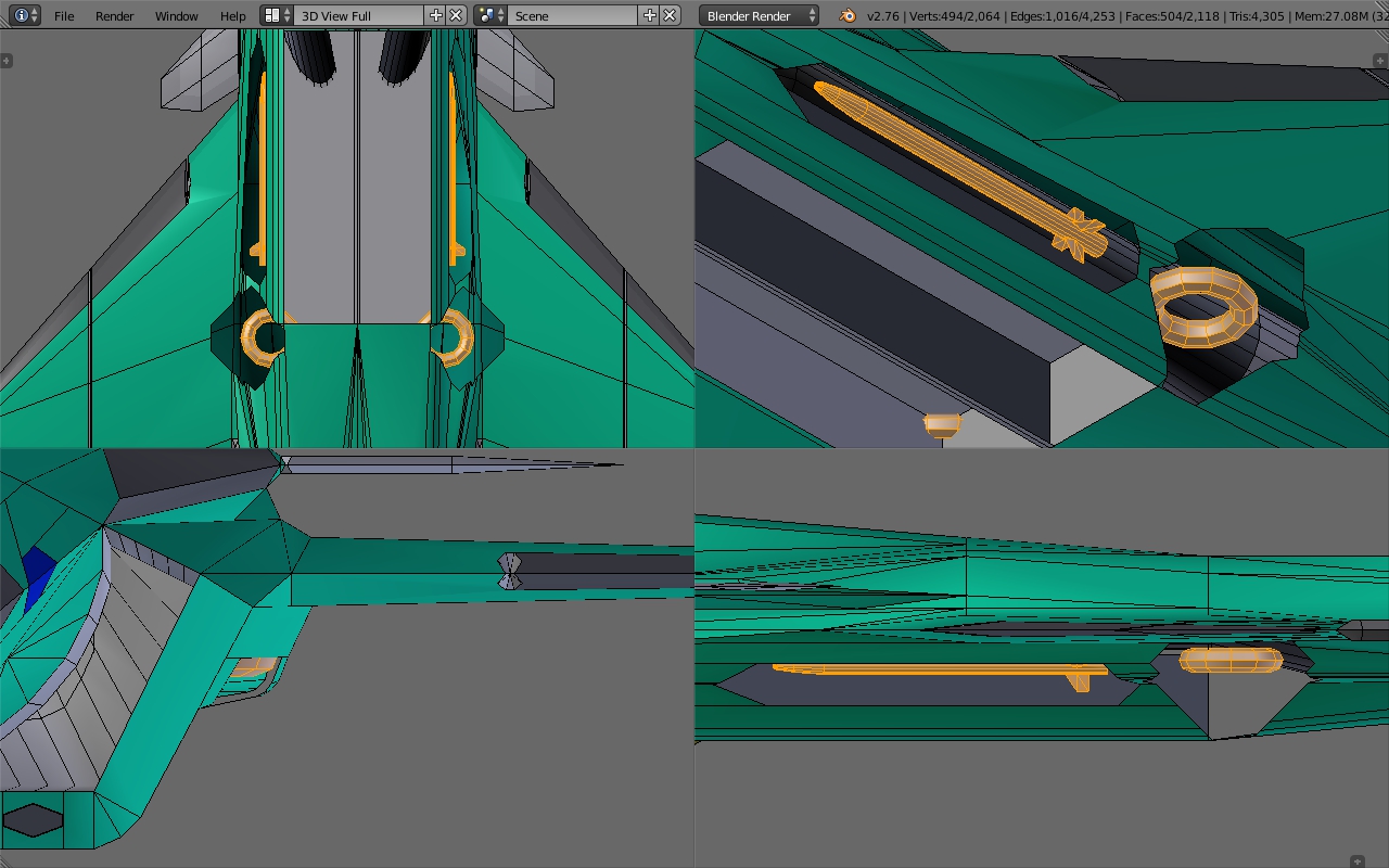

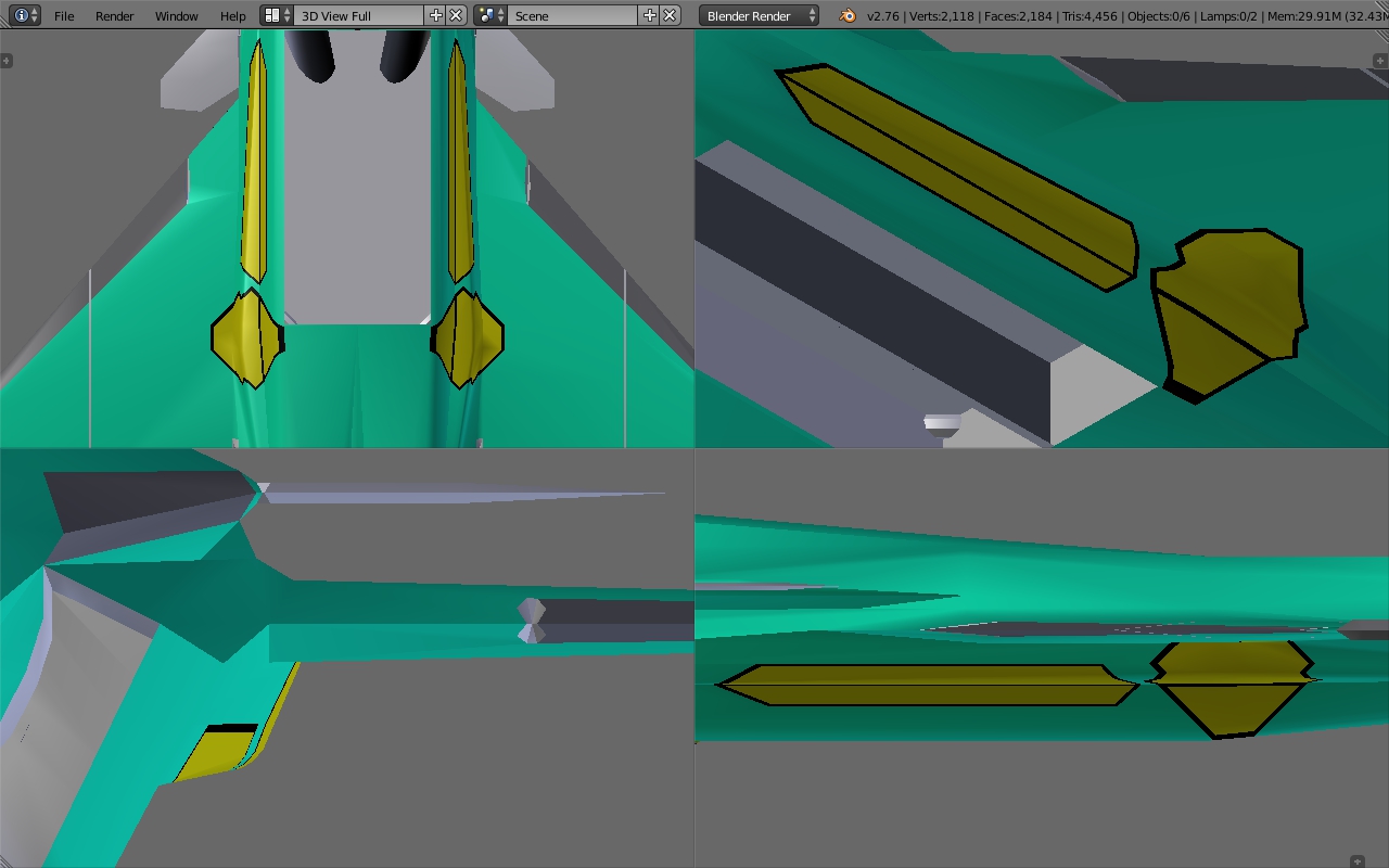

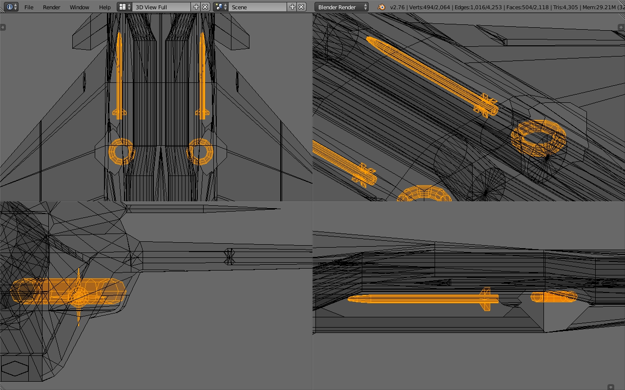

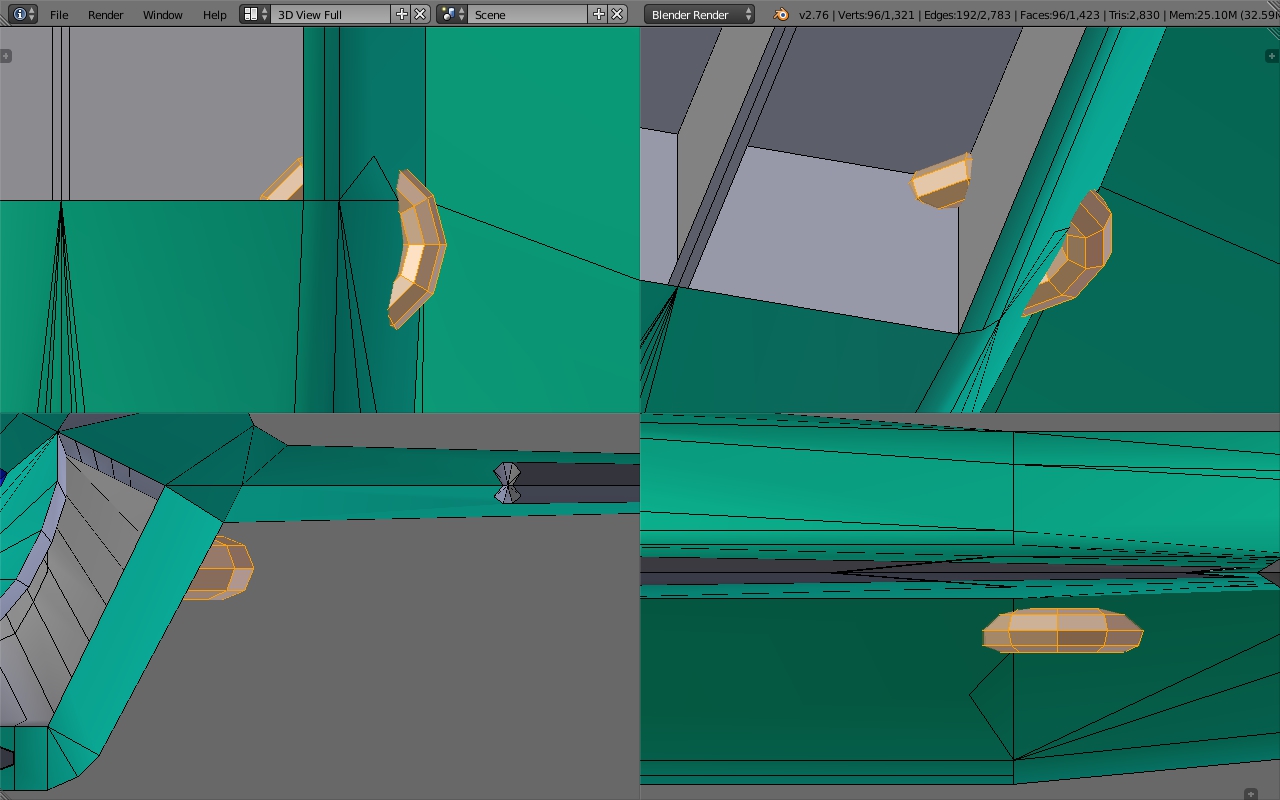

5+gen TEDBF can have SWB. Even if IWB is considered cuboid for AGMs, there is sufficient volume for CCM.
The lateral retraction of MLG would enable this easily, otherwise more modification of fuselage needed.

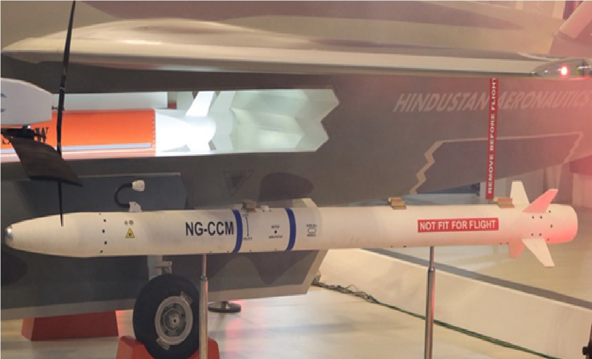

DRDO's NG-CCM is like AIM-132 ASRAAM which India also imports.
So here is the depiction of the CCM, SWB door.
5gen TEDBF, 1st iteration, 18 Sep'26,Edit mode, Wireframe view, MLG door & SWB door hidden, CC...jpg
5gen TEDBF, 1st iteration, 18 Sep'26, Edit mode, Solid view, MLG door & SWB door hidden, CCM &...jpg
5gen TEDBF, 1st iteration, 18 Sep'26, Object mode, Solid view, MLG door & SWB door, quad view.jpg
