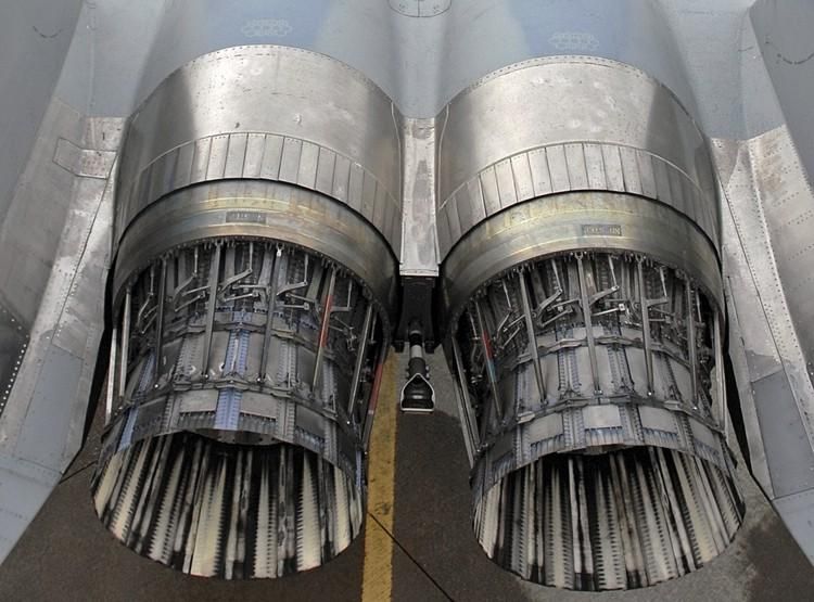

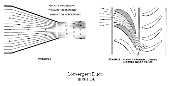

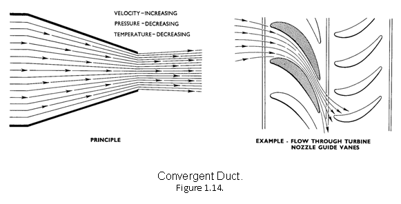

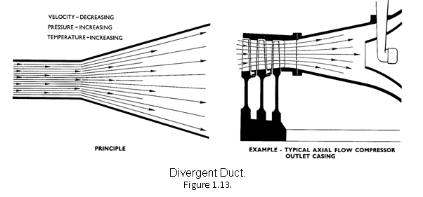

Convergent and divergent ducts change movement of airflow and is achieved by moving the nozzle. These are 2 F110 engines of a F15. by moving the nozzles you can converge and diverge airflow.
DIVERGENT DUCT
CONVERGENT DUCT
PS if you can make this. Yes TVC also is a possibility. But it introduces other problems in design to tackle.

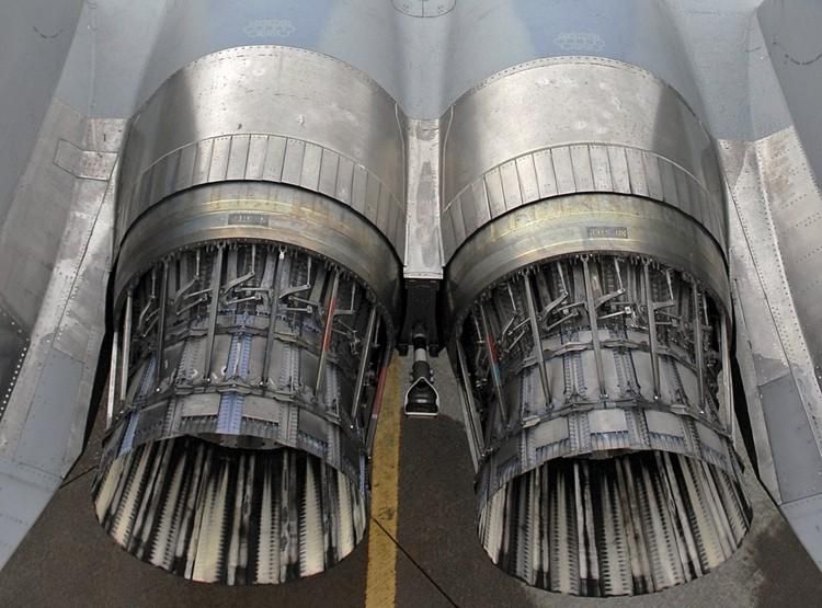

DIVERGENT DUCT
CONVERGENT DUCT
And yes, I was talking about this but the problem is we don't know which version of TF-X going to have TVC.
With F110 they do have some possibilities but dunno if US allows it
