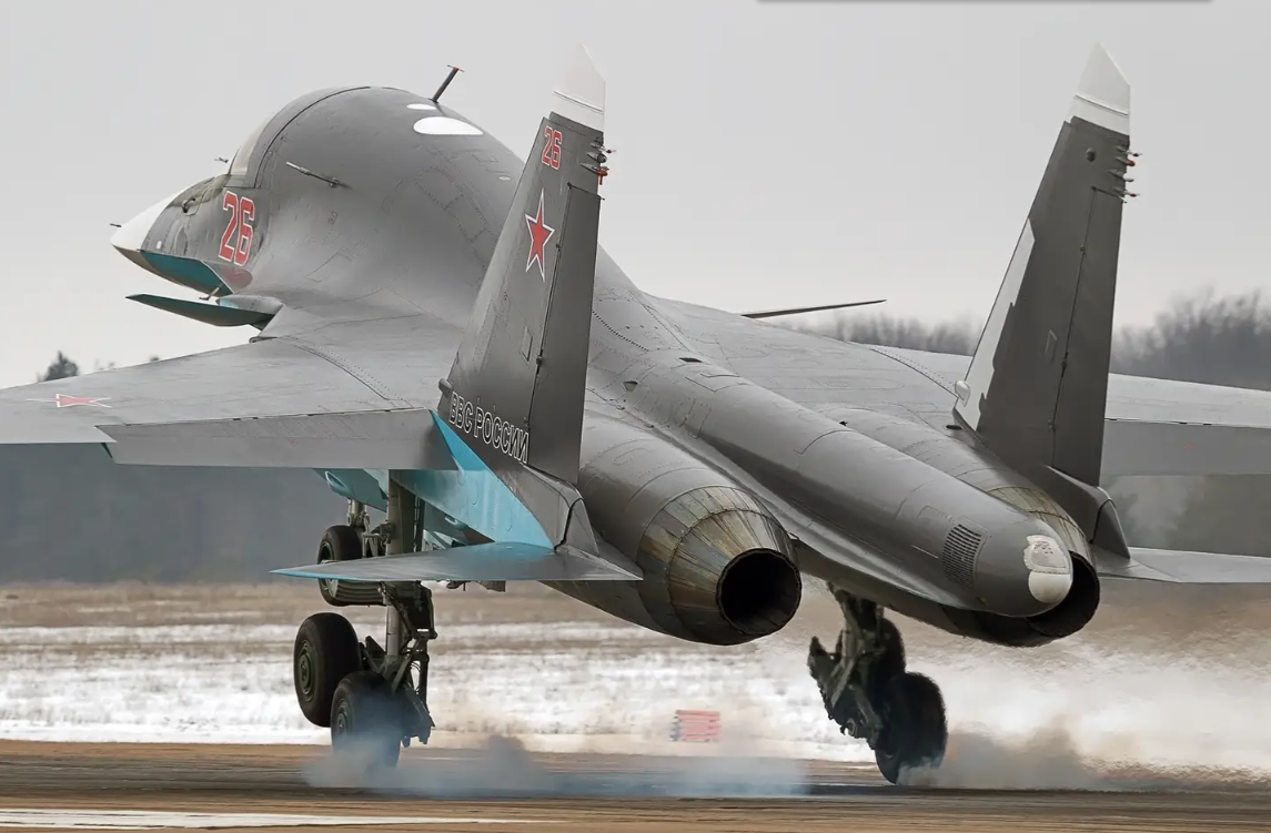

Yes, I realize that now. Thank you very much. The angle of the photo may be misleading, but it really stretches like a MAD boom. It is not a simple drag-chute part, which Merzifonlu üstat drew attention to the details. The reason for my Su-34 analogy is that the geometry of this part is not as wide as the SU-57, and I must say again that it may be the angle of the photo that makes me think so. In any case, we know that this approach is something that Russian aviation has been working on in one form or another for almost 30 years.
