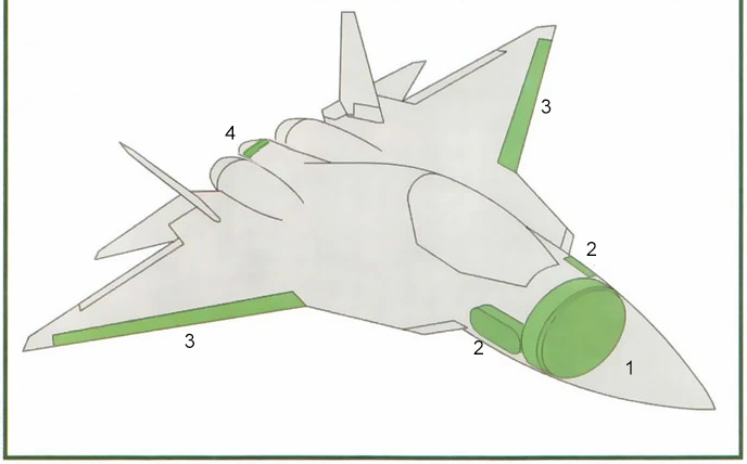

I'm hoping TFX will have this sort of configuration for R/F antennas
1. Main Nose AESA Radar
2. Flank Array AESA radars
3. Wing Root Passive Radar / Radar Warning Receivers
4. Aft Passive Radar / Radar Warning Receivers
What you guys think ?
i think it is the likely configuration.
I remember that Temel Kotil said it will have radar coverage for 360 degree, only question i had was the behind of the jet, but with new assembly video and look like su57, it confirms that thats the real plan
