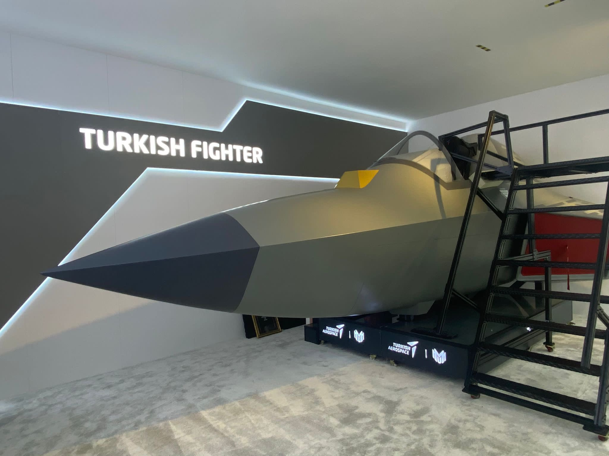

TUSAS presented a TFX cockpit mock-up at Faranborough Airshow that looked similar to the current prototype.

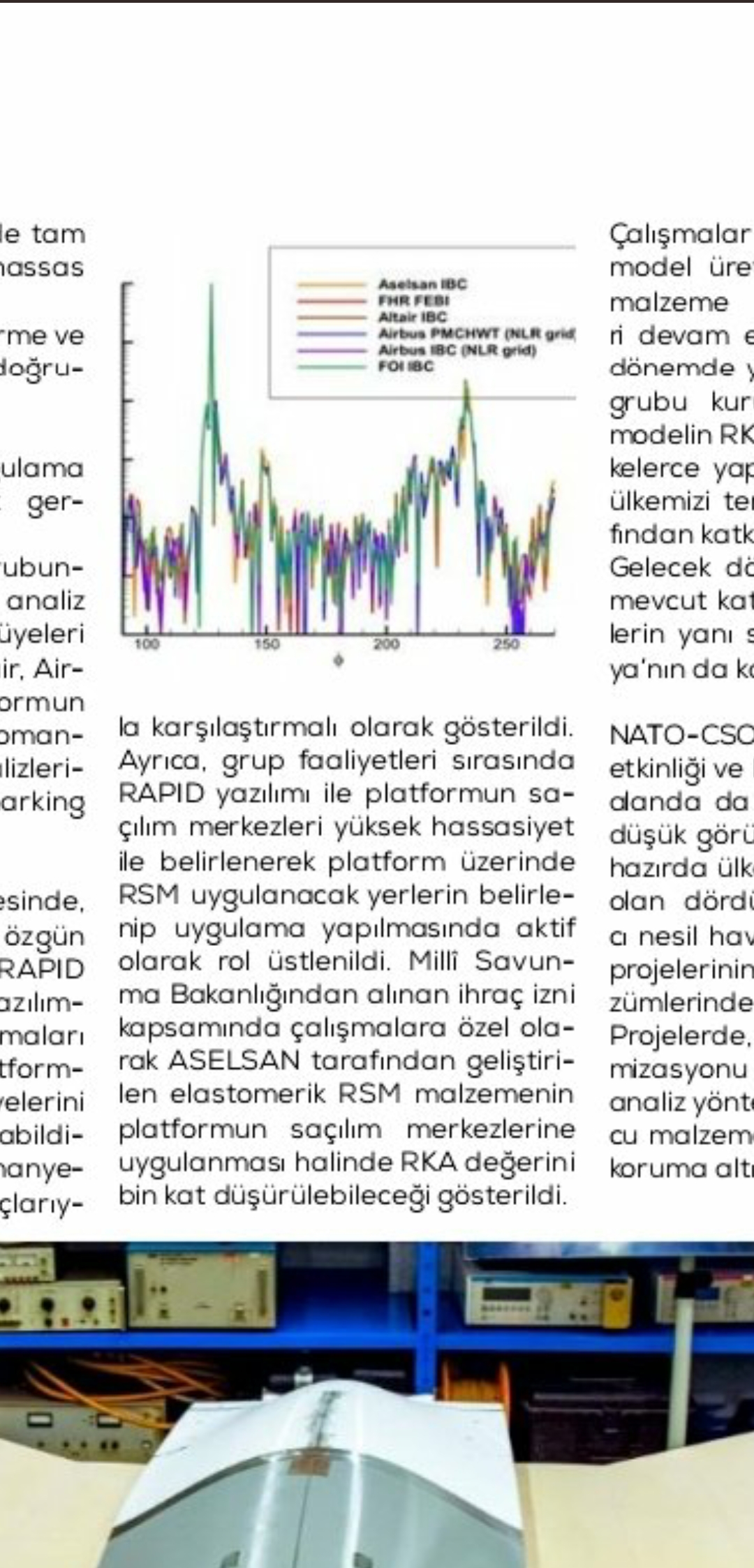

In the latest ASELSAN magazine, there is a small but good info about RAM's
When applied to hotspots, it can decrease the RCS by around 1000 times, (-30dBsm)
This is a really good amount, i hope it is also easy to maintain and resistant to weather (eg F-35 RAM)

Shall we try to guesstimate TFXs RCS from that?
Probably we cannot, we need someone that can model TF-X with all the details and run EMW simulation in Ansys.
But -30dBsm means if we apply this to a flat surface that has 1m² RCS for a given direction, it would have 0.001m² with ASELSAN's RAM applied over it.
Of course effectiveness depends on RADAR wavelength/frequency but i am assuming all of these are for X band
